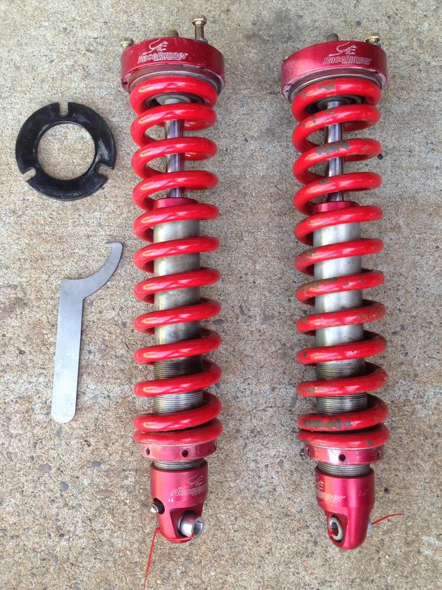

Was browsing craigslist today and came across some Sway-a-way 2.0's. I was able to pick them up. Here they are.
