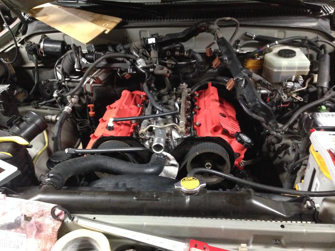

Dude!! I know. My motor looks like spaghetti. :crybaby::yield:
More parts on the ground than in the engine bay...well, almost. Lol

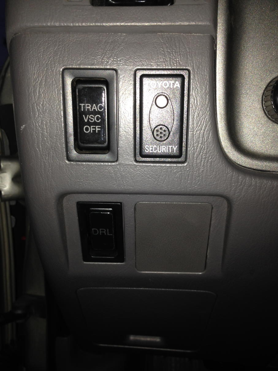

where you got the drl switch and trac switch from?
I bought the RR Diff Lock switches, pulled them apart, pulled the face off, made my own label in PS then printed it and clear coated it onto the face of the switch. Long process, but I like how it turned out so wasn't a big deal.

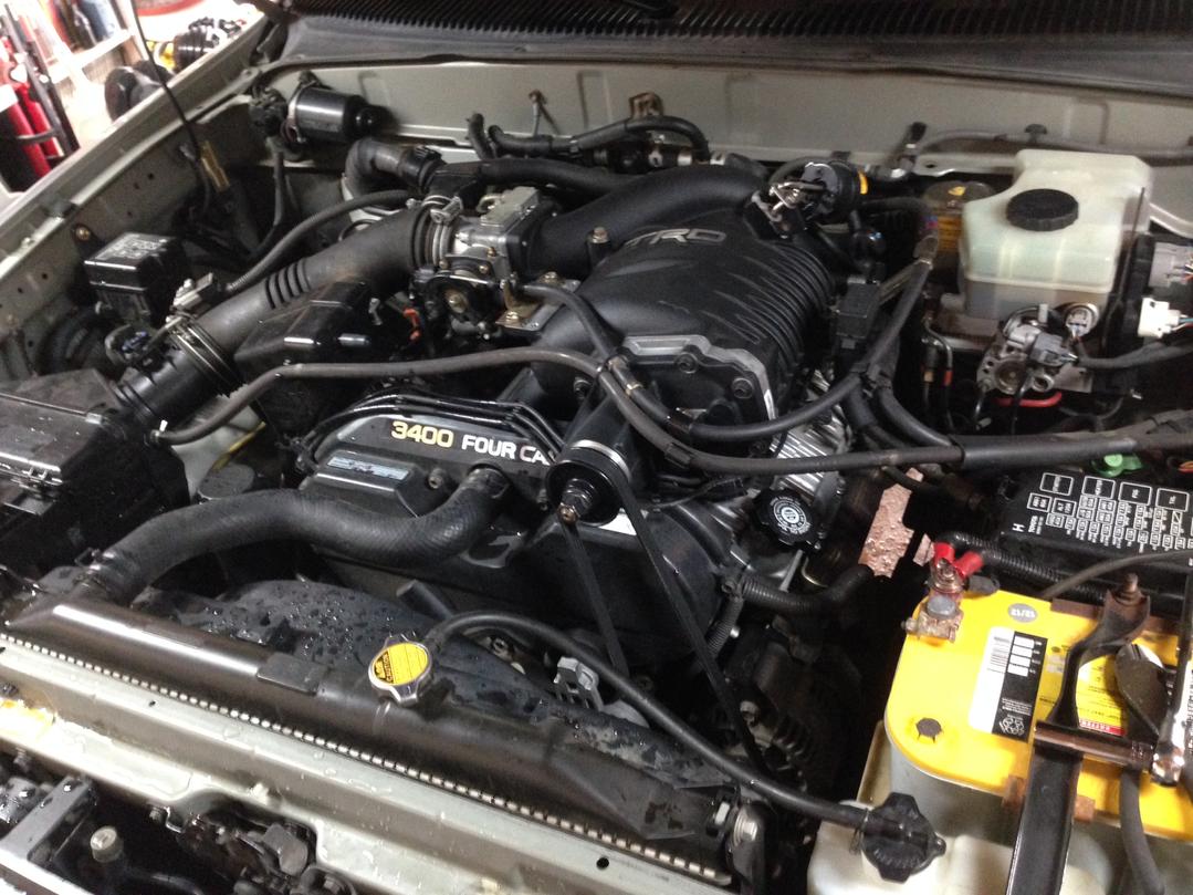

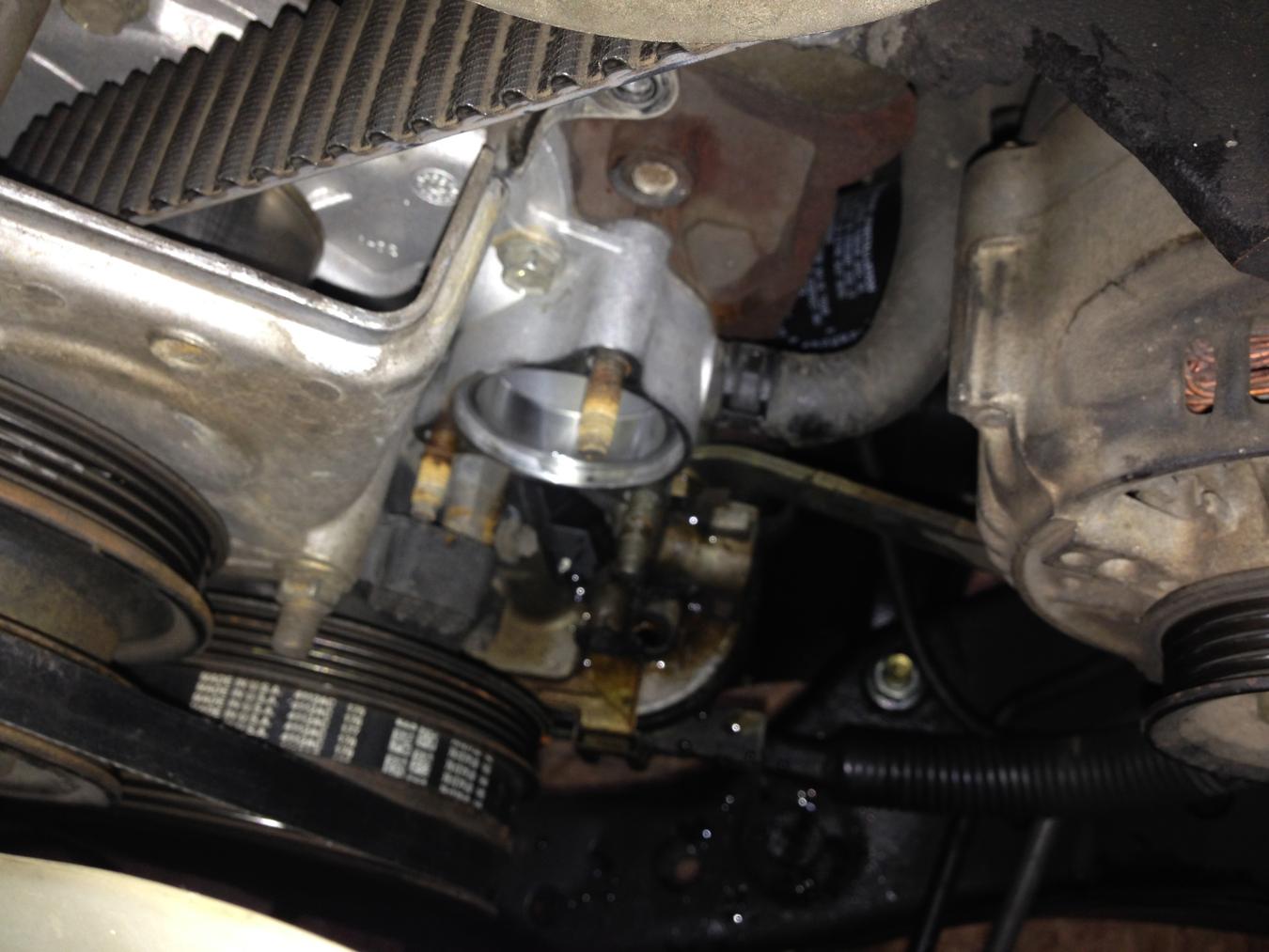

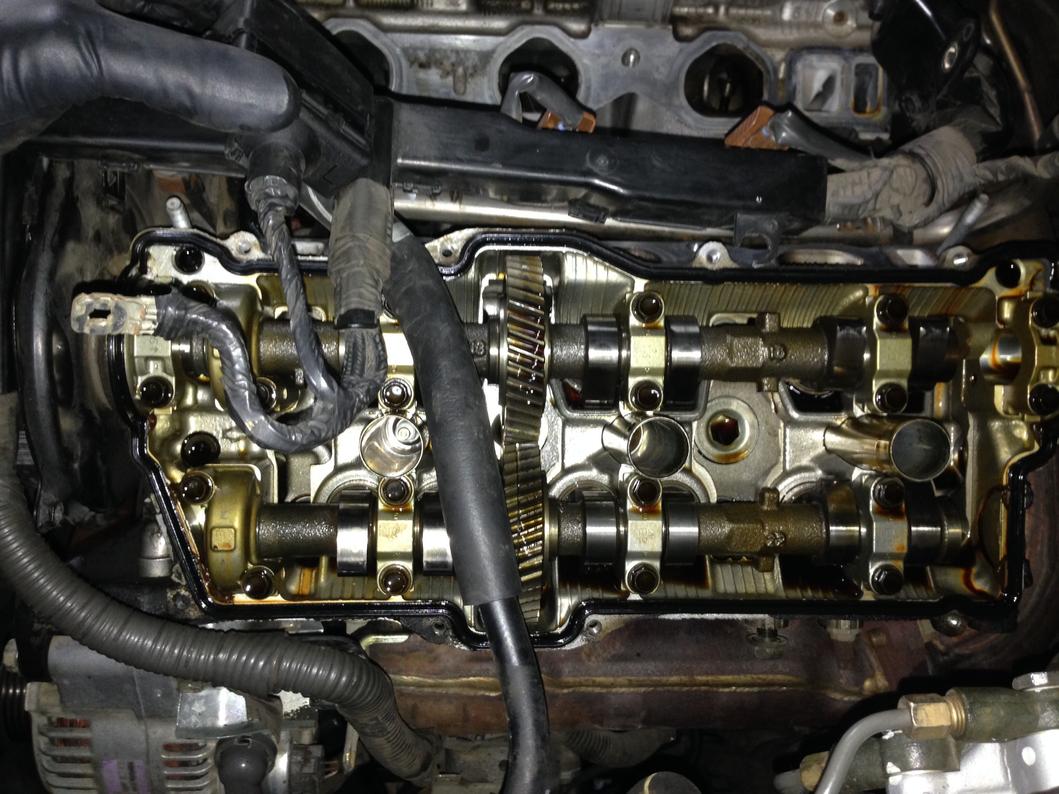

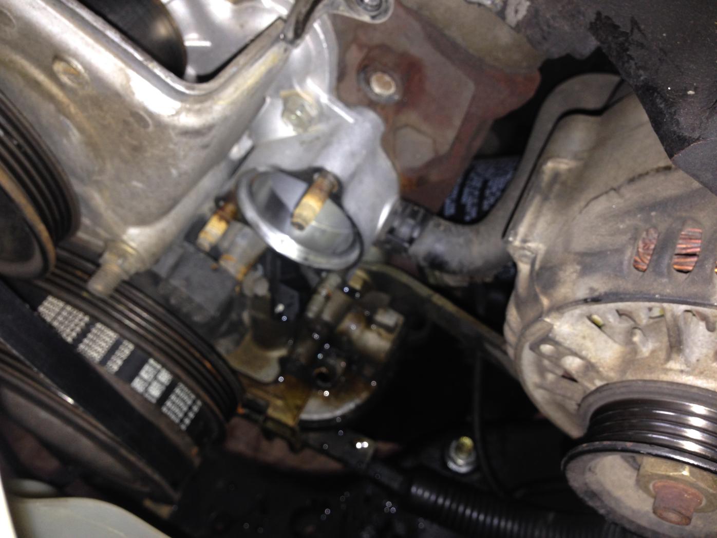

Well, I'm finally getting around to putting up the pics of my maintanance this past week. Pic heavy so here it goes.
Heres my starting point
Not horrible, until you start to look up close

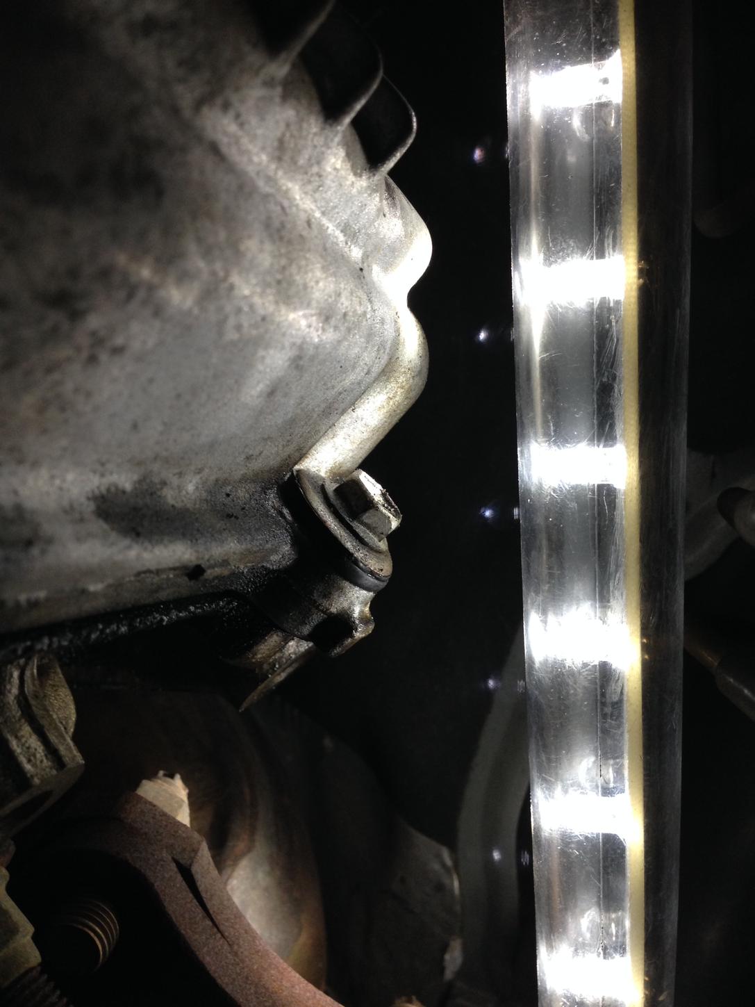

Oil weeping on all the edges
Drivers rear was the worst

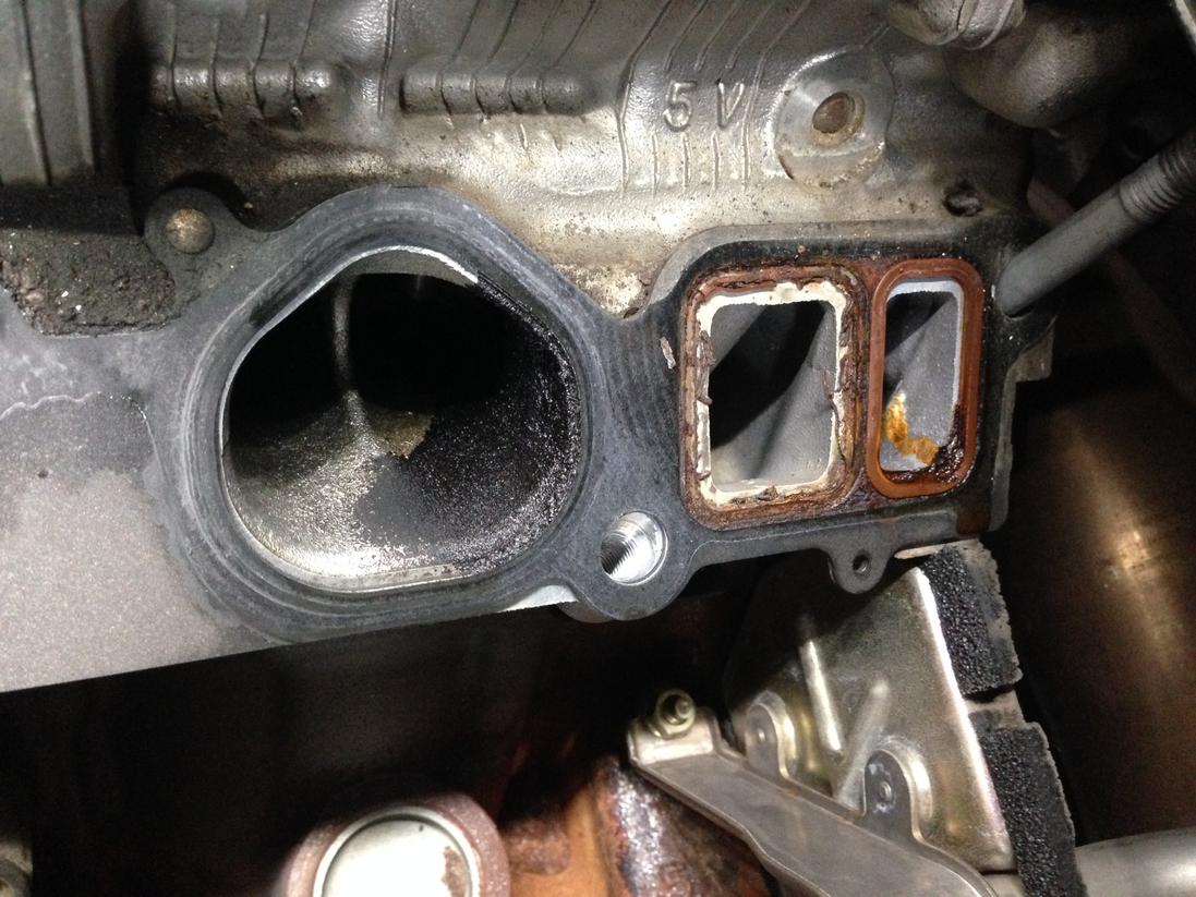

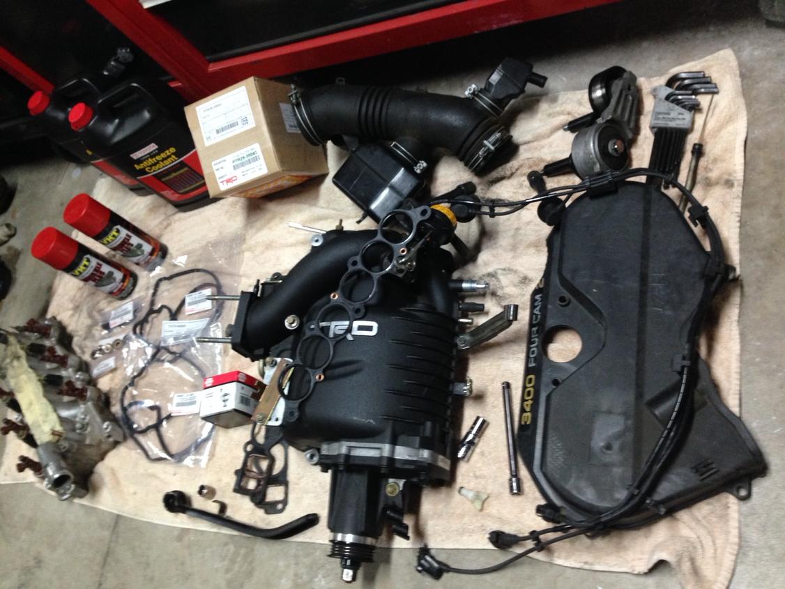

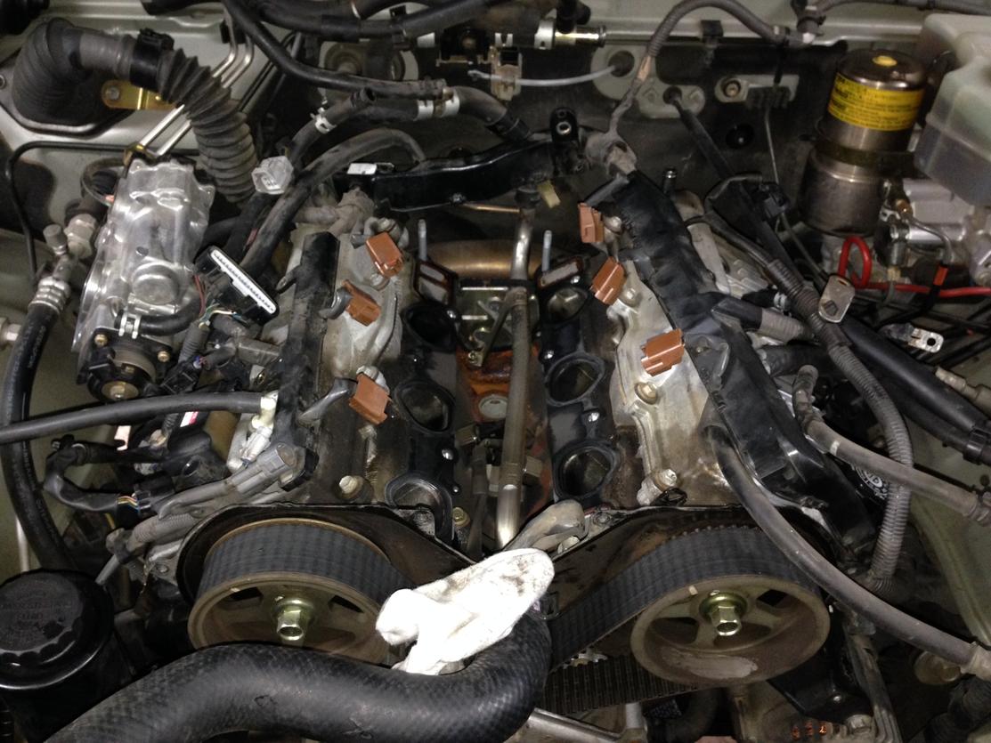

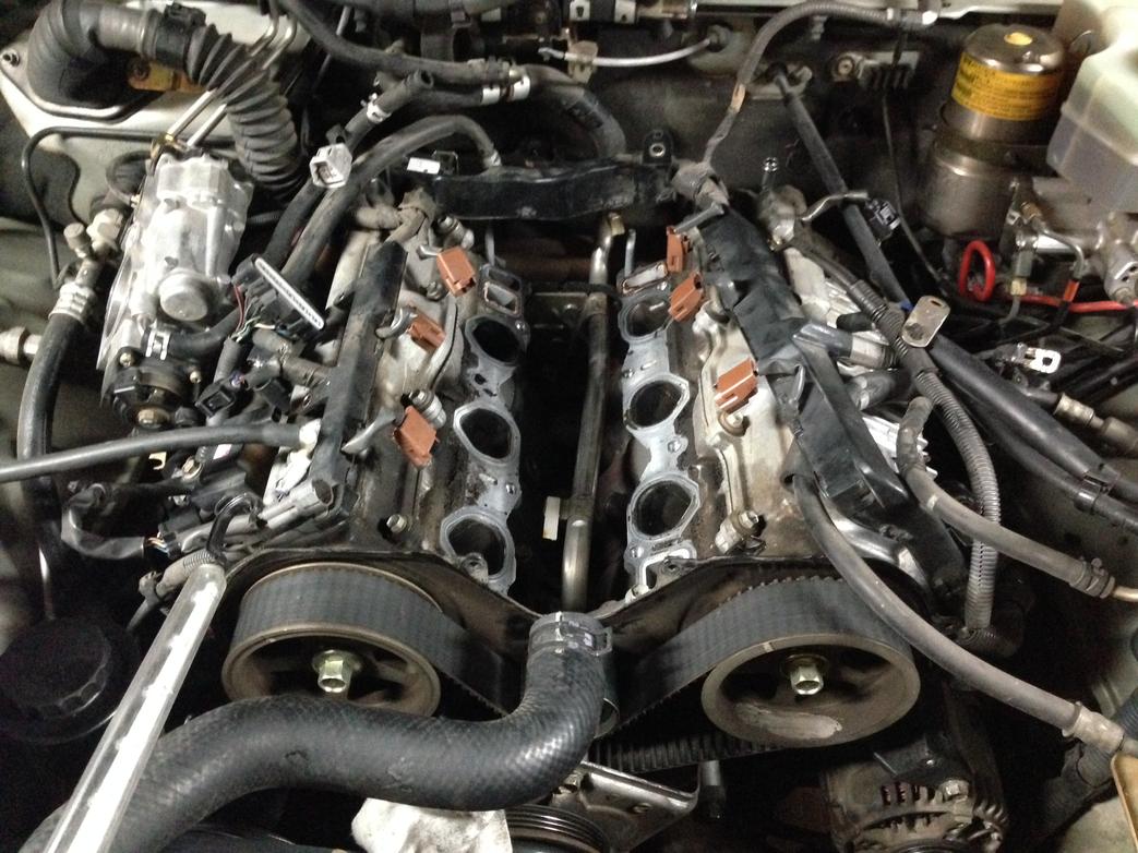

Then I pulled off the intake manifold…

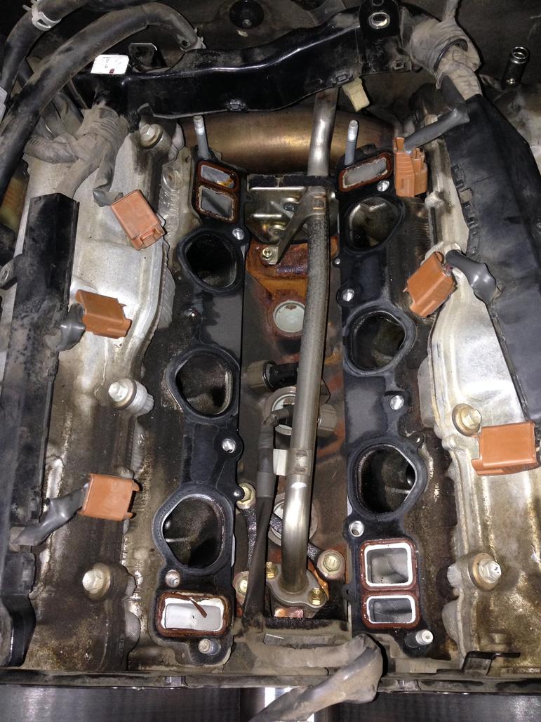

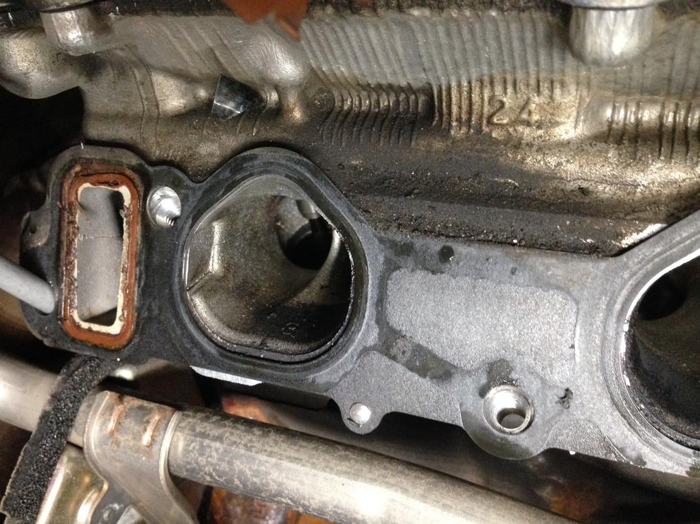

Apparently my intake manifold gasket has seen better days. Both rear water seals had a slight leak into the valley and the gasket begun to deteriorate and melt into the water port

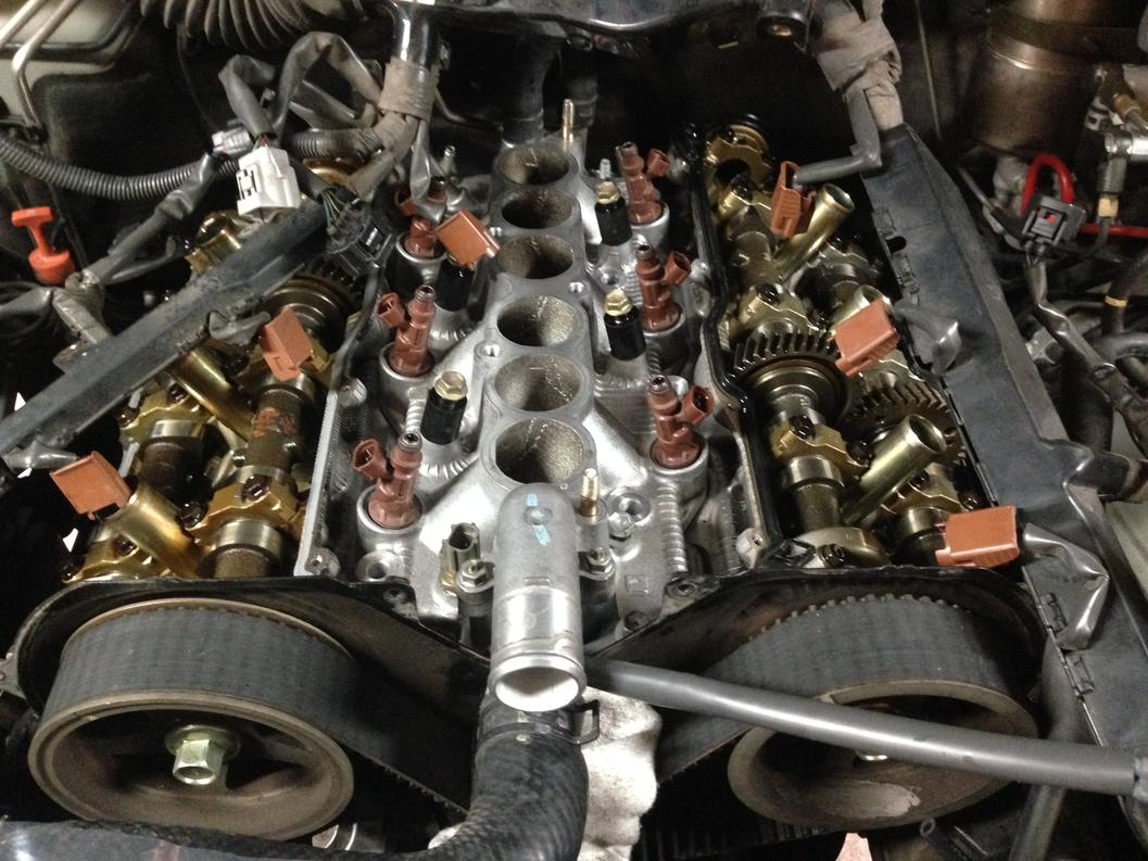

Drivers side

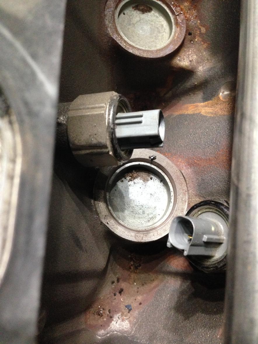

And theres those pesky knock sensors

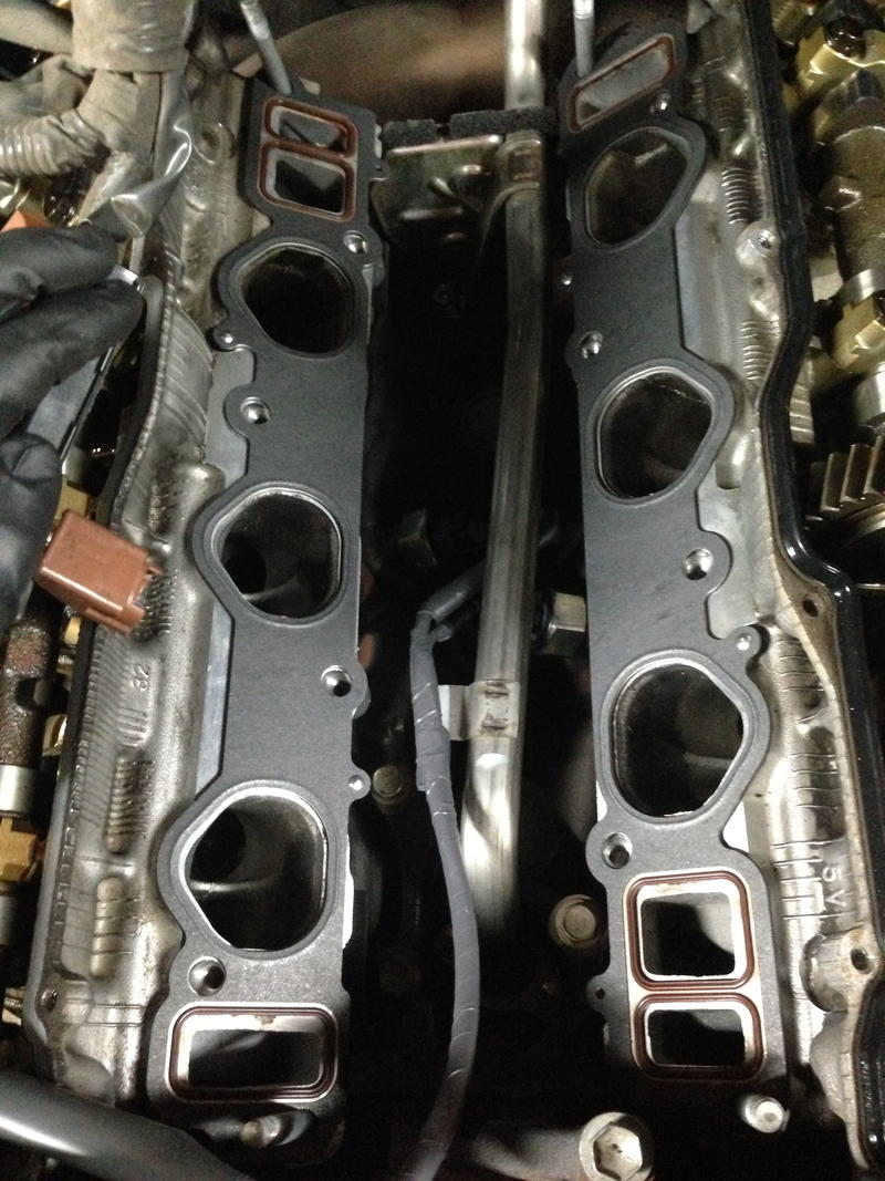

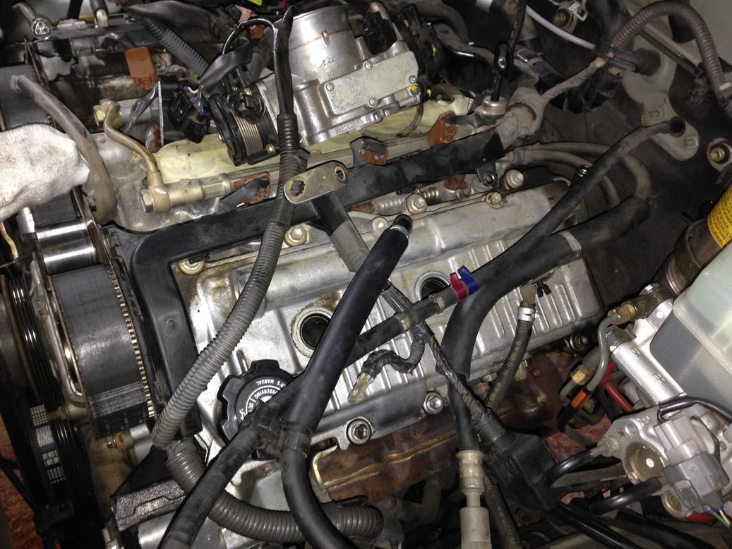

As you can see, my PCV valve gasket has also been spewing oil everywhere
The parts just keep piling up on the ground…

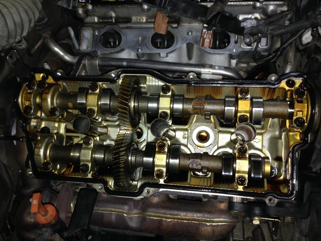

Passenger side with no sludge
Drivers side with no sludge also, I was really happy to see it
Did the thermostat while I had everything torn down

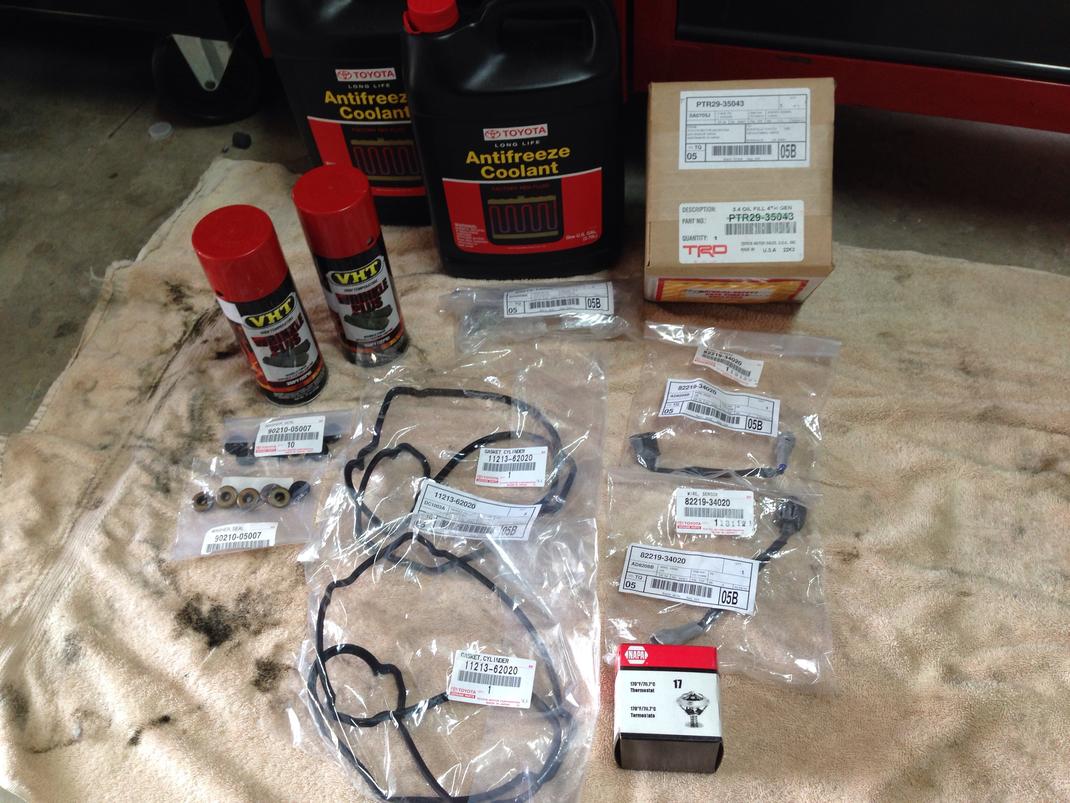

New intake manifold gaskets, night and day difference between the old and new
Reassembly

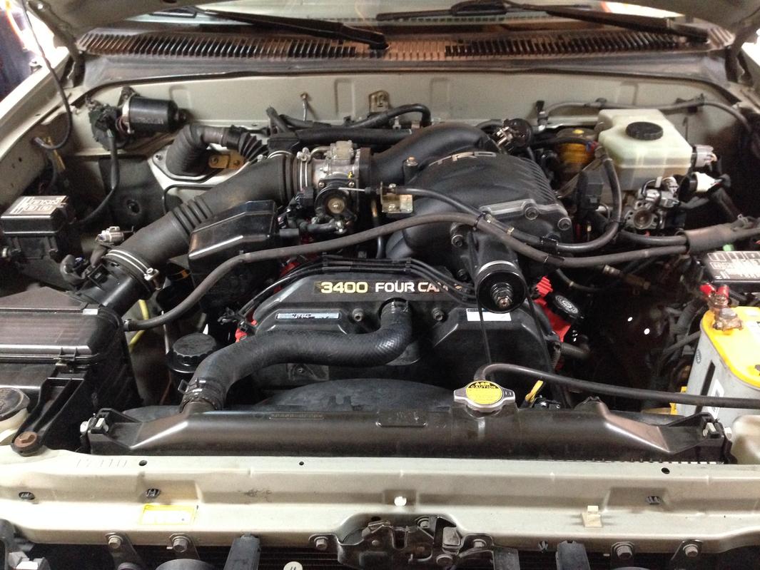

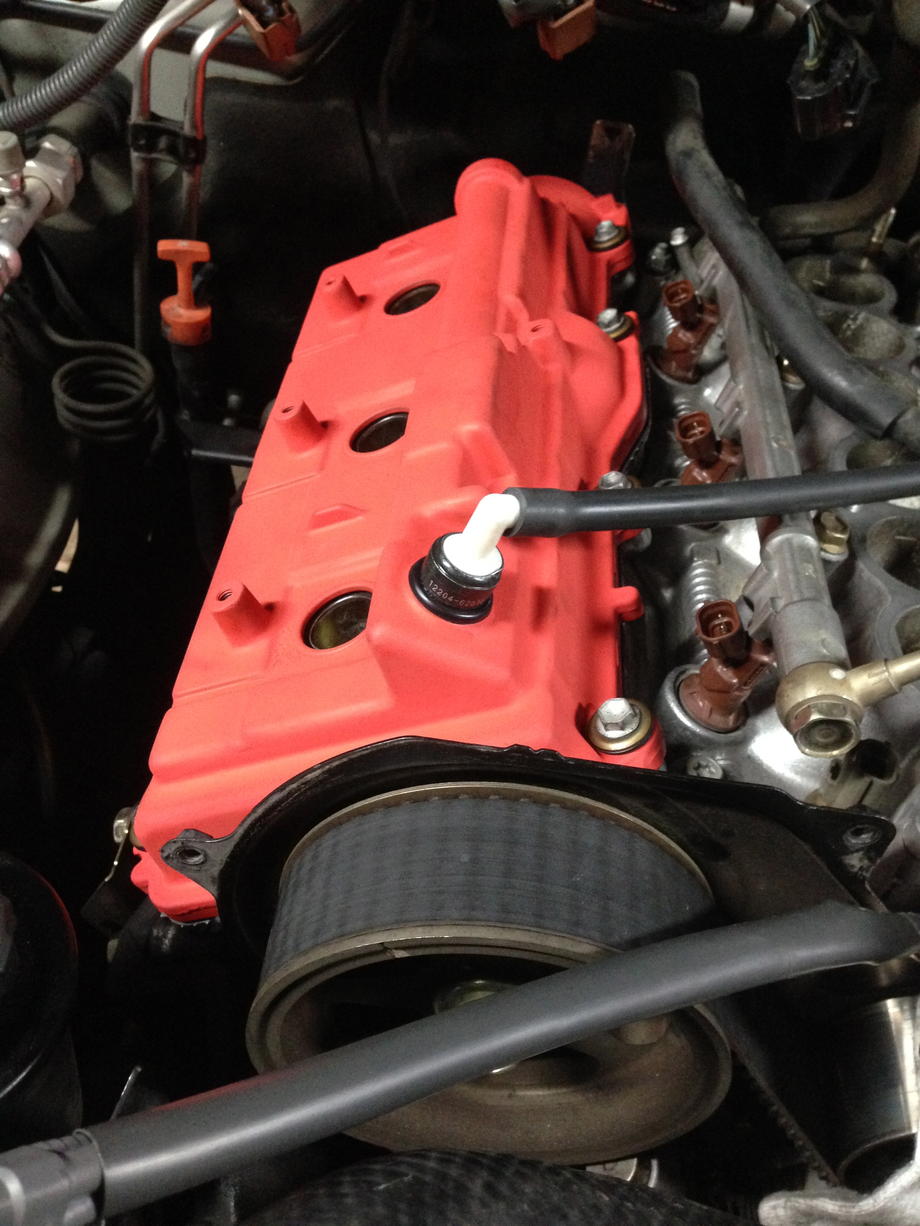

Almost there
New PCV valve and gasket, also new spark plug gaskets
Annnnnd DONE!

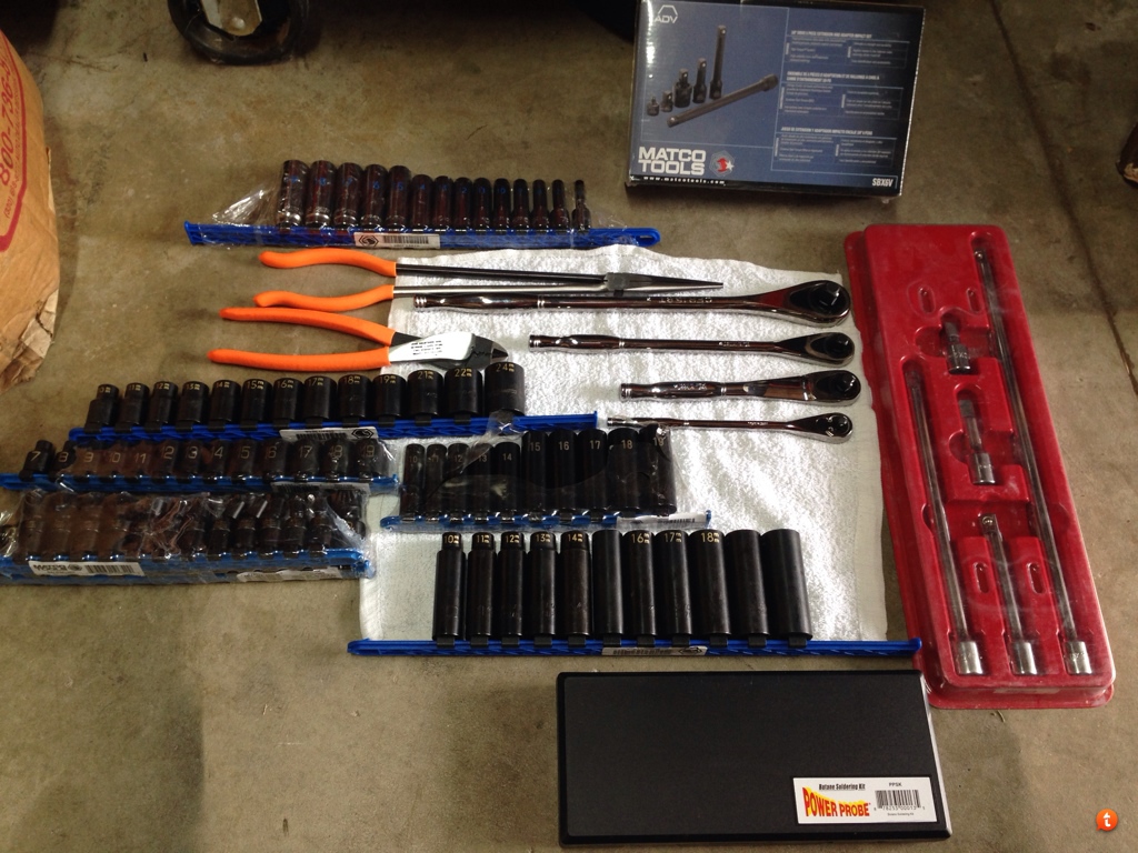

So I'm in the garage and just about to start pulling the supercharger for the...I don't know, 4th time when my local Matco buddy pulls in front of the house and says he's clearing out his inventory and selling his route. :jaw drop: So I'm over here saving money, working on my car and then this happens. :ybrick: I'm never going to get my lift kit at this rate. lol Goodby Craftsman, HELLO more Matco pieces.

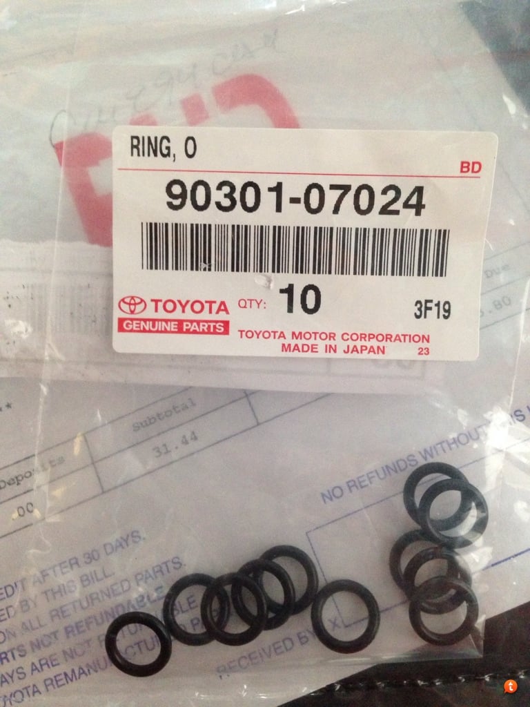

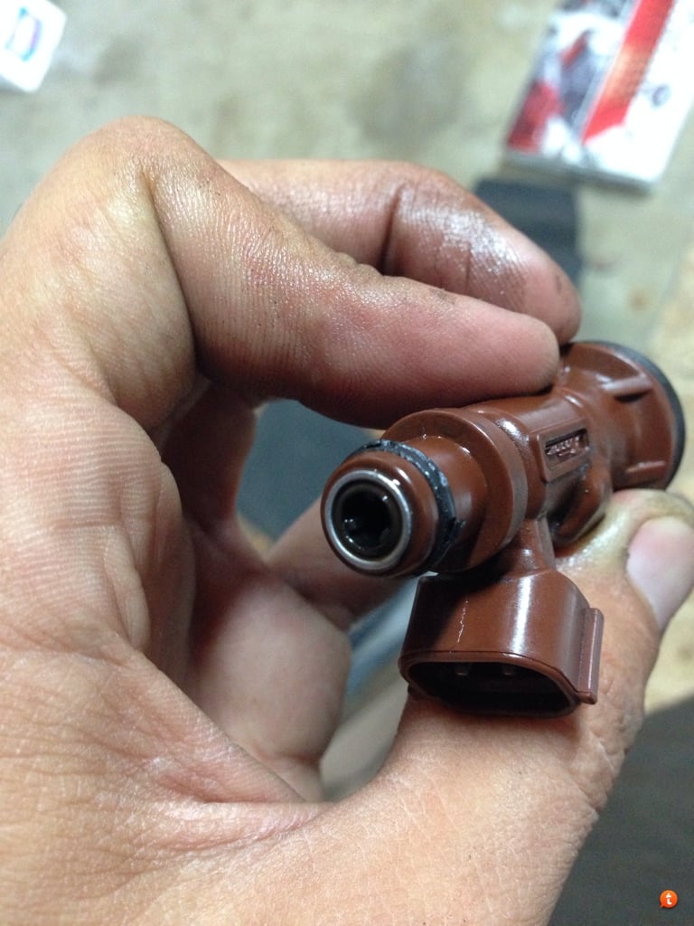

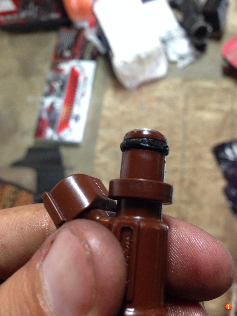

Also, I found the gas leak I was having after doing the knock sensors and intake manifold gasket. The passenger rear injector had a torn upper o-ring seal. Went ahead and replaced all of them, just in case.
