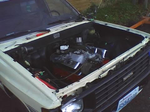

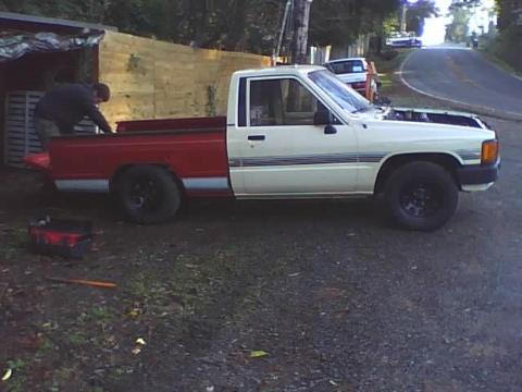

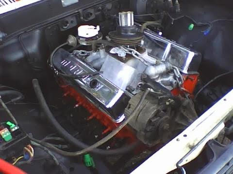

This is what i was working on this weekend. My brother in laws 86 2wd pick up. We are putting in a healthy 327. We got the engine set in this weekend. He already has a ford 9" installed for the rearend and hasn't decided to go with a 4 speed or 5 speed yet. All thats left is install the trans and plumb the engine clutch and brakes and wire the engine and get the driveline made. Also have to adjust the lowering blocks in the rear 4" drop was to much the bed is 1/4" from the tires lol.
