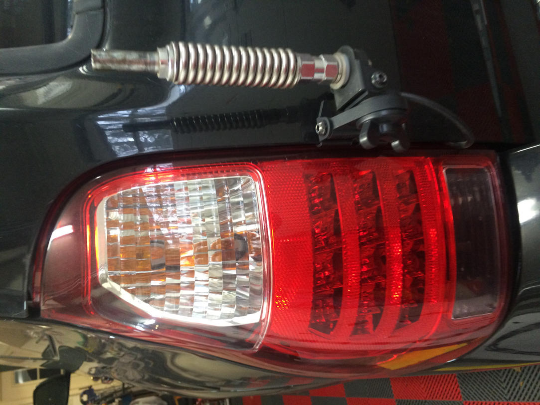

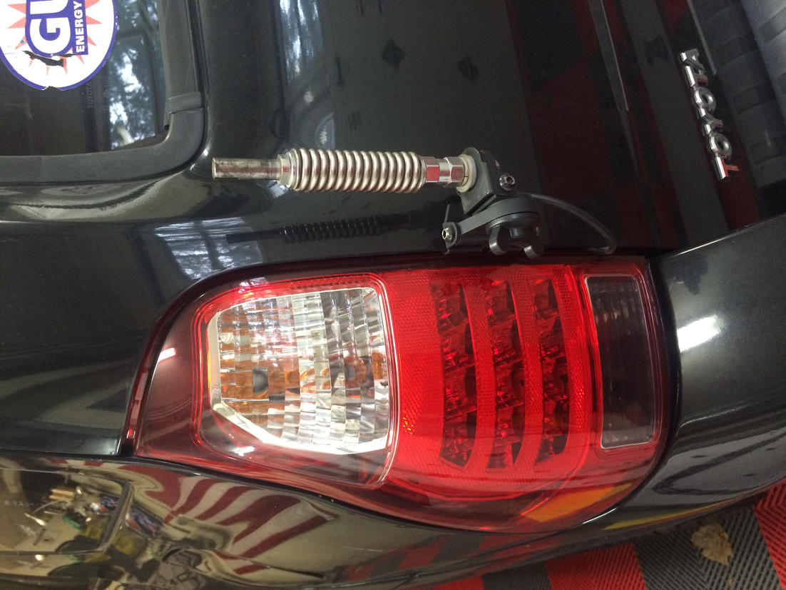

Could you post a close up picture of where/how you mounted your Comet RS720? No hurry. Thanks!
Here is a closer picture of the mount itself. So the mount is simply a hard clamp on to the trunk hatch and it is extremely solid. I then used a FireRing on the bottom for my coax cable, followed by a heavy duty spring and quick disconnect. I park in garages and other low areas a fair amount and the quick disconnect is the greatest thing ever. I then have a 3' Firestik. The antenna is not on right now because I am parked in the garage doing some fabrication for the compressor. Hope this helps!

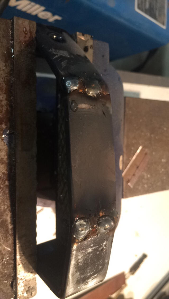

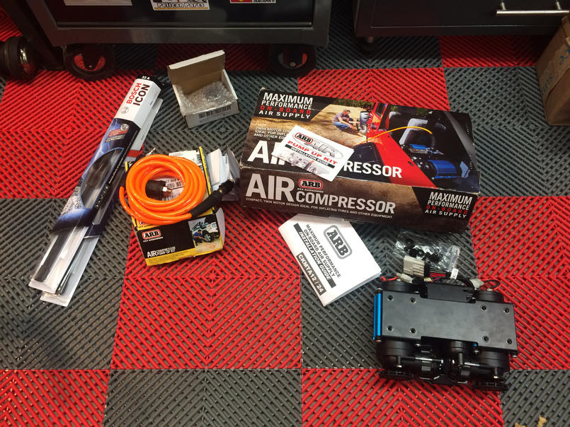

Compressor almost ready!

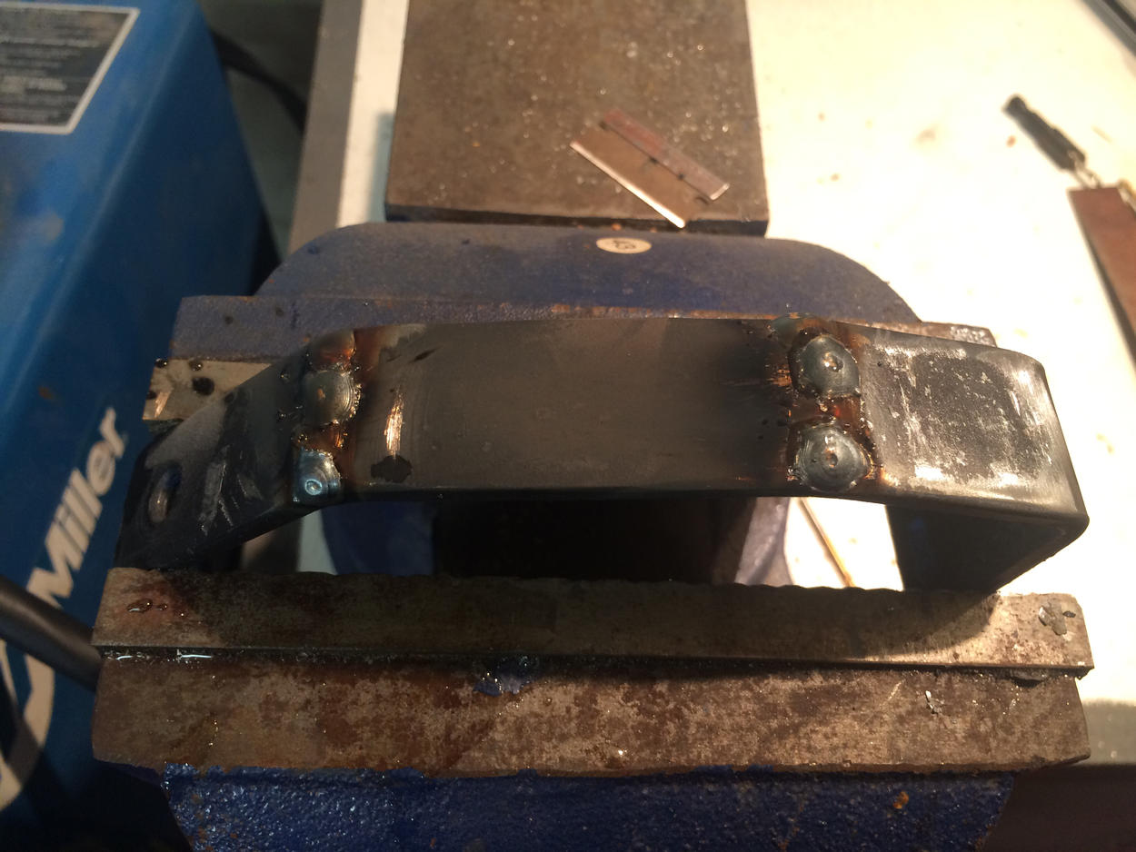

So today was a busy day! Almost have the mount for the ARB Twin compressor figured out and I actually did my first welds ever today! It was a lot of fun. Be warned, the welds are not pretty. But I ground them down a bit and painted them so they look a bit better. We drilled the holes for the mounting and now I'm just taking a break until tomorrow as I was in the garage for like 3-4 hours already. Gonna let the paint dry and pick it back up tomorrow.
Also gonna replace the windshield wipers and hopefully replace some worn out stickers on my rear window tomorrow too!
Goodies :D

Welds (Don't kill me :laugh: )

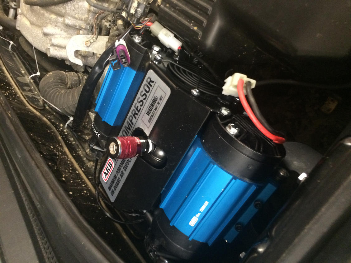

Compressor Installed!

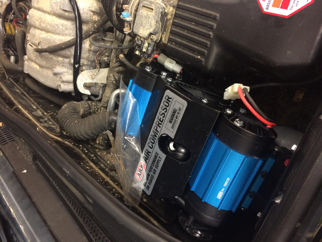

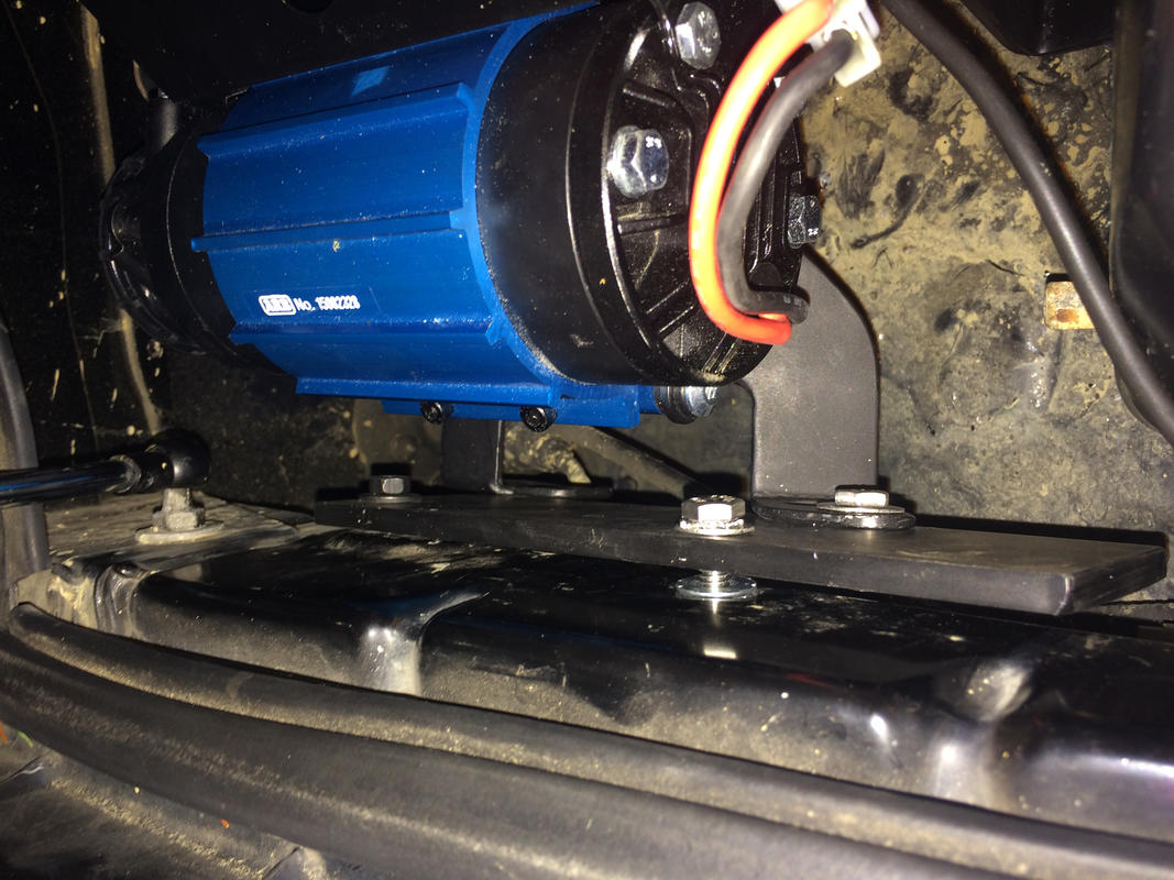

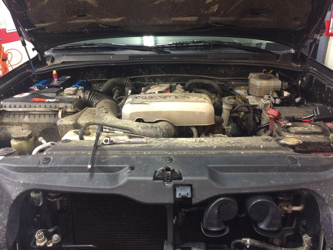

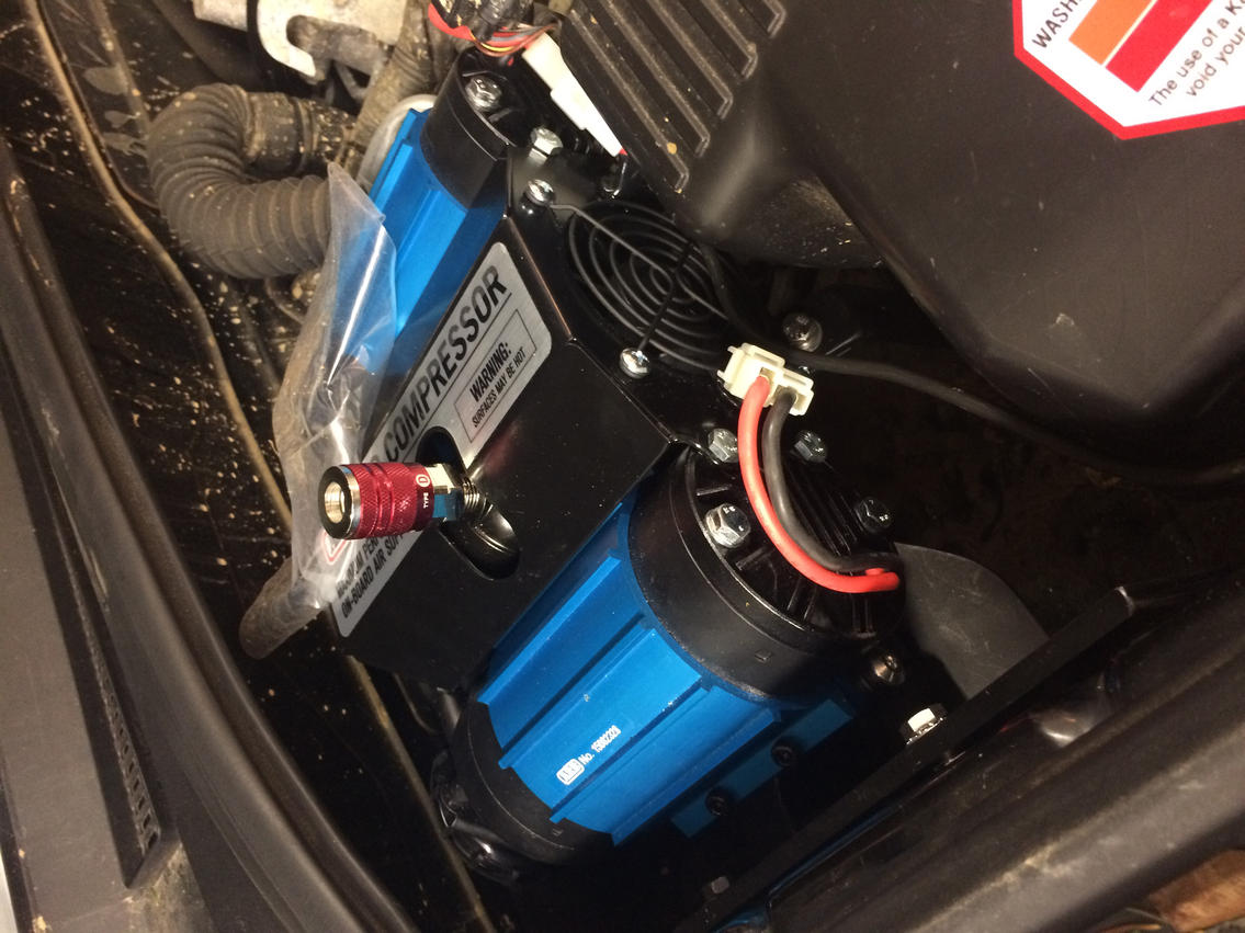

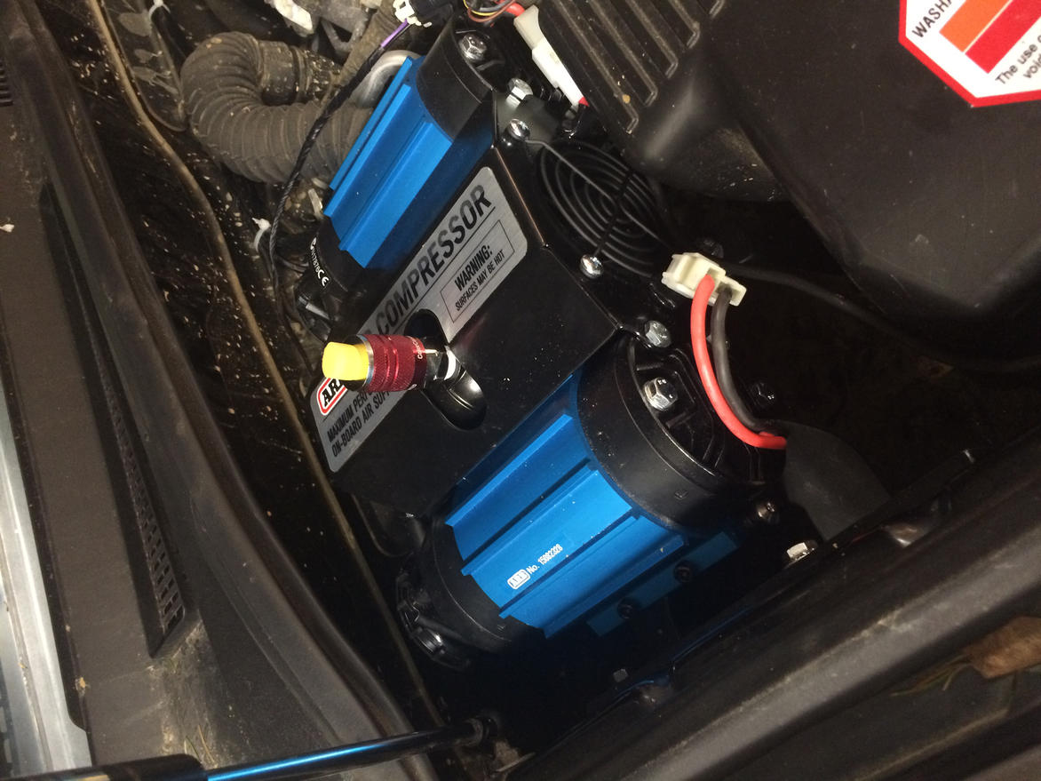

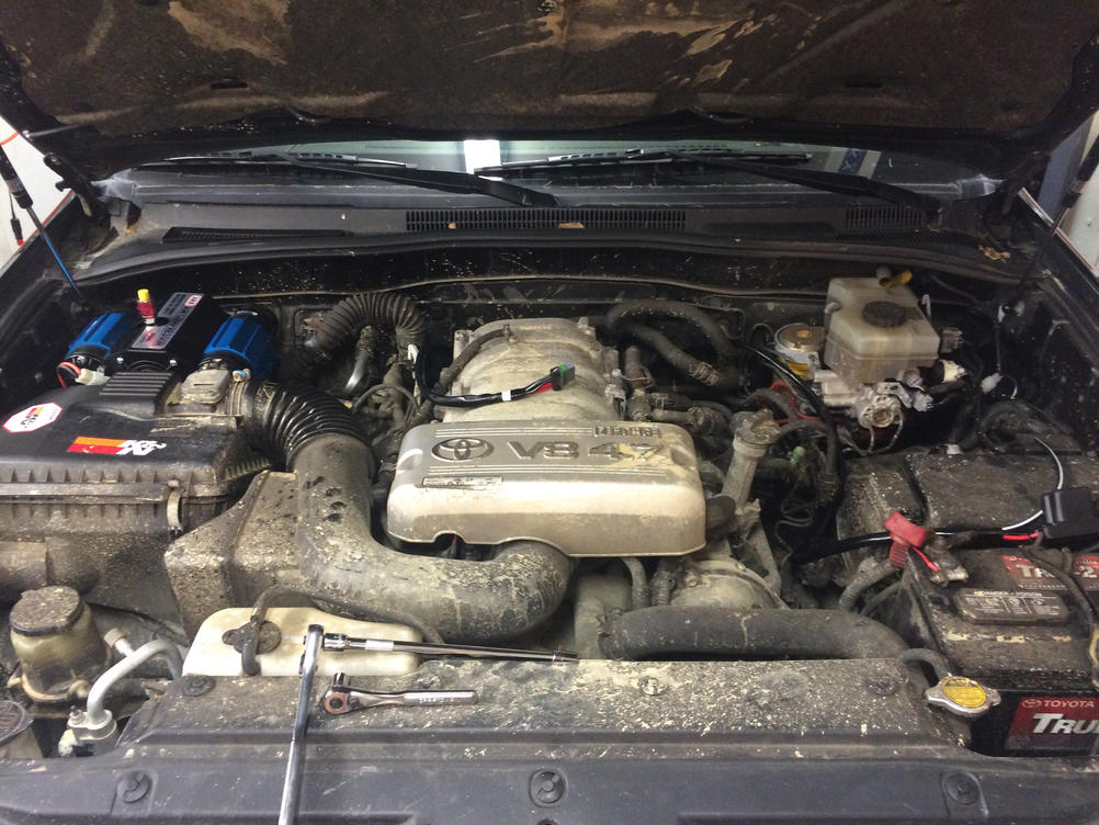

Finally got the compressor installed! Man this thing is heavy as all hell and an absolute beast. Really pleased with the quality and I am extremely happy with the performance I have seen. The bracket started as a bracket from Bandiworld aka Leroy from the FJ forum. He makes mounts for these compressor for FJs and 5th gens I think. I reached out and asked him if he made a mount for 4th gens and he said it shouldn't be too difficult. So he whipped me one up and sent it my way.

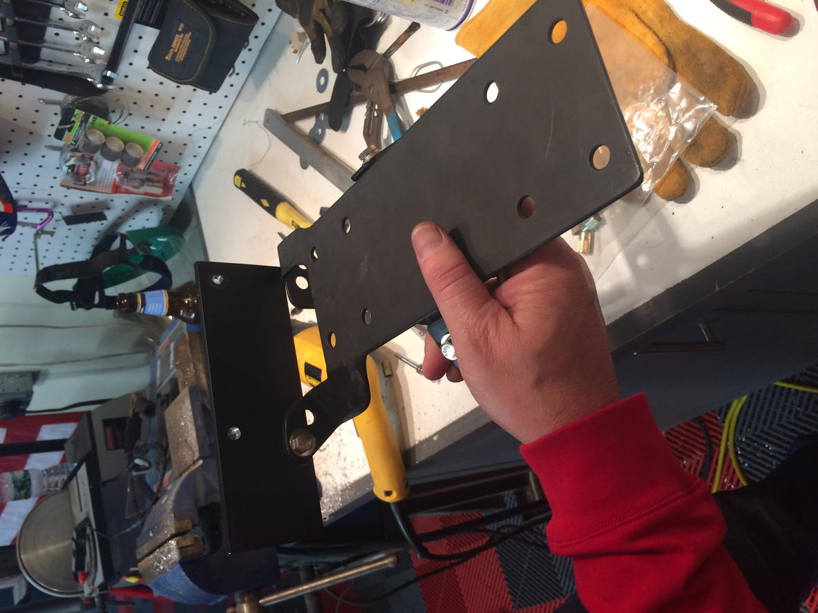

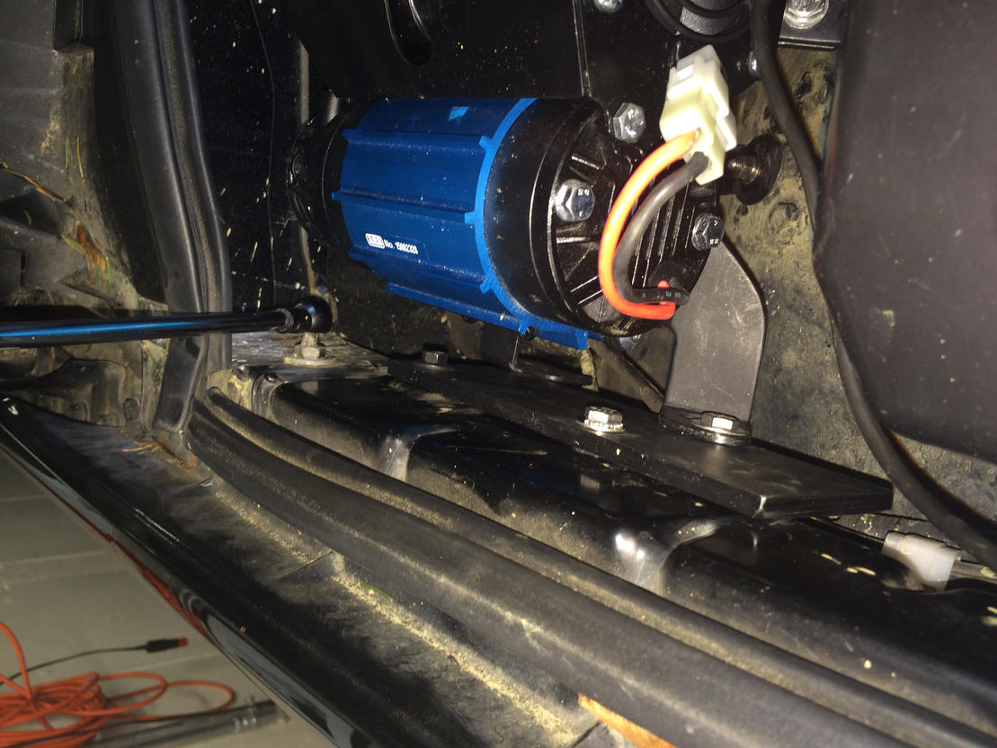

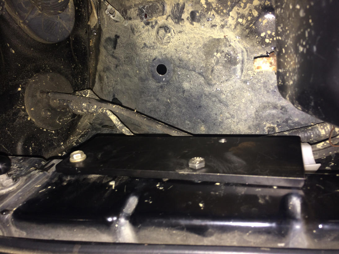

Unfortunately, the mount seemed to be based off a 4th Gen 4Runner that has a factory metal plate by the airbox and more pre-drilled and tapped holes on the fender wall. He was an amazing seller and offered me a full refund plus shipping and stuff, but I said screw it, I'm gonna make this sucker fit. So that's what I was doing for the past two days. I shortened the bracket considerably, rebent the metal, rewelded it, and then drilled some holes to bolt everything in to place. So here are some pictures in progress and the final outcome!
These first two photos show the drop bracket I made with a thick plate of aluminum. Initially the bracket was meant to bolt in to the fender sidewall right where the top of the plate is mounted, but that would leave the compressor far too high and the hood would never close. So as we shortened the overall mounting bracket, we made a "drop bracket" for the side mounts and it came out pretty great.

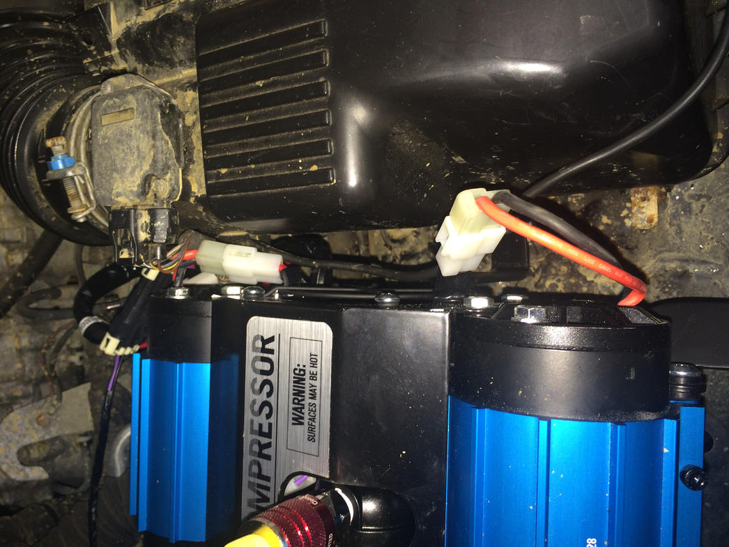

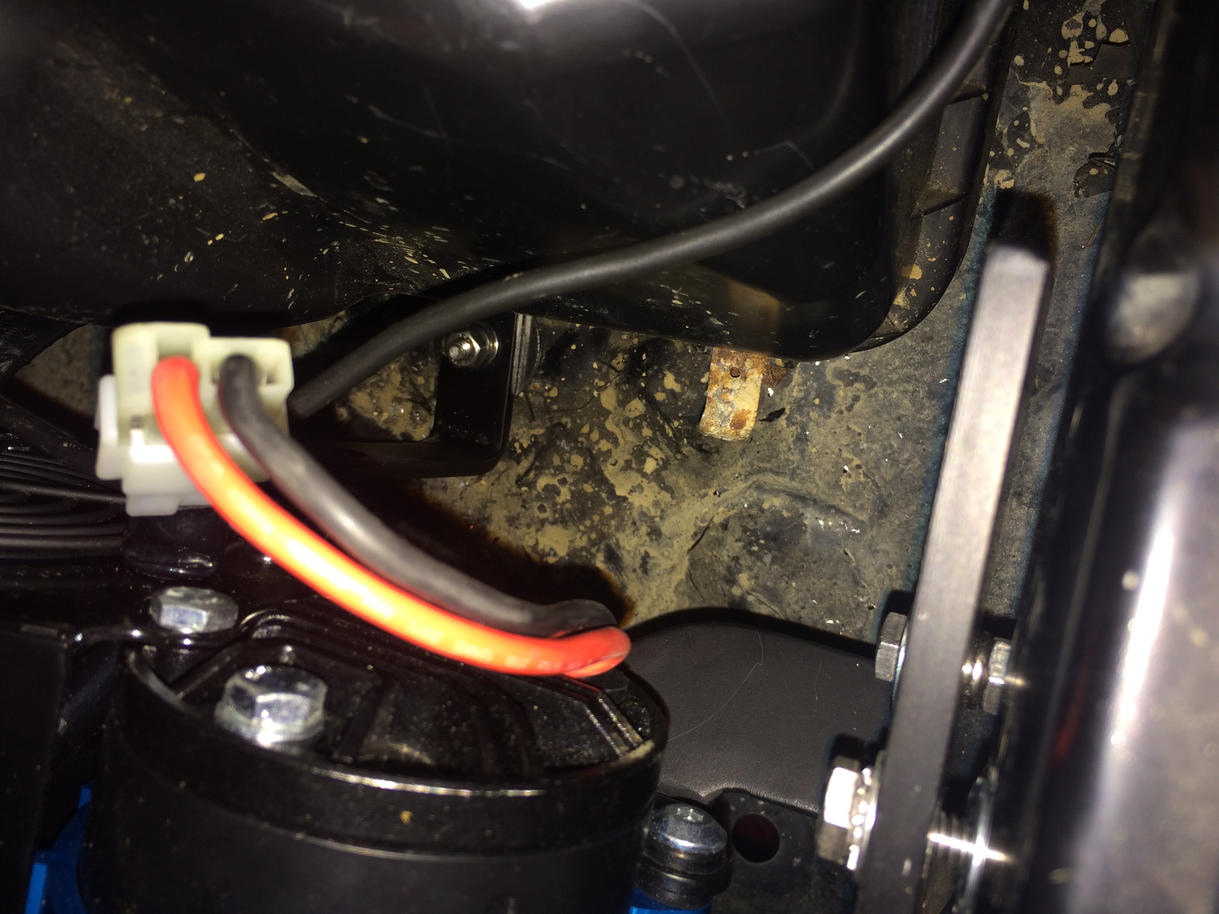

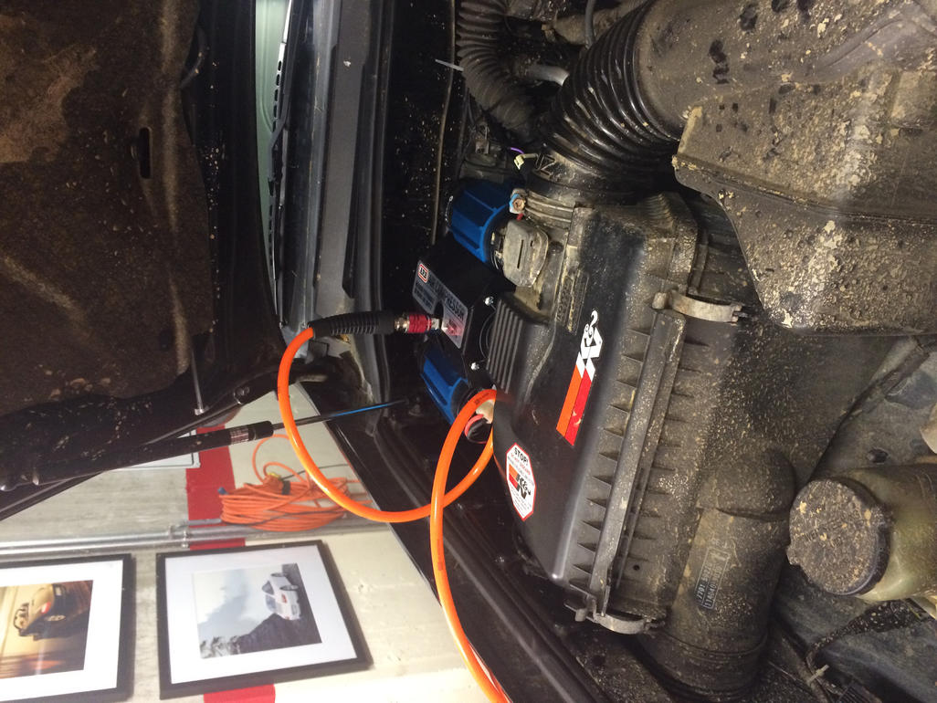

Here are just some more photos of the compressor and mounting.

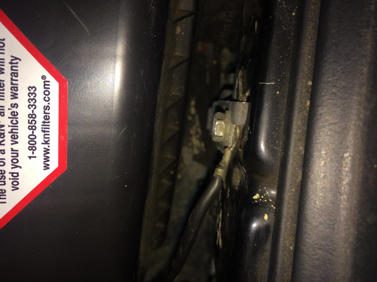

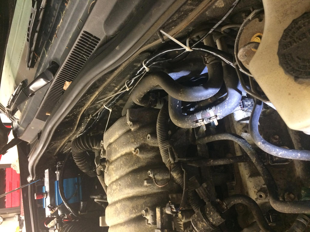

I had to relocate the ground wire for the MAF.

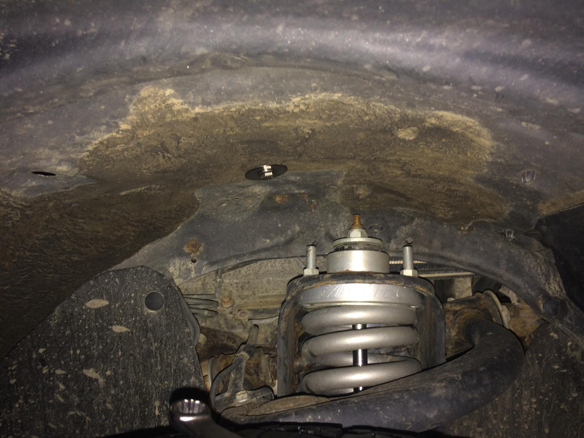

And some more photos of the mounting. Here you can see how I bolted up through the fender well.

Compressor Part 2!
Here are more photos of the compressor installation process and some of my thought process while going through it.

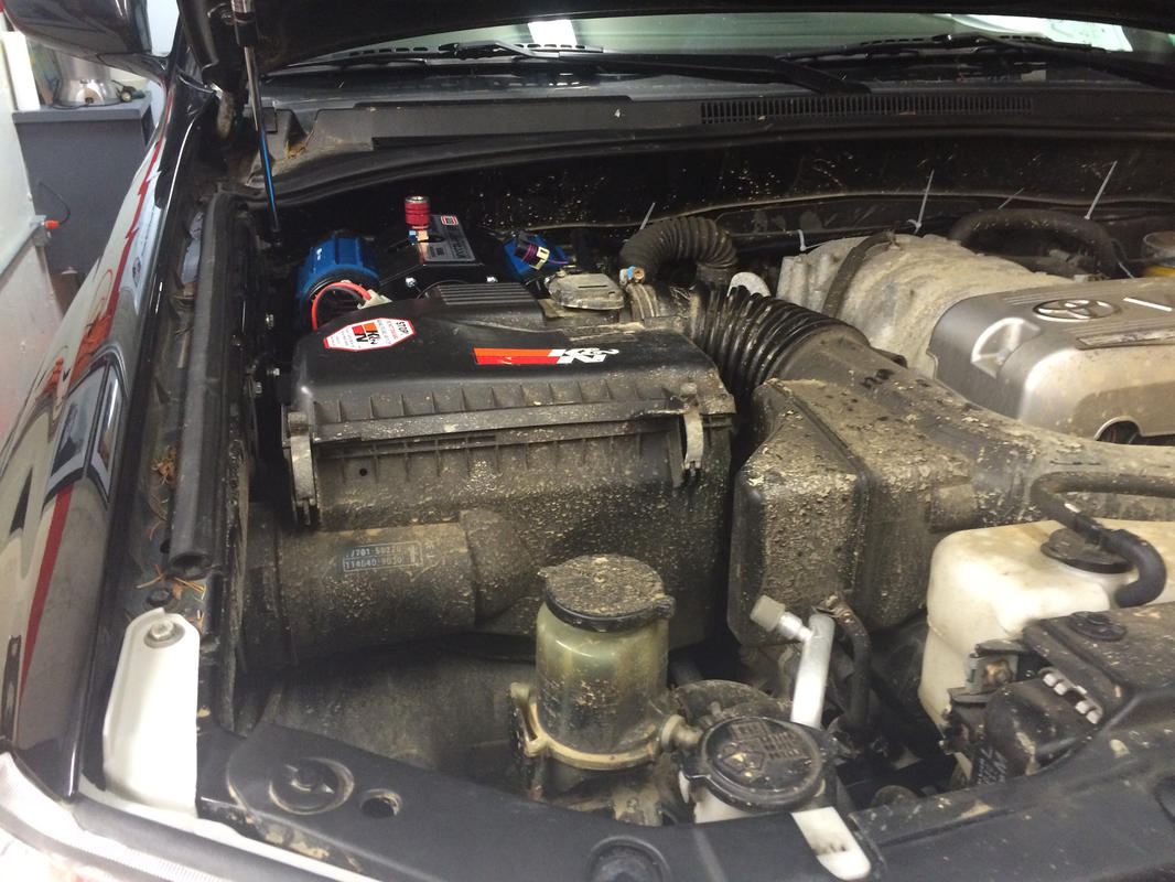

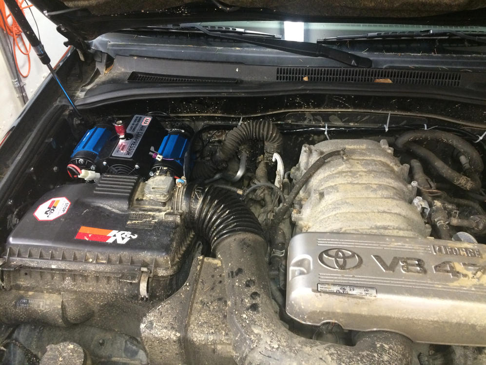

Here are just some more overall shots of how it looks in the engine bay. Pretty low profile and pretty good looking if I do say so myself :D

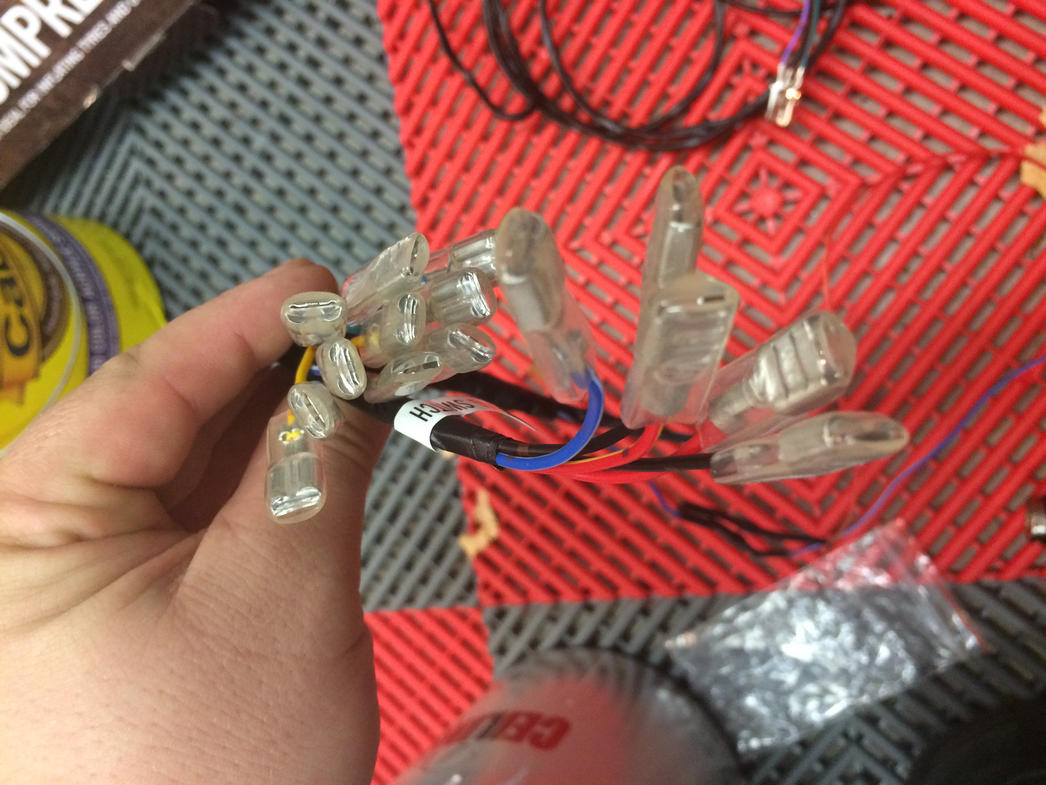

When I was looking at the wiring harness, I did not realize that this thing comes prewired for front and rear air lockers too! That means that while everything is already done for you, boy oh boy are there a lot of unused connections when you don't have them. I don't have any air lockers installed (yet :D ) so I just tucked all the excess out of the way and taped everything up.

More photos of the mounting and how it sits.

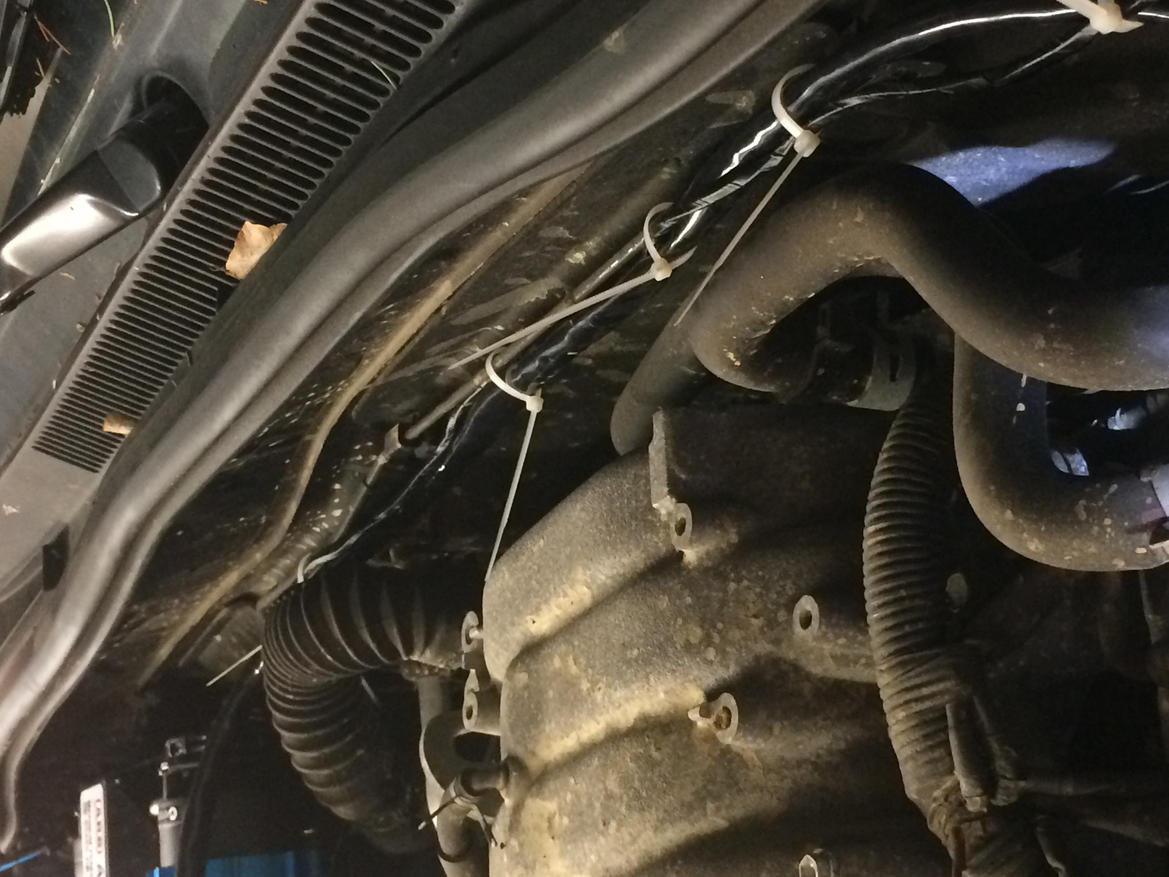

And these last two photos show how I ran the wiring harness across the engine bay. The primary wiring harness for power was the perfect length once ziptied up and out of the way. There was a ton of excess on the switch harness though, but it is a much thinner wire and easier to hide.

Compressor Part 3!
And here are the last photos of the compressor install. I tried it out a bit and got to see how it performs and so far I am very happy with it!

And here you can see the clearance with the airbox. This spot was meant for this twin compressor :D

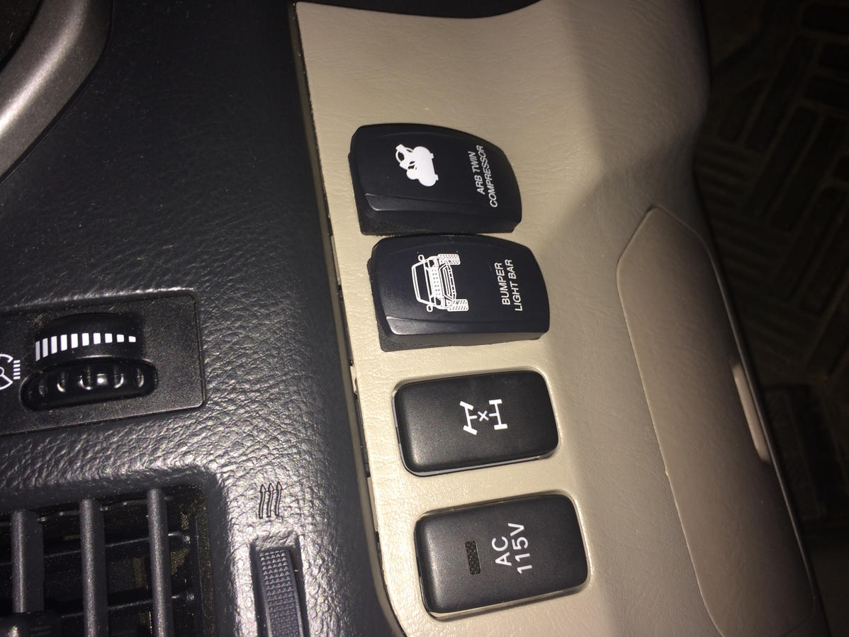

And last but not least, I replaced the included switch with a Contura V from OTRATTW to match the rest of the switches I have in my 4Runner. Hope you all enjoyed!

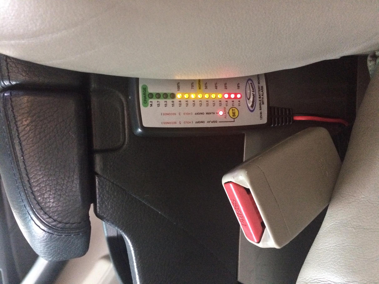

National Luna Single Battery Monitor
So quick little addition today. Now that I am adding multiple accessories, especially the twin compressor, I began looking at ways to monitor my battery health a little more closely. I just wanted to be able to quickly look at the status of the battery and know whether we are good to go or have a serious problem. This is especially relevant with my camping trips. I want to be able to run some lights or accessories for a little bit and then have the alarm go off to let me know that I should run the car for a bit.
That led me to the National Luna Single Battery Monitor. I don't have any plans to get a dual battery setup in the future cause I never really see myself needing it. I am looking in to throwing a bigger battery in the stock battery location, but for now, it does its job and I don't need anything crazy (yet... :D ) I found a nice little spot for it that is out of the way and easily viewable when getting in to the car or looking in the window. Pretty cool product and excited to see how it can help me with managing my time in late night camping setups lol.

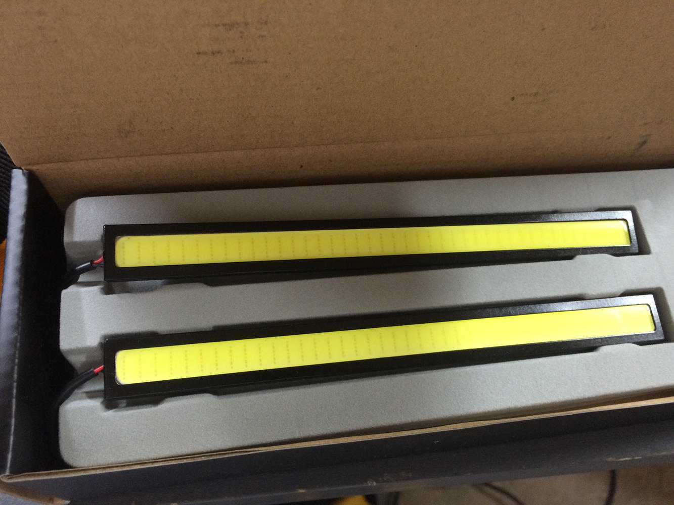

I also started to miss the courtesy lights provided by my now-removed running boards. I decided to pick up some LED strip things from OPT7. Really easy to install, and the adhesive on the back is crazy solid/strong! They are easy to stick under the rocker panel and give off some nice light for people getting in the car. Overall happy with them. Wish the wiring was a bit thicker though, but it didn't cause any problems. Hopefully going to snap some output pictures over the next few days.

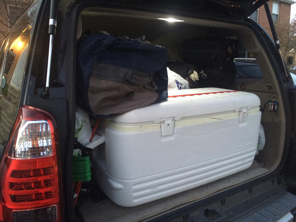

Camping!
Finally all packed up for a trip to GWNF! Heading out with some buddies for a bit. We are going to explore the trails, chill by Skidmore Lake and eventually end up at Flagpole Knob for some camping. Then off to Big Levels the next day for some more off-roading fun!
If anyone has any suggestions within GWNF for places to visit, trails to hit, or anything else, let me know ASAP!
The game of Tetris that is my trunk:

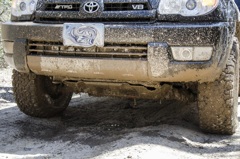

Had an absolutely awesome weekend of camping with my buddies. Great weather, unbelievable silence, and a night sky that was straight out of painting. Couldn't have asked for a better weekend.
Got a lot of off-roading in and hit the mud pits hard haha! The 4Runner was a beast and handled everything like a champ. Hit a very deep mud pit wayyyyy too slow and thought we were stuck and screwed, but nope! The KO2s plus liberal use of the V8's power got me right through it with a fresh coat of mud!
Here are some pics! Shot a lot of footage as well and I am currently working on putting that together in to a nice video over the next few weeks!
