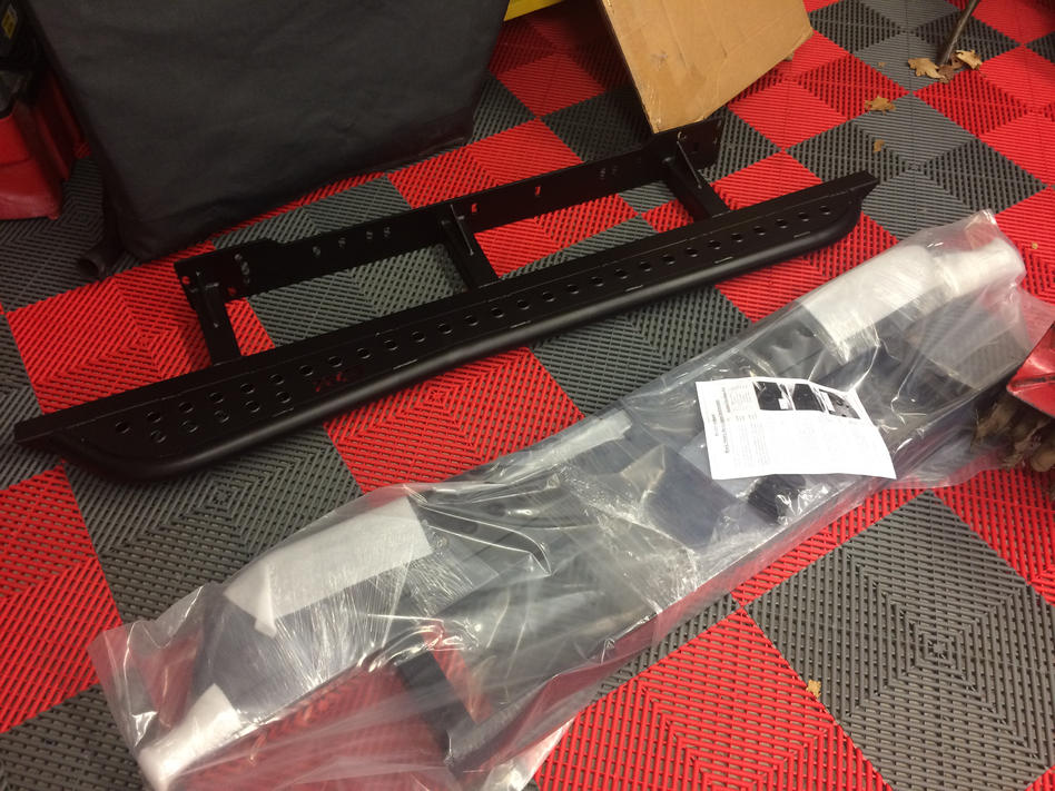

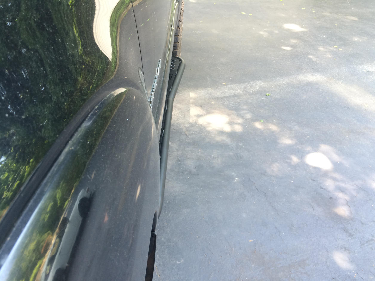

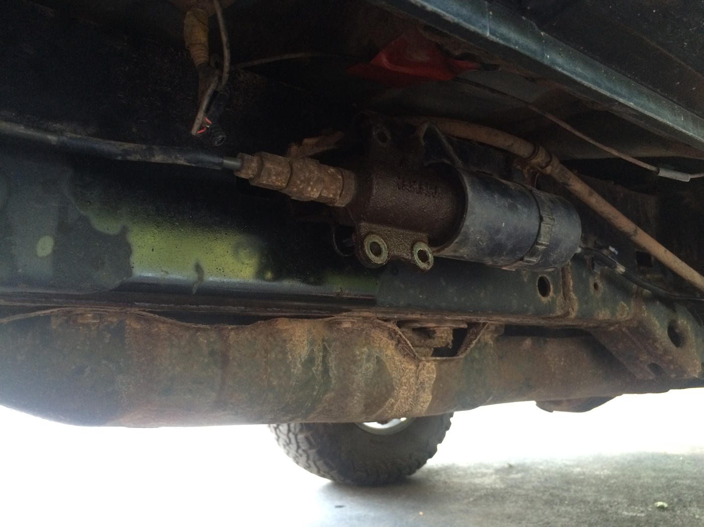

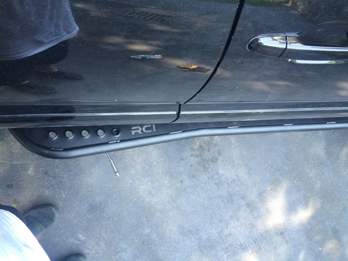

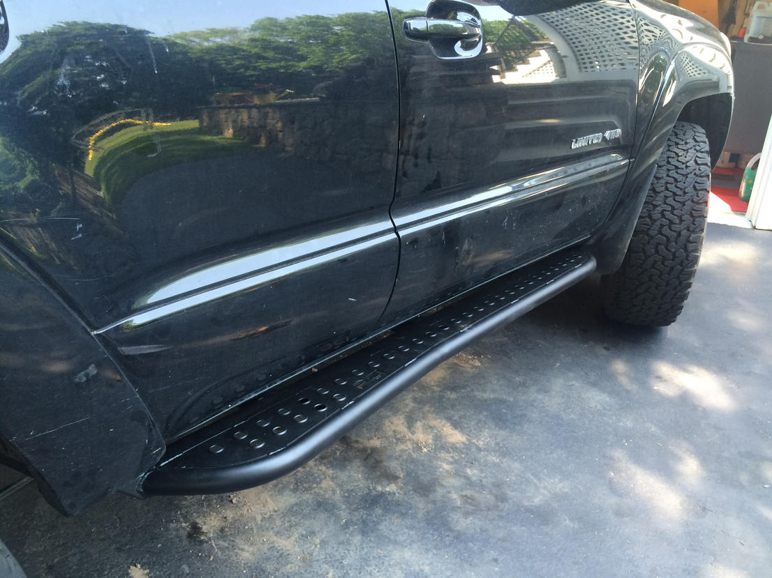

Finally had some time to get the sliders on. They are absolutely awesome. Extremely beefy and I love the look of them all mounted up. Perfectly clear the rear door and everything looks extremely high quality. Ended up getting the top tread plate and them powder coated and it was definitely the way to go (in my opinion).
Mounting was super simple with some help and all of the hardware was provided and really great. There are some holes blocked by the fuel tank, but I ended up shaving the bolt a hair and made it fit on the drivers side with about 1/2" of clearance to the gas tank. Should add just a bit more support and rigidity.
All in all, super pumped about them!
Pic of the sliders just out of the box.

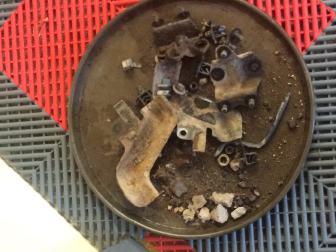

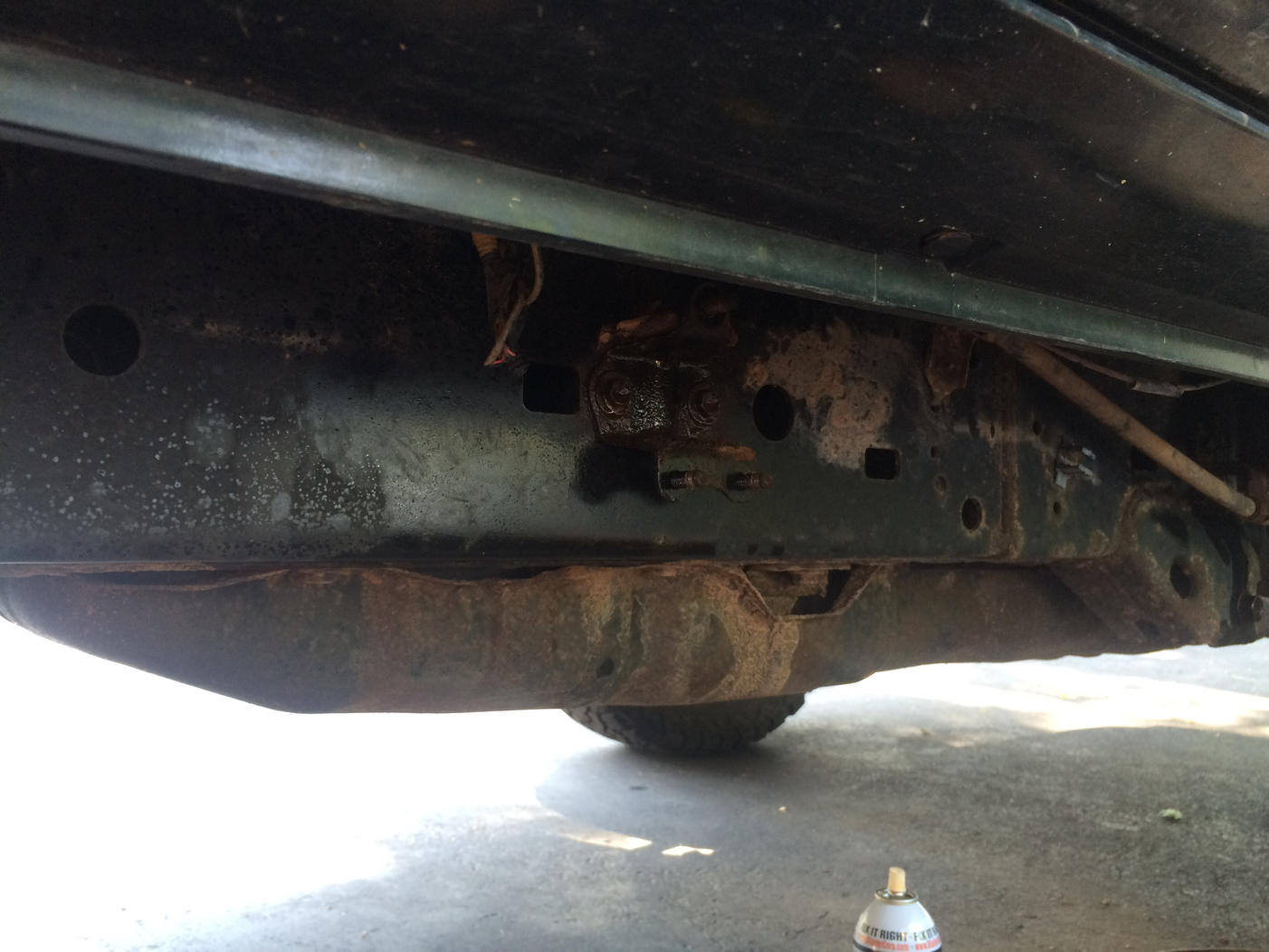

Getting the old XREAS off of the frame rails. Kind of a pain in the butt with 13 years of rust working against me. Some PB blaster and a lot of curse words later got them off. Gotta take off the the pumps and then the brackets behind them.
Some of the crap that was torn out.

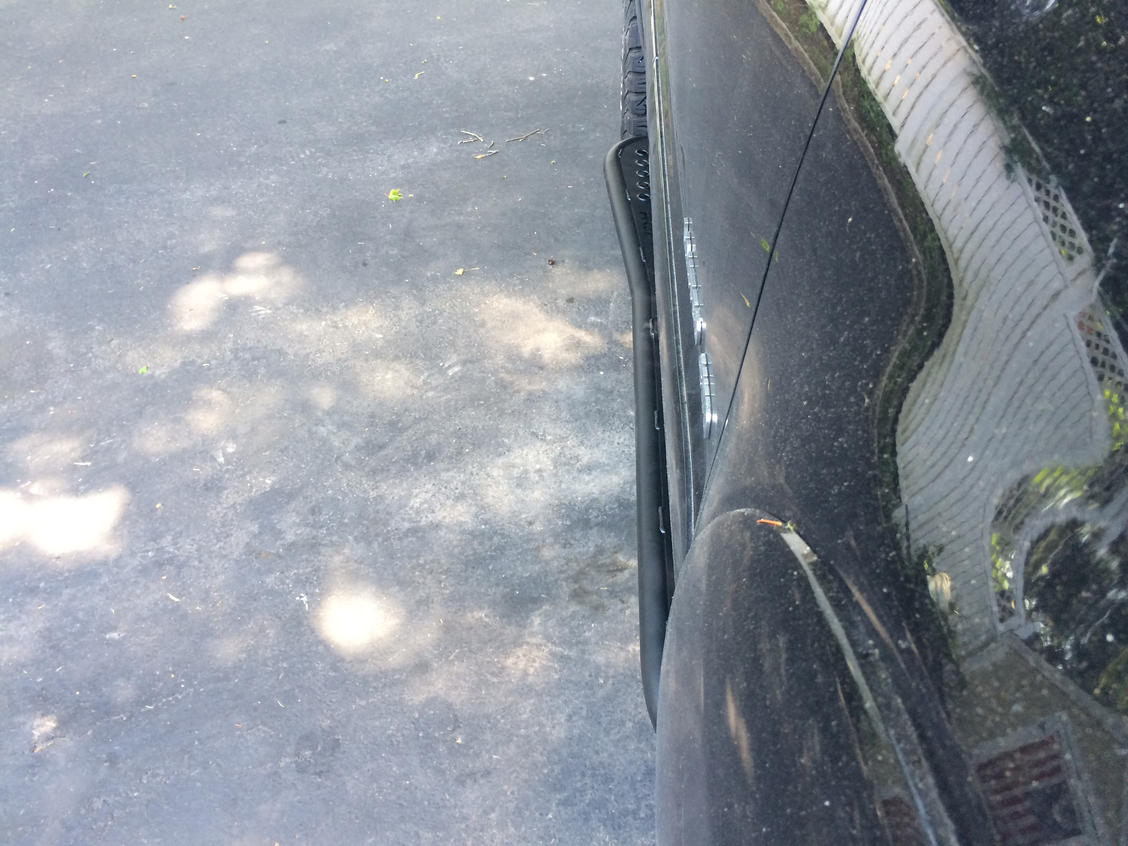

And here are some shots of the sliders mounted up. Freakin love them. Also included some profile shots. They hug the body very nicely.

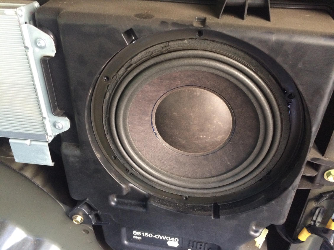

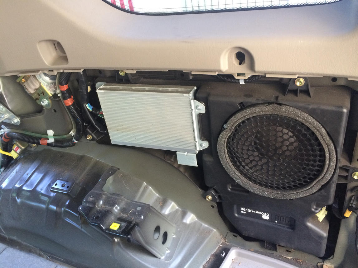

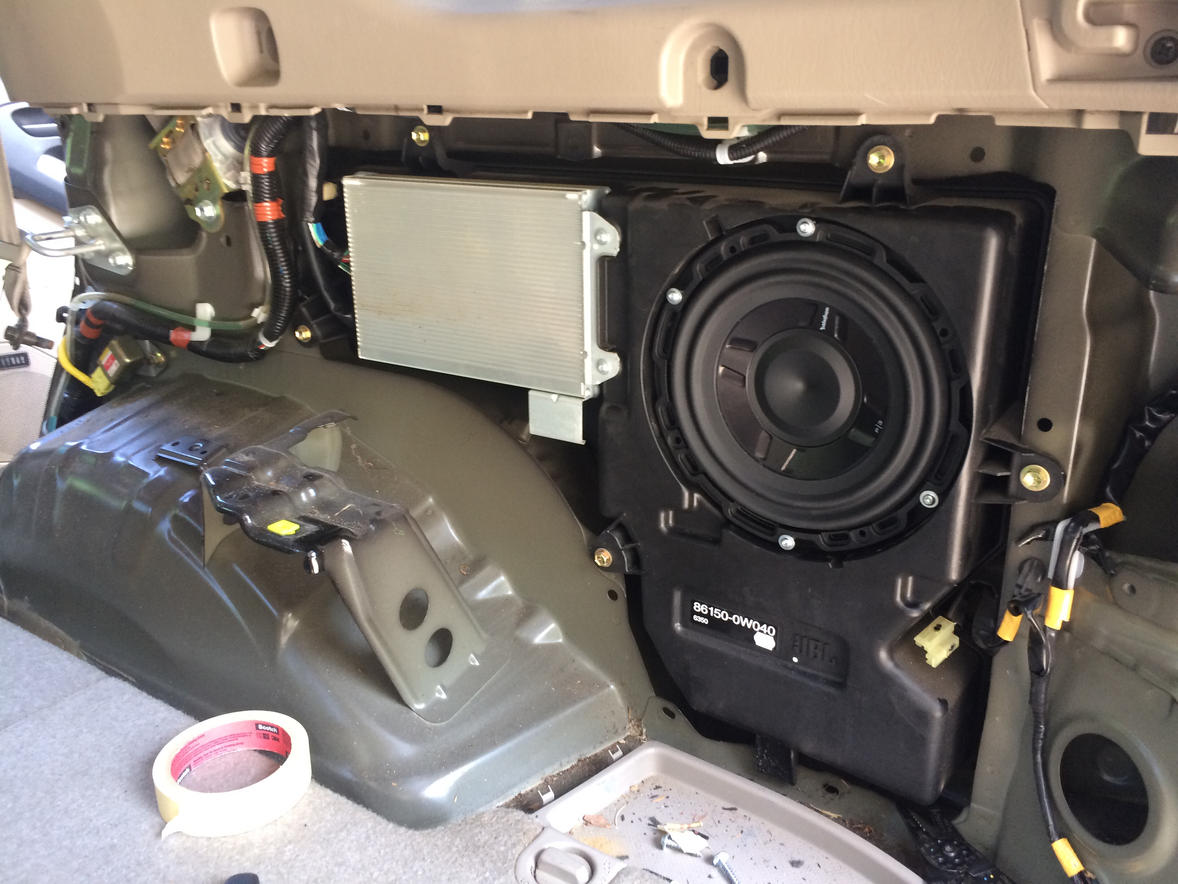

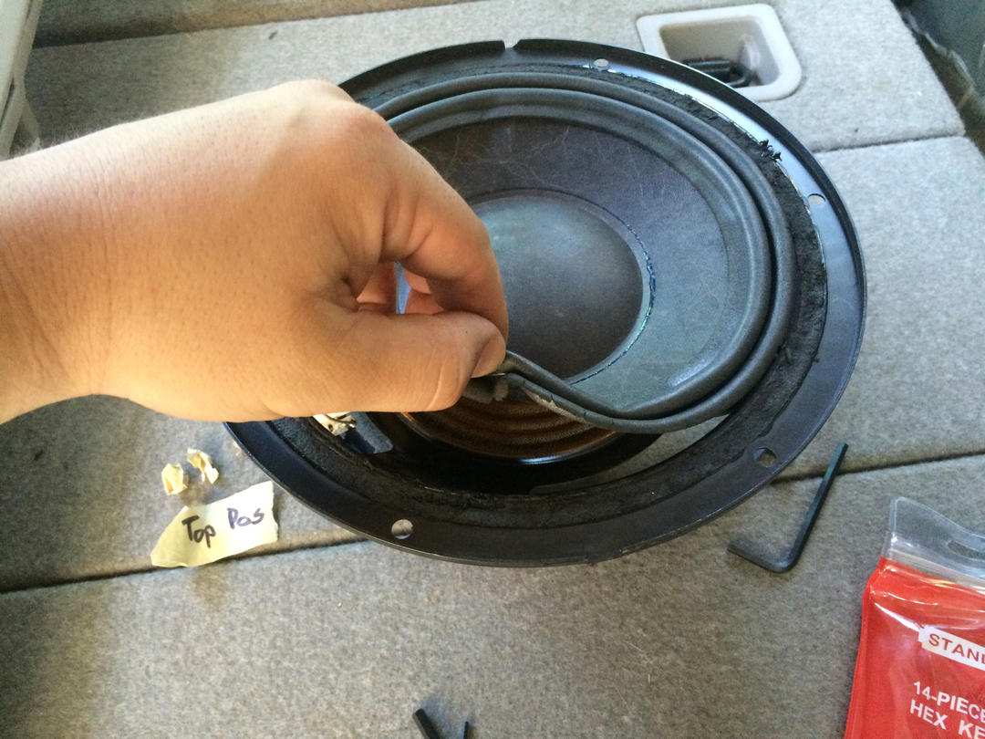

Rattling JBL Sub Replaced

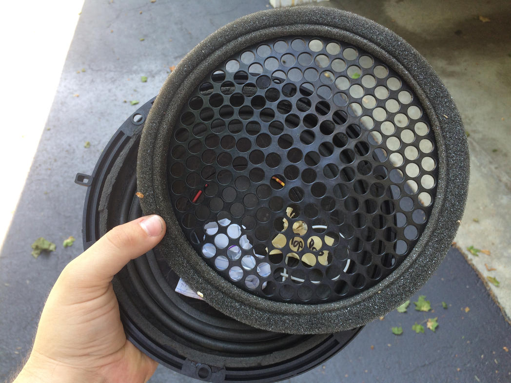

13 years later and the stock JBL subwoofer on my '03 Limited was rattling during almost every song I played. It was driving me absolutely crazy and it sounded really awful and shitty. So I decided to fix that!

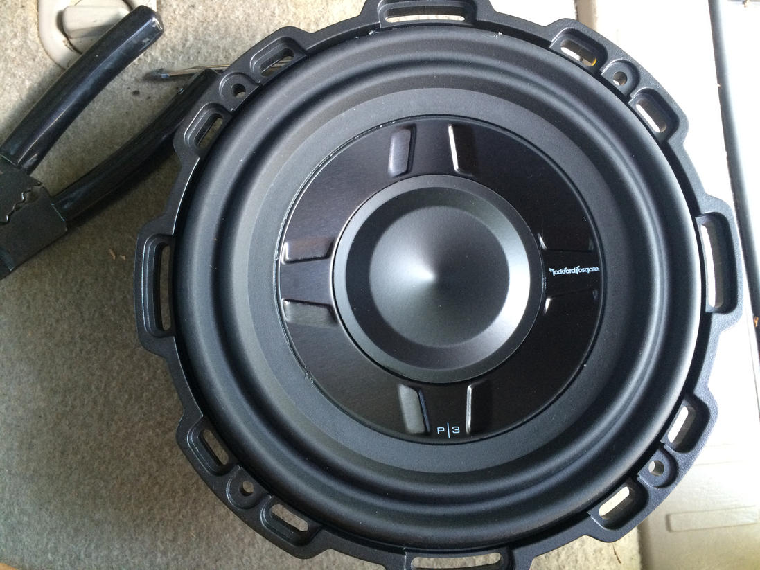

I ended up purchasing a Rockford Fostage P3SD2-8. It is an 8", 2Ohm, Dual Voice Coil subwoofer. Shallow mount as well. Perfect replacement for a stock blown sub. Wiring is a breeze. There are stock 4 wires (2 Positive, 2 Negative) and 4 slots (2 Positive, 2 Negative) on the new Fosgate. Cut off the old connectors, strip wire, reconnect. Incredibly simple. Getting to the sub is the hardest part!
Here are some pics:
Getting to the sub was a pain, but it was well worth it.

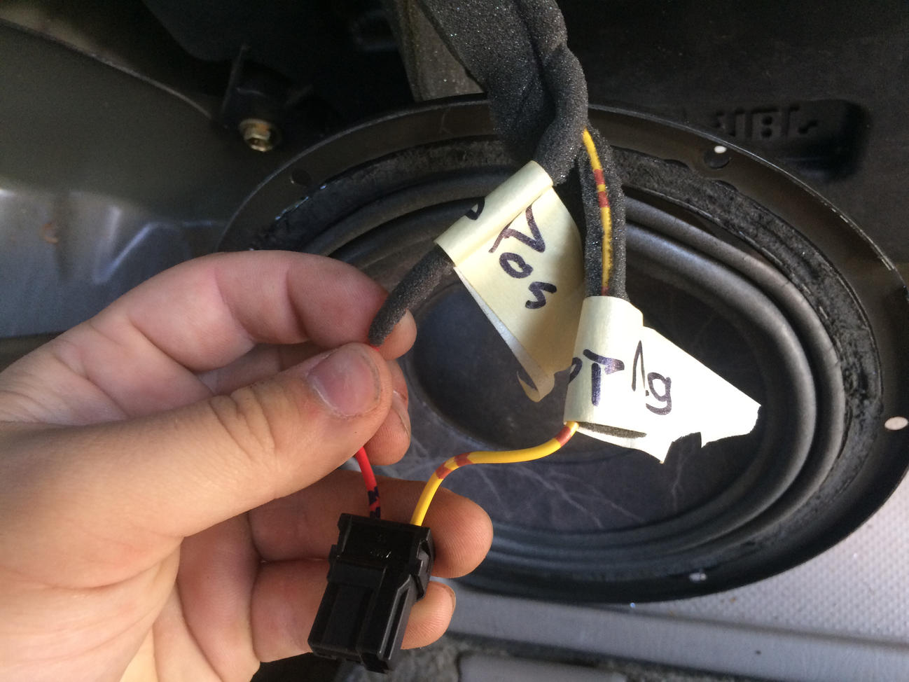

If anyone is doing this, I HIGHLY recommend taping/labeling the wires before cutting off the old connectors. Keeps it simple and keeps you from accidentally crossing a wire!
The old JBL was completely ripped...
In with the new!
All buttoned up.
All of the old garbage from the JBL that was thrown away.

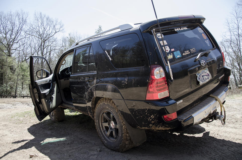

Had an absolutely awesome weekend of camping with my buddies. Great weather, unbelievable silence, and a night sky that was straight out of painting. Couldn't have asked for a better weekend.
Got a lot of off-roading in and hit the mud pits hard haha! The 4Runner was a beast and handled everything like a champ. Hit a very deep mud pit wayyyyy too slow and thought we were stuck and screwed, but nope! The KO2s plus liberal use of the V8's power got me right through it with a fresh coat of mud!
Here are some pics! Shot a lot of footage as well and I am currently working on putting that together in to a nice video over the next few weeks!

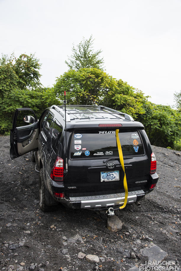

Looks like a fun trip. Also a little tip at least what I have experienced.. . .maybe crack the rear window and throw the tow strap in there. Reason being and I saw you are the same, the back is full of stuff, and the last thing you want to do when stuck or at a bad angle is open the rear hatch to pull your strap out.
Just some friendly advice. Other than that the pictures look great and jealous of your sliders man

Yeah we had the problem when the guy we were wheeling with mounted his winch solenoid control in an awkward location. He stated it didn't feel awkward standing in my driveway on a flat surface. But it was later found out to be a poor location when he was up to his grill in a creek bed full of snakes and hidden in the corner of his fog light hole. (picture a tall man sprawled across his hood with arm up to his elbow digging around in the creek trying to hook up his controller to his winch).
Anyways enough preaching. . .more pictures next time!

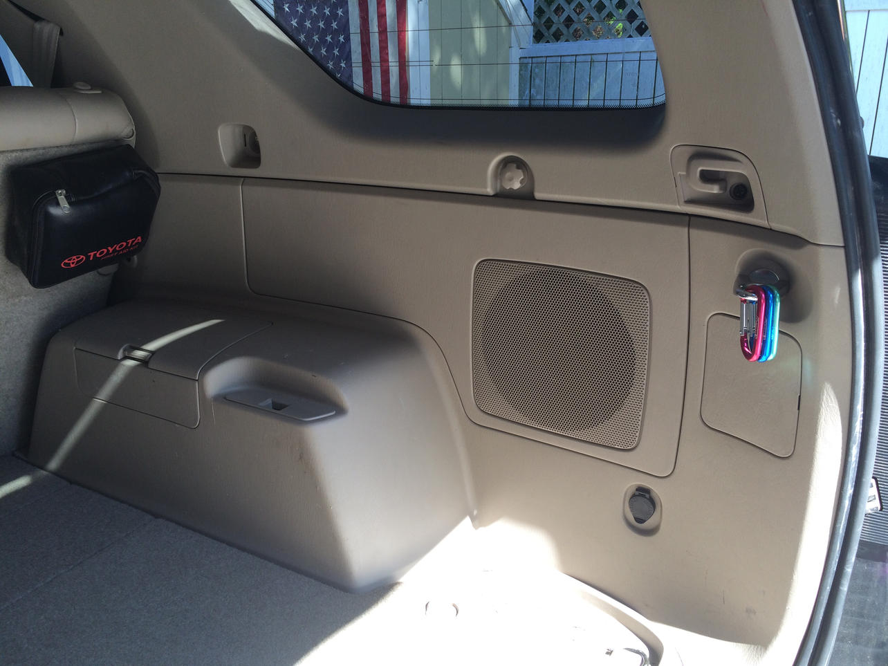

How does the new Fosgate sub sound within the stock enclosure? I'm assuming that you used the factory amp with the new sub?
Did you notice any improvement in sound quality or bass response with the new subwoofer? Mine isn't blown but was looking for a bit more punch from it and was thinking that this might be a way to boost the quality a bit.
Thanks and btw, the photos look awesome!

I think it sounds great honestly. I didn't need a massive sound increase or thumping bass, and I think this is the perfect solution when paired with the stock amp. The stock amp drives it fine. The bass is definitely there, and it has a nice deep sound to it, so I'm happy.
I can't really give a fair comparison because mine has been blown and rattling for so long that I don't really remember the sound back in its "prime." However, I am very happy with this new one for sure. If I crank the volume on some bass-heavy songs, I definitely notice a louder and deeper rumble than before. Hope this helps!

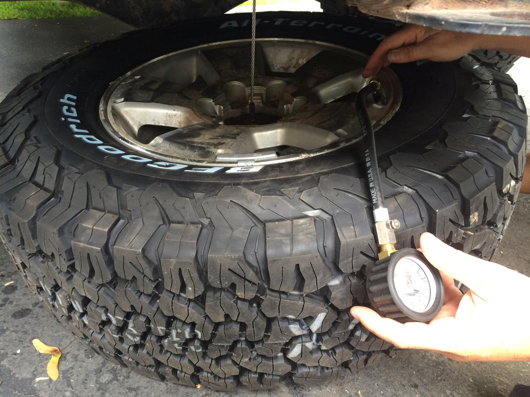

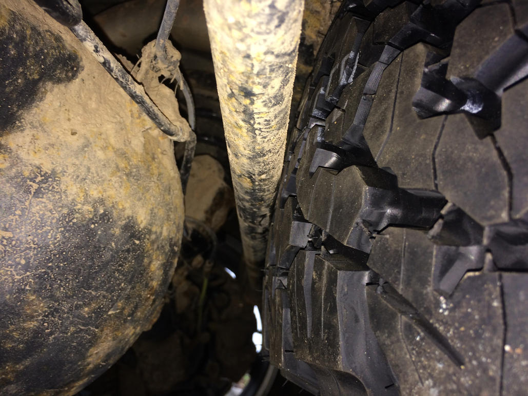

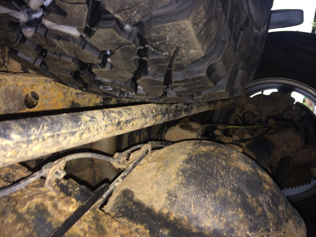

Spare Tire and Bearings

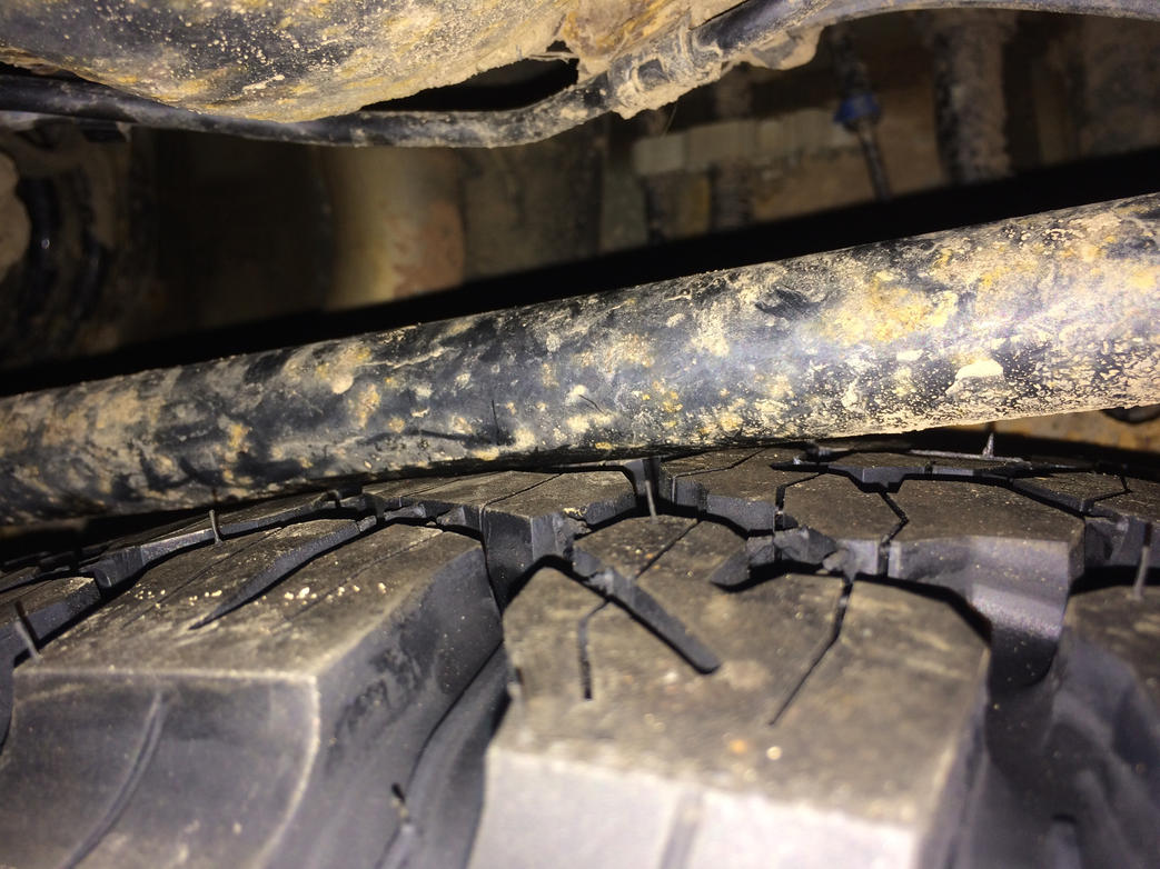

Got the spare tire down, swapped the tire, and got it back up. I aired down to 20psi but unfortunately it still barely touches the track bar. I am trying to figure out the best solution. It doesn't put any pressure on the track bar, but it does touch it. I am going to fiddle with it again, but I am considering putting it on the 4runner and taking one of my slightly worn ones and using that as my spare since it should fit. If anyone has any better ideas, let me know. Here are some pics:

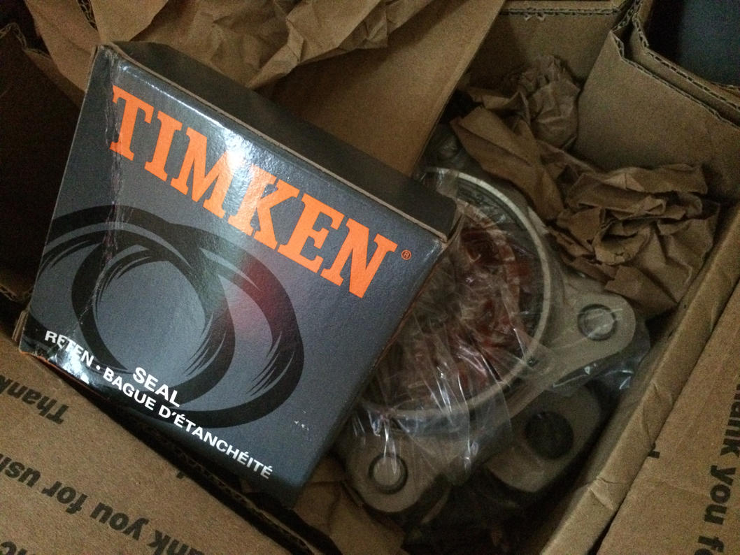

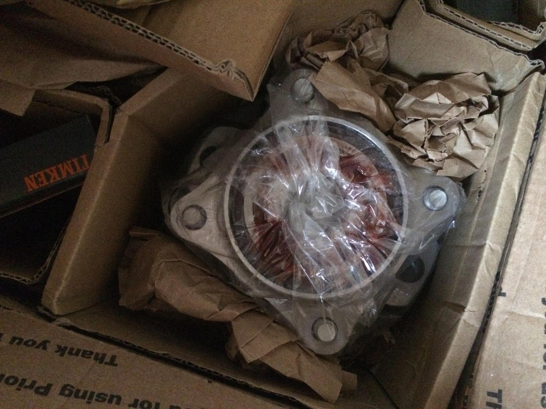

And I got my new bearings in from [MENTION=99491]Bumper2Bumper Auto[/MENTION]! Really needed them and cannot wait to get them in. They look super high quality and I can't for that front end roar from my old bearings to go away! Thanks!

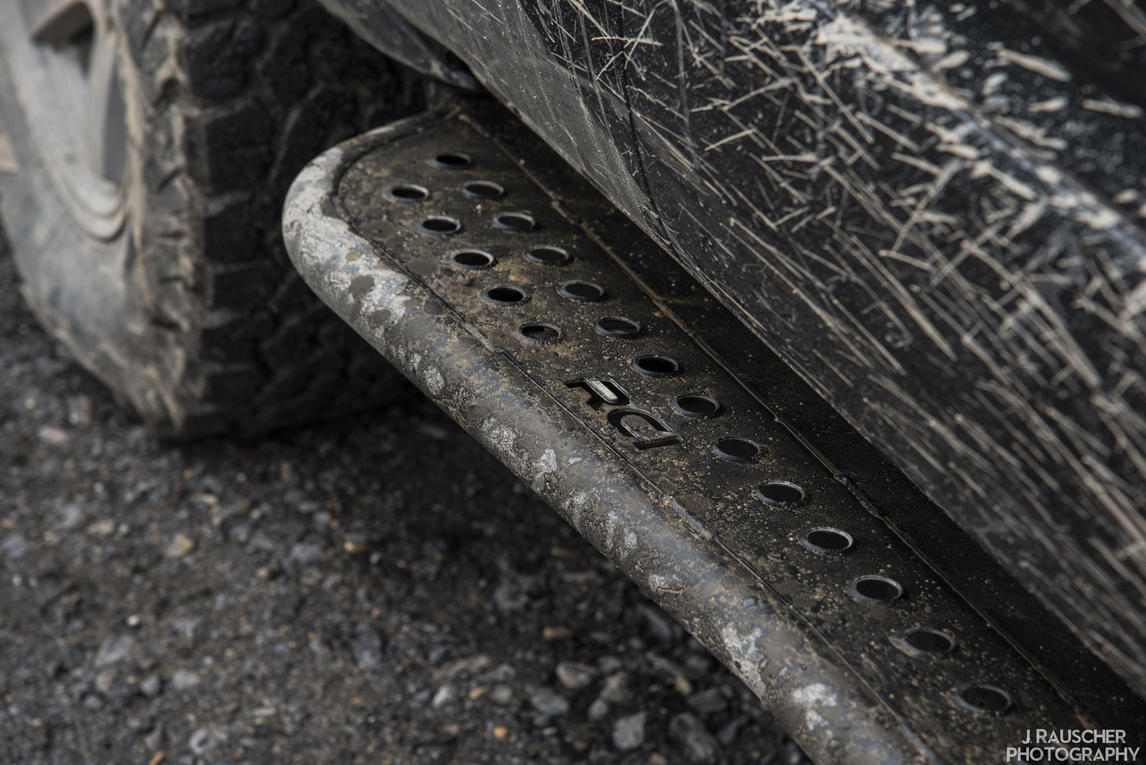

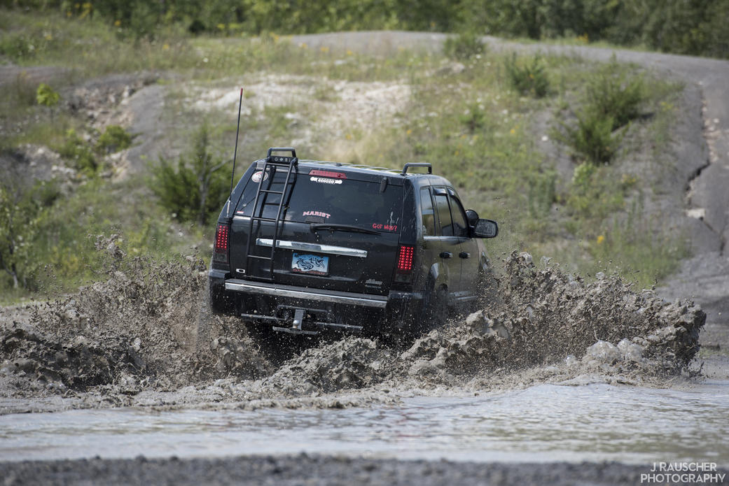

I'm eventually going to be putting a video reel together when I get more footage from camping trips and wheeling, but in the mean time, I felt like this little clip was too good not to post lol.
Getting a little flexy and a little bouncy in the mud at Rausch Creek. Let's just say I am glad I had some rock sliders, and I am super surprised at the amount of flex that I am getting in this video! Enjoy!

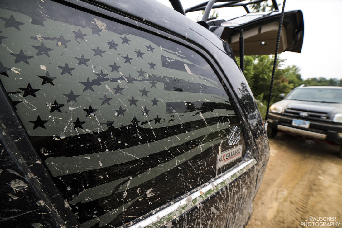

Dang I want that American flag decal on all my windows!
live action!!

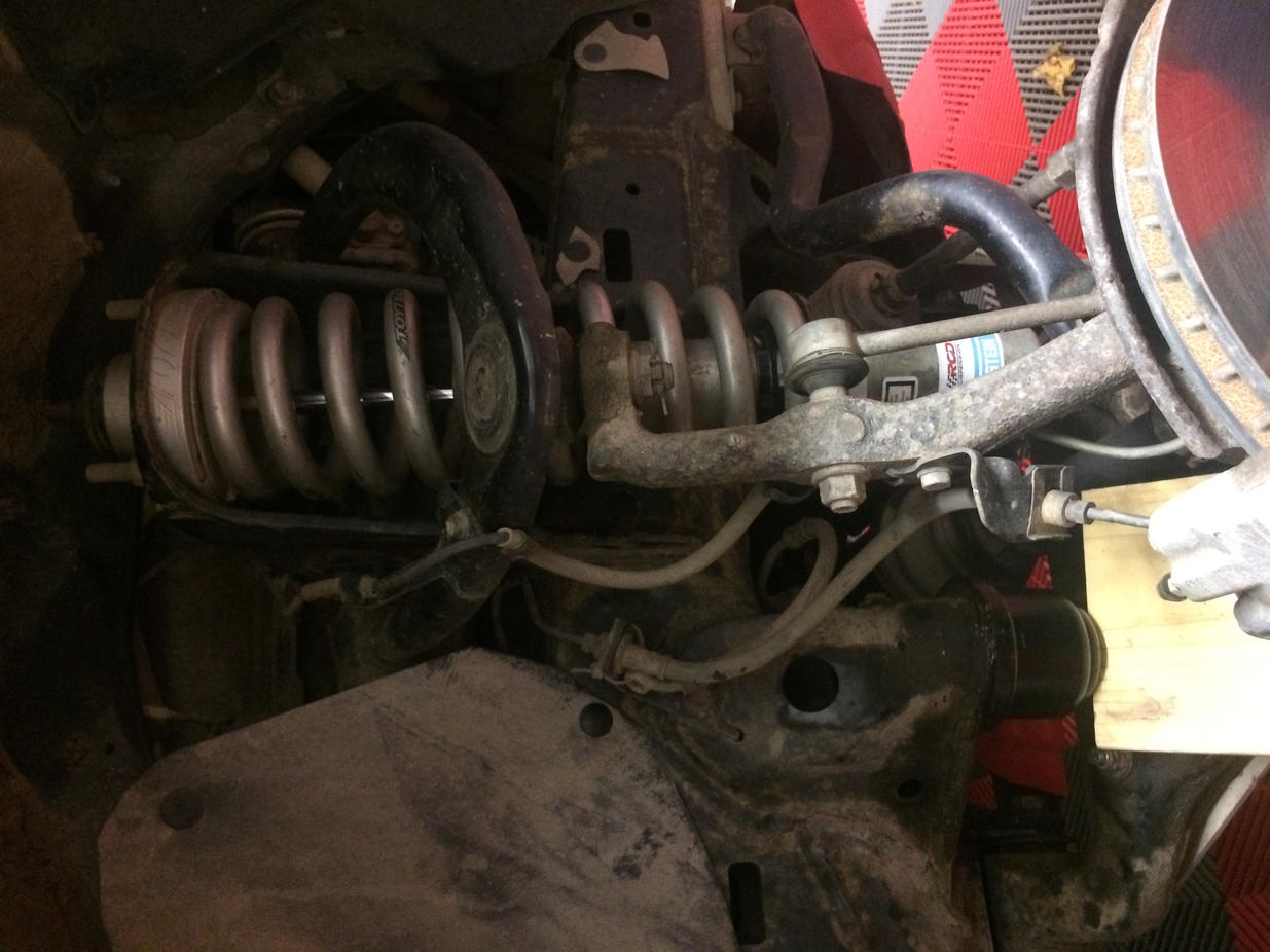

Took some measurements and noticed that my front end was down pretty low when compared to the rear. The rake was very noticeable and I wanted to fix it. So I did!
I bought the Toytec 3" Lift Kit that was preset at 3" up front, and the Superflix 2.5 springs in the rear. The rear always sat higher because of the added spring rate, but it was still way higher than normal.
So I decided to use the no-spring-compressor method and it was absurdly easy. Didn't take a ton of pictures because I had very limited time and needed to get this done, but I am happy to answer any questions!
Here is a picture of the suspension. Hard to tell the difference, but now I only have about .5"-.75" of rake, which will level out when I have my usual camping gear in the rear. Perfect for me.

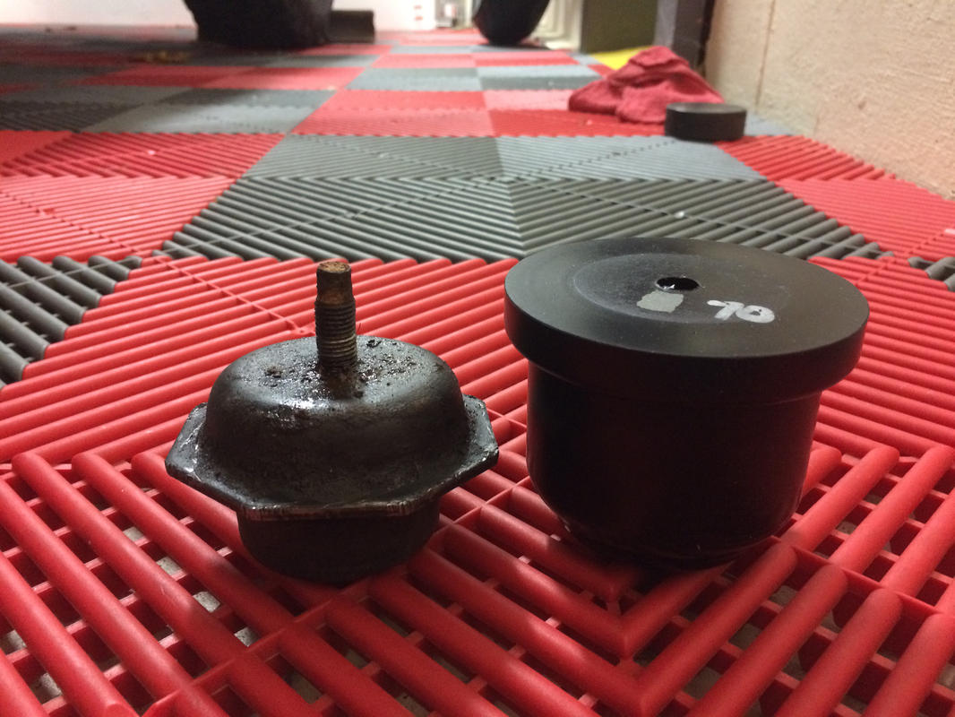

While I was doing that I decided to swap out to the Wheeler Offroad SuperBumpstops. All in all super easy to swap, but the factory bumpstops are a pain in the ass to get out after 13 years of NE rust. I used a pipe wrench, but even that wasn't foolproof. Got the driver side bumpstop in no problem after I got the old bumpstop out. Passenger side was not as kind. Factory bumpstop made it out 10 turns before the bolt completely sheared off. Was coming out fine and then it just broke. Son of a *****...
I was strapped for time, so I couldnt drill the bolt out. And it is a welded nut on the inside, which makes it more complicated lol. So I cleaned the hell out of the original mount using a grinder, cleaner, paper towels, etc etc etc and put some 5000PSI rated JBweld on the SuperBump and stuck in on there. Used a jack and some wood and compressed the crap out of it for 2 hours and I am letting it "cure" for 24 hours. Seems to be pretty solid so far but I'm keeping an eye on it. If it becomes a problem, I'll do the right thing and drop the LCA to drill the bolt out.
Stock vs. SuperBumps
Installed and initial JBWeld curing.

Mine sheared off too. I cut a hole to get access to the welded nut, cut it off with a Sawzall, beat the remainder out with a chisel, then used a nut and lock washer to put the superbumps on.
