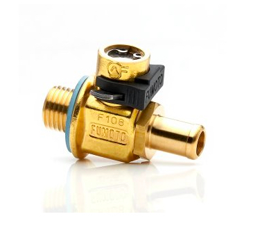

Overall thoughts on it so far? I kinda want one for the "cool factor" but I'm kinda nervous, and I'm not bothered by the OEM drain plug. I'm fine with performing the normal ritual when it comes to oil changes but am slightly interested in the Fumoto drain valve.

Tube not required, and I plan on removing the extra tubing between oil changes. The tubing should also help with minimizing oil splash. The engine oil drain plug looks fairly tucked up in there without any skids so I don't foresee any issues compared with the stock drain plug. If you want an even shorter option they do make one without the hose attachment on the bottom: F-133: Original Oil Drain Valve With M12-1.25.

So I think I may get one, but now my question is: nipple or no nipple?

Get the one with the nipple. Even if you don't use it, it won't get in the way.

Been considering Fumoto valve since they gained popularity, I don't like the nipple running up into oil pan keeps
you from getting all the oil/gunk out of pan. Kind of OCD but over the long haul you'd have a buildup.

The nipple is outside the pan for an optional hose to attach to, not protruding up into the oil pan (if I understand when you are suggesting).
Threaded nipple is 1/2"-5/8" long subtract thickness of pan and crush washer what's left protrudes into pan,
there's oil and sludge left behind with every oil change.
OK - I see what you are saying. i will drain with valve and then pull the valve next time and see what more comes out. If it's measurable, then you may have a point. Sludge isn't coming out on its own, regardless.
Methinks you need to look inside the oil pan. There is a welded nut (basically) that protrudes just as far into the pan as the Fumoto valve. You aren't losing any ability to drain the oil or gunk out.

I'll do that, no further than I've looked was thinking the threaded nut plate was like 1/8"- 3/16" thick or so reason for fine threads on plug. Might get convinced to go with it.
