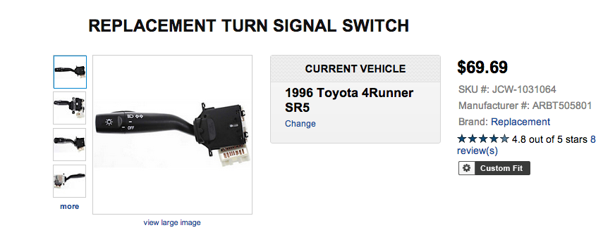

So here is a pretty good story about a local Toyota dealership... Since I bought my 1996 4Runner the end cap on the blinker and headlight leaver fell of every time I touched it. My Dad being the great Dad he is tried to help and super glue that cap on.. Wasn't the best idea... So Valentines night I went to get in my Runner to take my girlfriend out on a date tried to turn my headlights on and nothing.. The super glue had gotten in between the connection not allowing it to turn on. I ended up having to drive my Mom's Ford Edge that thing is about the size of a damn tank. I hate driving it. So anyways the next morning we got up early and headed to the dealership to see if we could get it replaced. We though it wouldn't be that much. Man were we wrong. They were wanting $500 for the cost of the part and labor. The part was $218 and labor was $282. So I hopped on Google and found the part for $70 at JC Whitney with 10, 5 Star reviews. And there was NO labor to replace the part a damn monkey could have done it! There are 4 bolts, 5 screws and 1 connector you have to take out and slide the new part into. So thats what we are going to do. I just thought I would share this little story about our local STEALERship. Hope you enjoyed!
Here is the part at JC Whitney:

I don't think that fly's here... 282 for labor at a dealership is probably 2-2.5 hrs, and I highly doubt that is book time for this repair.
Same goes for the O2 sensors, 725 for 2 O2 sensors is robbery. Each one can't be more than 1 hour as a minimum default for book time.
I usually agree on OEM parts, but for random little bits like the shifter arm, don't worry about OEM. Safety critical components, yes, but stuff like this, definitely not. And with the warranty, you still often have to fight the dealership to get them to admit the fault was in the part itself or their install, and not that you broke it.
As far as I remember you remove the bottom steering column cover by removing 2 or 3 bolts underneath. Then you can see the switch and the lower bolt of the switch is easily visible. The top bolt is kind of hidden under the top-steering-column cover. You can carefully lift it but it tends to break.
To access the two bolts in the top steering column cover, you have to remove the steering wheel. Correct me if I am wrong.

And at that price, he can change it 6 times before it comes close to the dealership. If you need oem parts, contact toyota of dallas. They have very fair prices.

I'll post pictures when I'm doing the install. I never had to remove my steering wheel.. Just turn it to the right and left to get two screws behind it.

[MENTION=99529]TannerW[/MENTION] dude you were at a "Stealership"!!! I purchased my turn stalk at my local Toyota dealership...and paid $75 for it. Either they looked up the wrong part number or he was being very dishonest.
Heck, when I take my Toyota in to the dealership, they always gives me the Toyota price and aftermarket price for parts. Maybe I'm just luck that I have a good Dealership and not a "Stealership"!! Wow!
