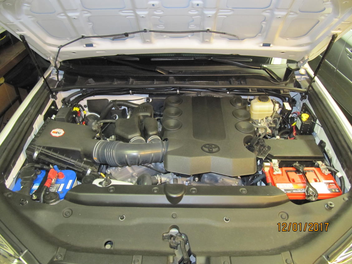

As you can see from the picture I have two different AGM batteries. I will probably get some flak for these not being the same type. Optima D34M and Odyssey 34R-PC 1500. They are isolated by a Blue Sea ACR which is in the locked off position.The optima is for accessories only and used as a backup in case the primary fails.
I put both batteries on a "CTEK multi us 7002" maintain charger when the truck is not being used. this should take care of low charging issues and desulfation.
I was not comfortable using boosters to up the voltage.
Note: This is not a daily driver, recreational use only.
So far So good.
