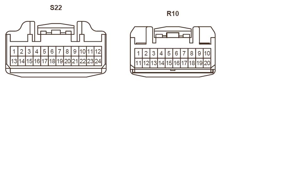

Look at this thread (post):
http://www.toyota-4runner.org/engin...me-help-navigation-install-19.html#post133362
R10 (back of OEM NAV unit) and S22 (back of AMP)
So.. From Connector:
R10 Pin 11 - S22 Pin 23
R10 Pin 12 - S22 Pin 22
R10 Pin 13 ---SHIELD.
My take is that your connect the first 2 wires, then with a shield'ed wire you connect to Pin13 (on R10) and RUN the wire back to the amp and connect to NOTHING. I read this in a Tundra forum but I can't find the post.
Hope this helps.
I'll be embarking on this very soon as I'm getting extremely frustrated on not having these features hooked up yet.
