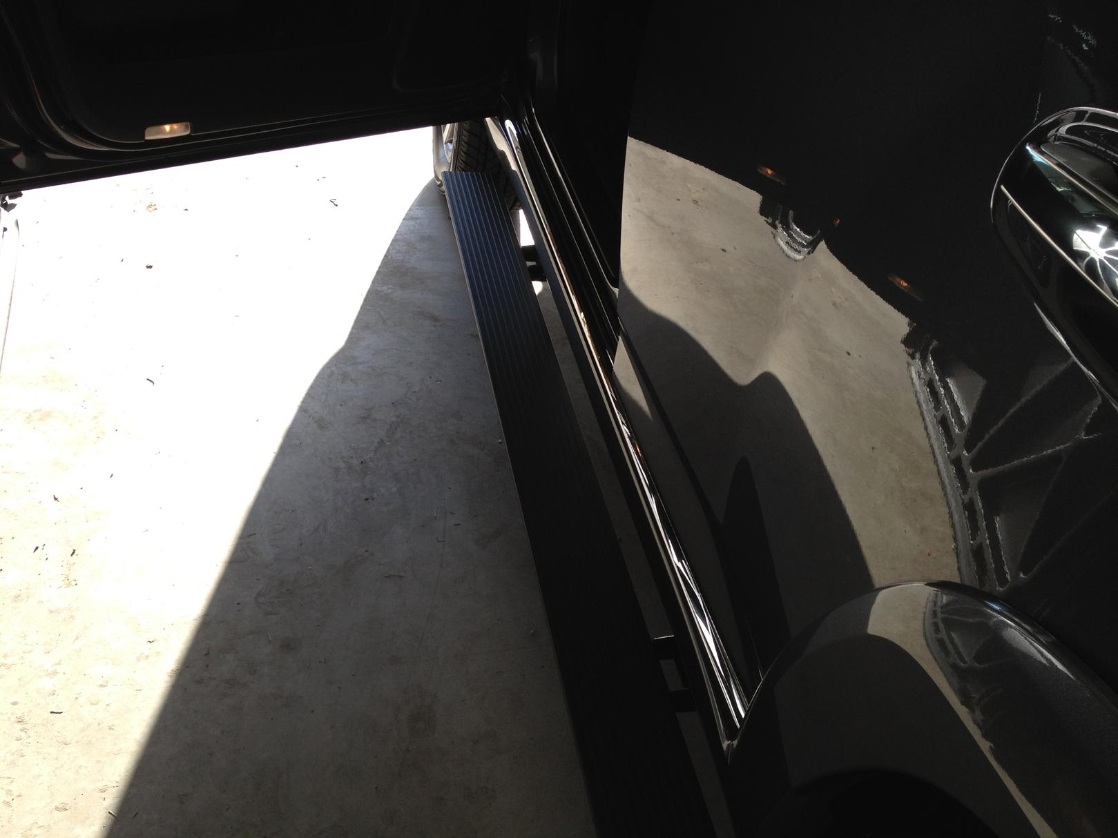

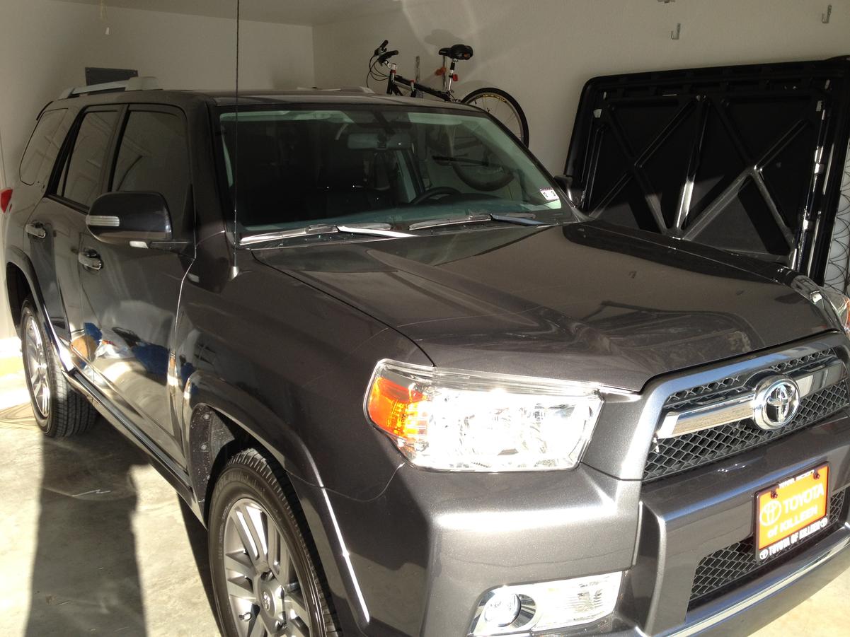

I have the auto running boards and recently purchased the OEM mud flaps but have not installed it because I am out of the area. For those who wanted to see what the running board looks like I attached two pics of the vehicle. It was just a quick snap shot.

Damn, I'm liking those boards. I've only got 5000 on mine. Maybe I should sell it and get a 2012 w/ running boards. LOL. Damn, I already have all my electronic goodies installed in my 2011.
It is nice because it is tucked away so most people don't know it is there until the door is opened. You can also switch it off if you do not want to use it.
Nice rig southman! I have the same LTE with the auto running boards and I must say they're growing on me. I never wanted them in the beginning, but my dealership only ordered the '12 LTE with them, so I didn't have a choice really. However I must say, they're pretty slick. When retracted, they're tucked under flush and you can hardly see them. As soon as you open a door, they deploy at just the right amount of speed and timing to step on or off. According to the user's manual, if the boards encounter obstructions in front or behind them, they'll stop (I forget if they'll move in the opposite direction) to clear the object. And yup, they can be turned off by the switch inside. They feel solid and rigid with the rest of the vehicle. In my humble opinion, I never really cared for the look of the fixed running boards, except for the Canadian type, because they appear to thick and detached from the body. So when I first saw the new auto boards at my dealership, I thought these looked promising.
