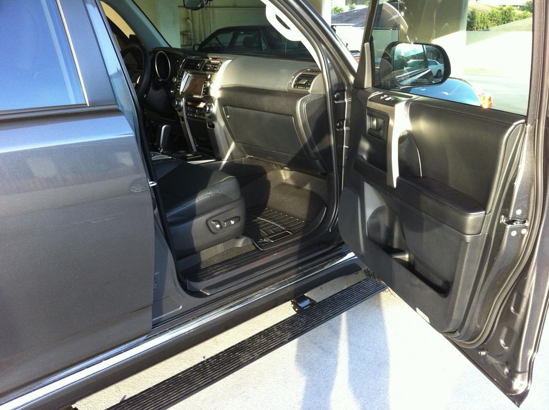

I found a shot of my passenger side board deployed. Sorry this photo wasn't intended to show a dedicated shot of the running board.

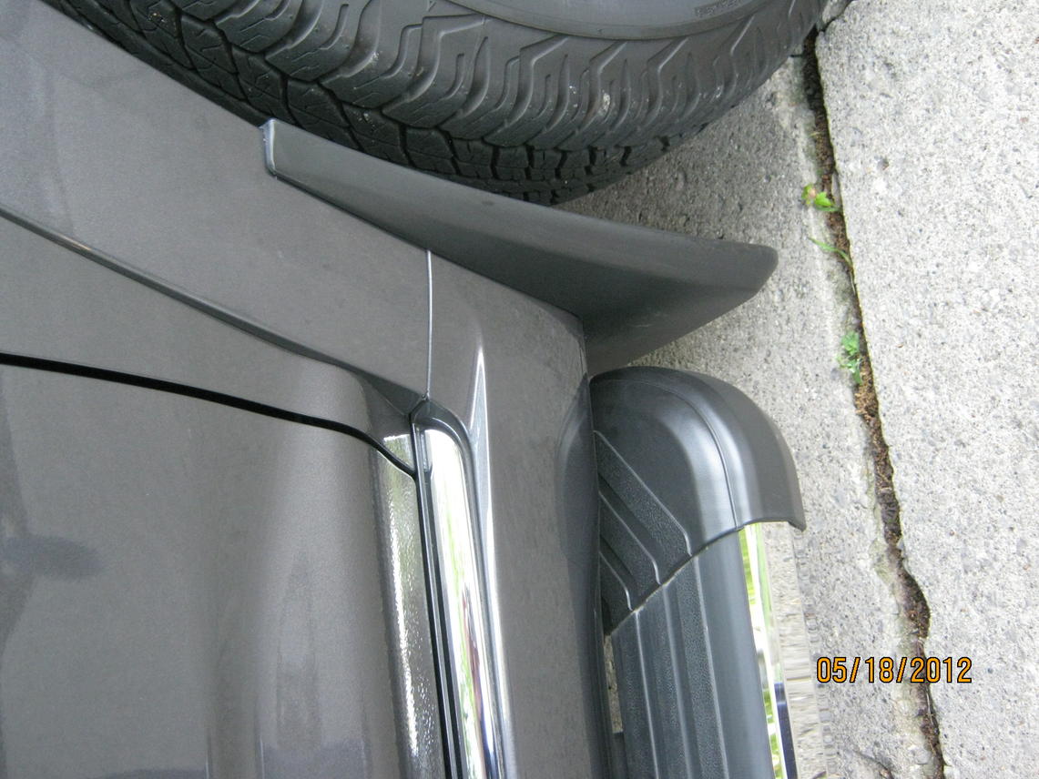

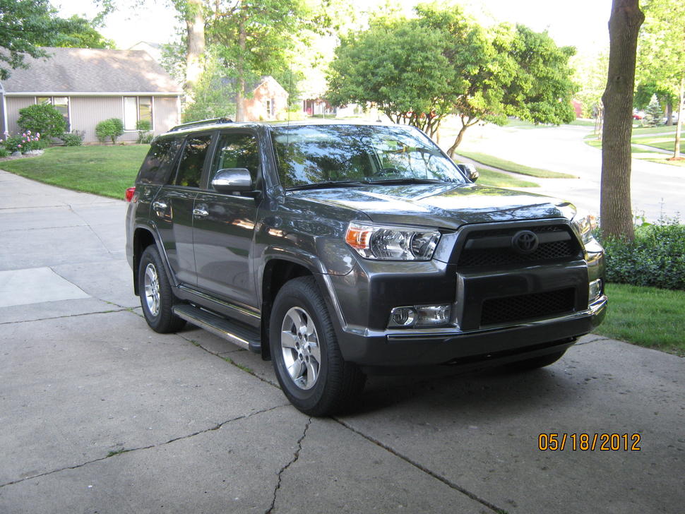

Flaps with Running Boards
2012 SR5 with Toyota Non-Powered, Running Boards and Toyota Flaps. Enjoy.
