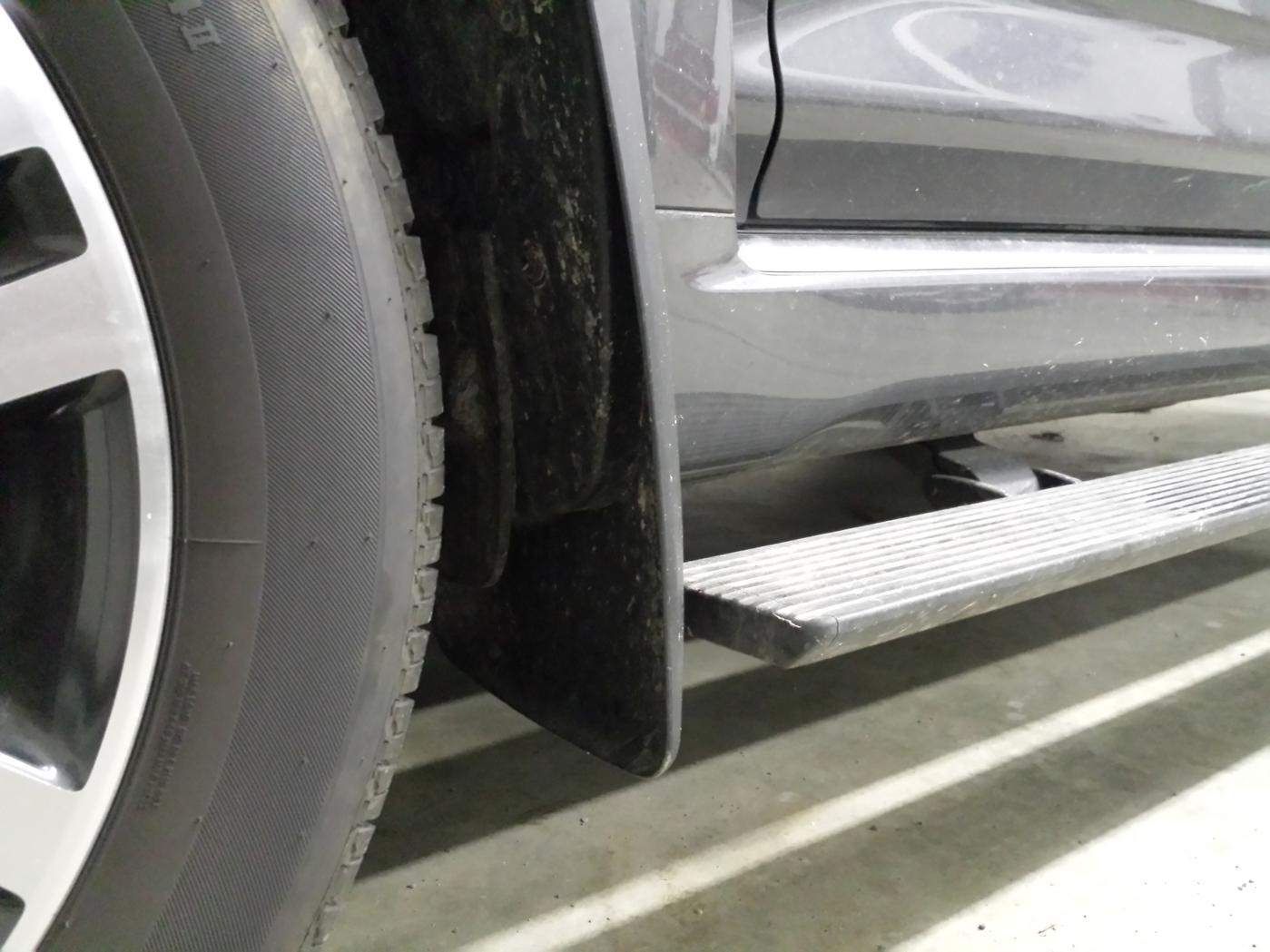

Had it done on my 2014 LTD back in September by Jordan Toyota in Mishawaka, IN, using the instructions on this thread. They ended up breaking heads from 3 of the 8 screws on there boards, which had to be drilled and tapped. All new screws were used for reinstallation of the boards. Also, to get the running board back far enough, the technician had to use a mallet to push the boards to clear the front mudguards.
Let me know if you need for me to take a better picture.

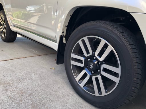

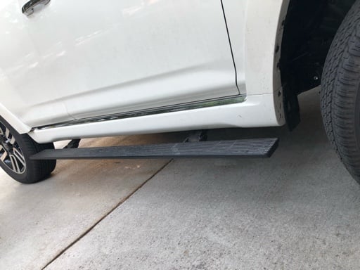

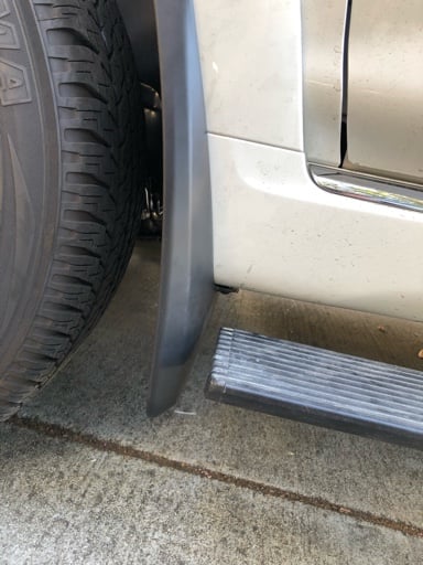

Thank you for the directions on this post, page 1. Very helpful. I installed mud guards yesterday on my '17 Limited with auto running board. The road debris was really injuring the paint on the side of the vehicle. I hope the guards will protect.
I just installed this on 2019 LTD. Also need to slide the running-board back about 1”. You need to drill one hole for a fastener screw. Other than that use the existing push-tab.
