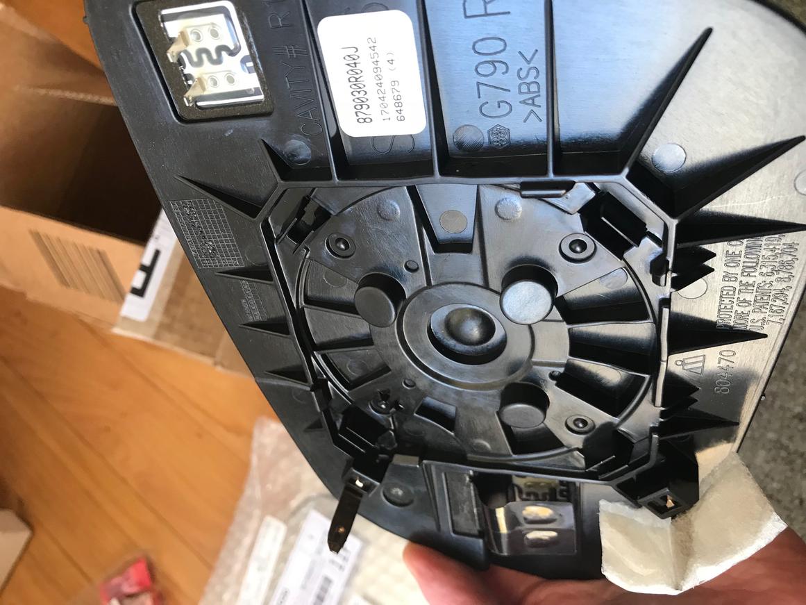

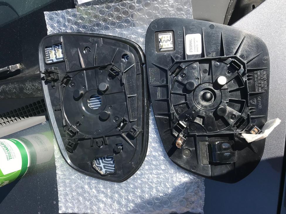

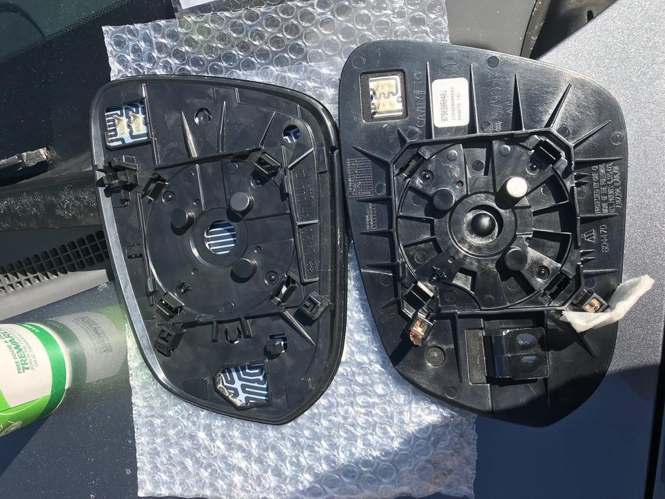

So here are some pictures of the 4runner mirror VS the Rav 4 mirror It feels cheaper than the original and it has strange tabs and an extra hookup. Also the heated element is sideways vs up and down like the poem, which is positive and which is negative, perhaps I got some knockoffs? Help, anyone?
Rav 4 mirror is on right in the first picture. Middle picture is new Rav 4 Mirror, notice all the extra connectors and how the heater connector is sideways vs up and down.
Nothing like being in the middle of an install and finding a surprise such as this. I have not seen any pictures of the back of the mirror so hopefully I have helped someone in the future so that they don't run into the same surprise. If anyone else could post their pictures of the backs if would be greatly appreciated.
looks about right, dont think theres positive/negative. it'll work either way.

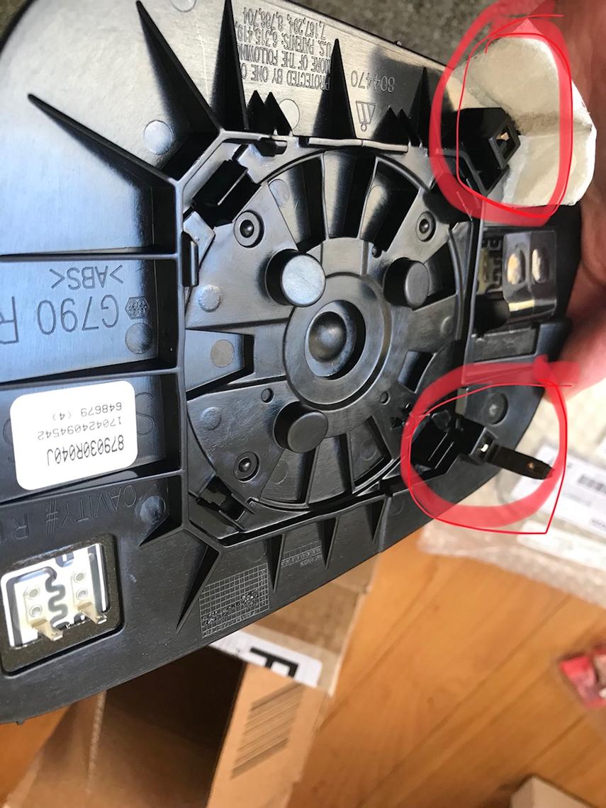

Thanks [MENTION=156753]rayofsi[/MENTION] and all the extra connectors? Especially the super long ones, what do I do with those, cut them off or bend them? [MENTION=124732]LawnDart[/MENTION]
you can remove that. its not a connector. lots of mirrors have them, but the 4runner doesn't use them apparently.
So, I do not see a good way to remove them..... I really thought this would be an easier, more straight forward mod...... [MENTION=44305]weeeee[/MENTION] [MENTION=129593]MTN4RNR[/MENTION] [MENTION=73851]007Tacoma[/MENTION] [MENTION=143083]sbronemann[/MENTION]
Help, anyone who has did this mod! LOL
Help! LOL
You can clip off the extra terminals with a wire cutter or leave them as is. It doesn't matter at all. I left mine as is. Just make sure you aren't clipping the ones the OEM mirror connects to.
Thanks [MENTION=44305]weeeee[/MENTION], talking about these in particular (they did not exist on the stock 4runner mirrors), they are very long and I worry they may interfere, did you guys leave them on or clip them off or bend them? I just wanted to make sure, what a PITA..... Also, as another member mentioned polarity for the heater is a non issue, wire can go on any old way? I hate having stuff apart and then having to hit the forums to get it back together!!!

So I cut them off on the passenger side and then on the drivers side, then I popped the driver side mirror off and it had these long tabs (great!) so I hope they were not important, not sure what they are for....... Looks like heat elements work on both and everything seems to operate okay so far as far as movement etc. I will report back if I notice any issues.
If anybody knows what those long brass tabs are for please let me know.
