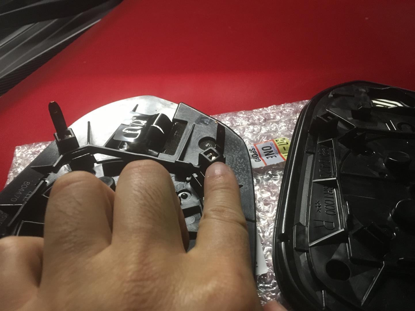

Missing Metal Clips
I just did this swap. However, the original passenger side mirror was missing the two clips (pointing at it in the picture; left is new rav4 and right was original). Did ya'll have it when you replaced it? Just curious.
I removed them. There is a nub on the clips that is pushes in and it come out.
