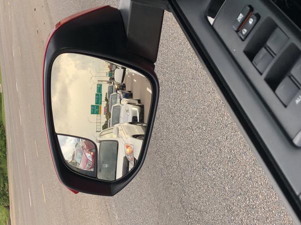

Installed mine last Thursday, still getting used to them, but I love being able to see cars in my blindspots that I wasn't able to see before!
Before:
Old and new
And new!

After a while of using these you'll get used to just looking at the regular part of the mirror and having things pop out at you with the smaller mirror. You will find you really don't need to look at it for it to work.
