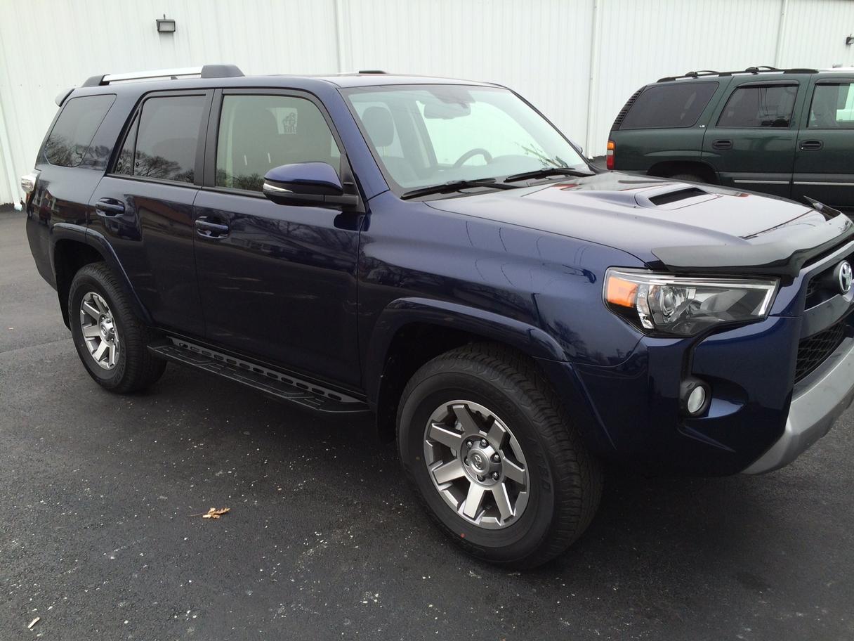

OEM Running Boards for a 2015 Toyota 4Runner Trail Premium. Easy install.

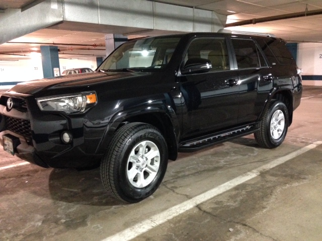

I went with the TE boards on my 2015 SR5 Premium. Same ones you see in the previous post above on a TE. I like the look of these because they are all black, functional, and easy to install. They are available on Amazon for around $350 as of Dec 2014

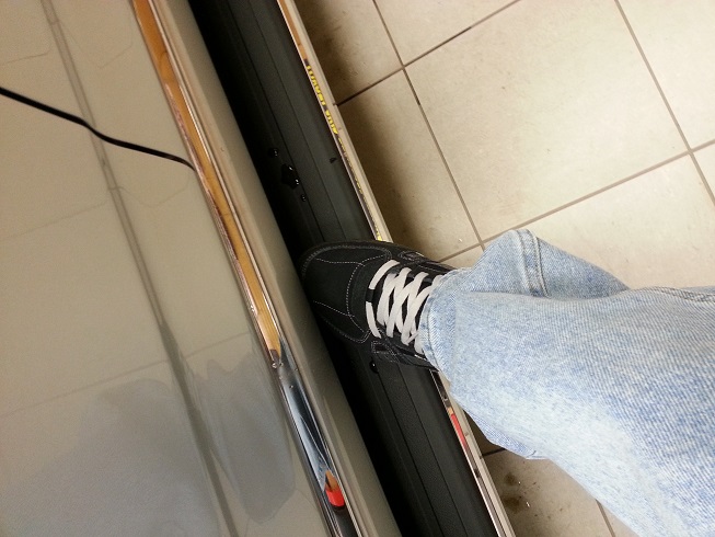

in regards to the R6 boards
1. there is no gap between the lower LE rocker panel and the board
2. in conjunction with #1 above if your foot is bigger than say a size 8 you wont be able to get any decent footing.
in the pic you can see my foot is pushing against the rocker panel since there is not gap to get a decent footing.
my advice, go aftermarket on the LE if you want a useable board. I got them not for looks but for protection of the lower rocker panel and doors during winter.
I actually don't even touch them getting in/out. I just hop into the seat.

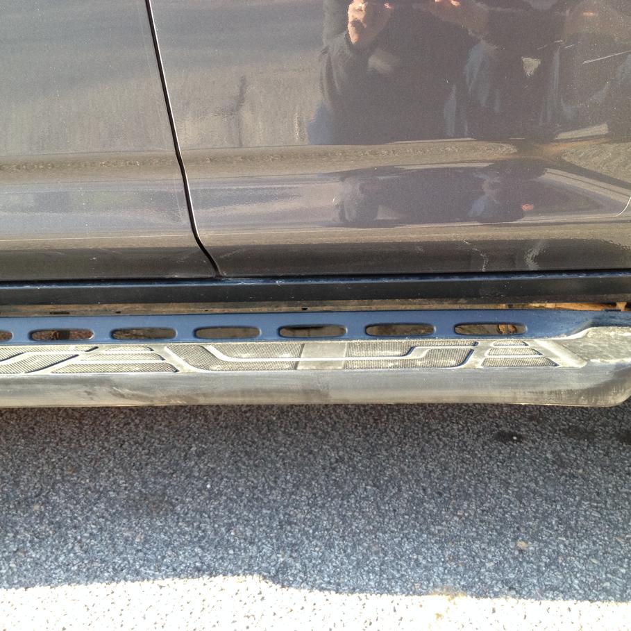

I have a 2015 Trail, which I have had since November, but just this past weekend took off-road for the first time, in the Uwharrie NF. I have the OEM running boards which a friend suggested I remove before running on the trails, but I left them on (the dealer basically gave them to me after I negotiated the deal, so I saw no reason to baby them). I did scuff up the plastic cover on the sides, but other than that, they did ok and the scuffs are not too bad. The OEM running boards on the 2015 Trail have a step surface that is 5-1/2" wide and are about 2" down from the sill, with a stop at the back to prevent a foot from sliding under the door sill. The tread seems to be well made and my foot does not slide. I got them basically to make my wife happy (my first wife insisted I get steps for all of my high trucks), but they are sometimes useful...
If I decide to do much more serious off-roading, I will replace them with aftermarket steel sliders. I traded a 2004 F-150 for the 4Runner, and I had heavy duty after market steel sliders on the F-150 which worked as intended. No body damage on the F-150 in 10 years, but the sliders got plenty of dings, scrapes and dents.

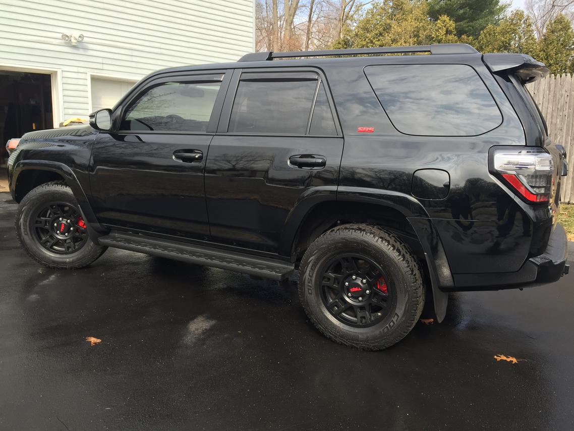

My 2015 came with the slightly longer running boards but always preferred the slightly shorter with the lengthwise billeted holes running along the top. new ones cost about $350-$399 on Ebay. Like others have said, super easy, 6 sets of 2 bolts each, on and off. Update 8/21/15, BTW, I keep getting private messages, the old boards have long since been sold
