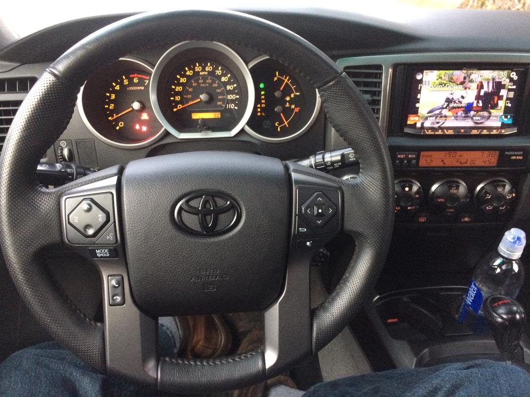

yup
Did this last weekend. Took all of 5 minutes, minus battery time. Switched out the cruise from the new Taco wheel, harness issue with OEM clockspring. Audio connectors from the wheels are different, so it will require a little metering and soldering, etc., but it should be not too difficult. Just a time, hunt and peck thingy.
Airbag connectors are the same, as is ground/horn wire, but I chose to leave out the airbag for now. No faith in the Tockico crap.
Anyway, it's a straight and easy swap. Got mine off an ebay salvage, still connected to the column, which I had them remove. Oh, and it cost $230, plus shipping. Cheap, and I love the feel of this wheel over the stock by a huge amount.
IF audio controls are the only thing holding people back, well...figure it out you brainy electrical wizards. I know I'll do it sometime. Didn't do this before because my attention and money was directed towards my yamaha's, and my daughter. Cheers, G

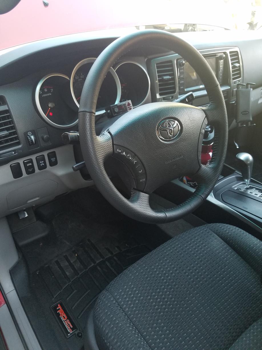

I too went from a Tacoma (2014) to my 2006 runner and am loving it. I did not miss the steering wheel but went with one from a GX

Wow! Nice work, but steering wheel controls mean too much for me. Also, getting a recall fixed airbag would be a major concern for me.
Here is mine. I bought the wheel off ebay and the phone switches online at Toyota Parts Deal or something like that. Completely plug and play with the radio. It's the same wheel out of the 4Runner Trail Edition. Initial feel was still a little plasticky, but has gotten better and is much better looking for the sport interior.
