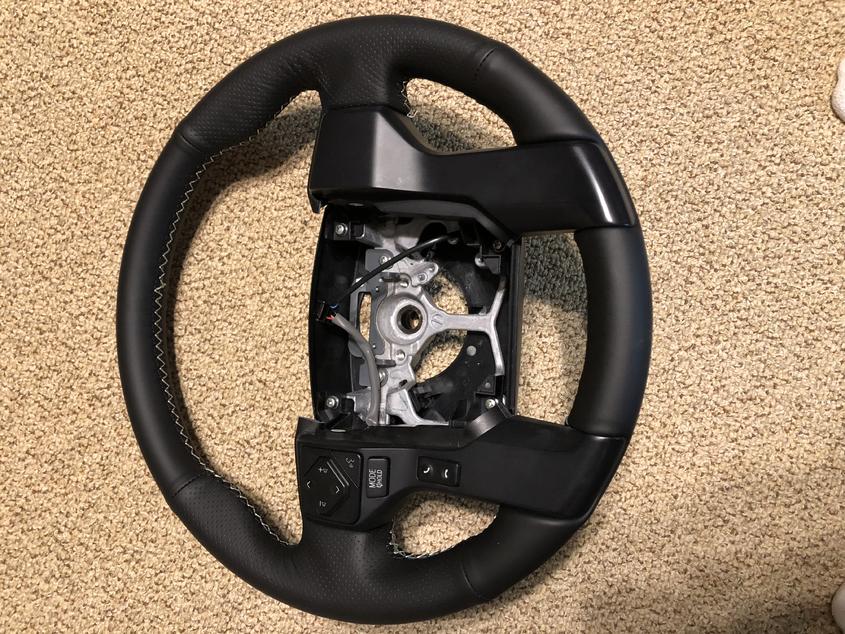

I just finished stitching the leather wrap on the steering wheel. I plan to work on the wiring in the next couple days.

Not doing the airbag. Don't trust them right now. Hooked up Mode control and ground only. Too OCD with everything else, so I'll do the rest once my carport is rebuilt with electrical and lighting. No hurry, I know some of them already work. Alligator clips and hit or miss connections got a few before I stopped and left it alone.
A quick question. I am currently in the process of wiring things up but the wire colors are different. On mine I have a red, grey, brown, and black wire. Were these the same ones that you have? I know you only hooked up mode control but do you remember which wire was for that function?
How’s the steering wheel swap holding up? Any new advice? Did you end up connecting everything else? Thanks!
Did this last weekend. Took all of 5 minutes, minus battery time. Switched out the cruise from the new Taco wheel, harness issue with OEM clockspring. Audio connectors from the wheels are different, so it will require a little metering and soldering, etc., but it should be not too difficult. Just a time, hunt and peck thingy.
Airbag connectors are the same, as is ground/horn wire, but I chose to leave out the airbag for now. No faith in the Tockico crap.
Anyway, it's a straight and easy swap. Got mine off an ebay salvage, still connected to the column, which I had them remove. Oh, and it cost $230, plus shipping. Cheap, and I love the feel of this wheel over the stock by a huge amount.
