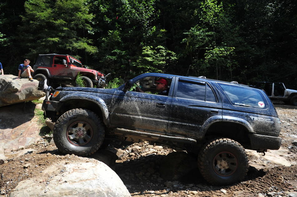

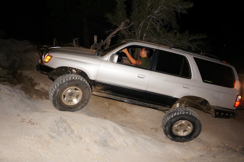

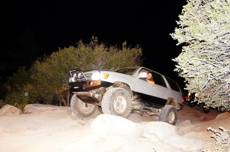

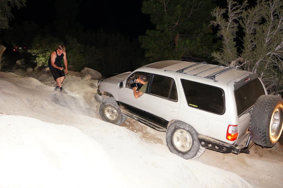

Haha pretty sure I've seen you up in the Wildernest area in that thing. I used to live on North Side Circle right off Ryan Gulch.
I'm going to bet your thinking about this one…

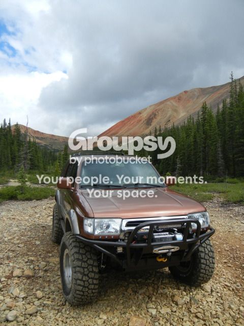

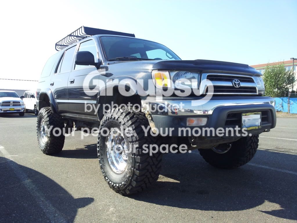

Just got mine installed today, i guess now comes all the fun part of seeing whats going to rub under flex! :hatsoff:
Welcome to T4R! Nice 4Runner. As far as the rubbing goes, EVERYTHING will rub lol. Just gonna have to get use to those noises. Actually, your 3" body lift will help a lot to limit the rubbing. You should be alright.

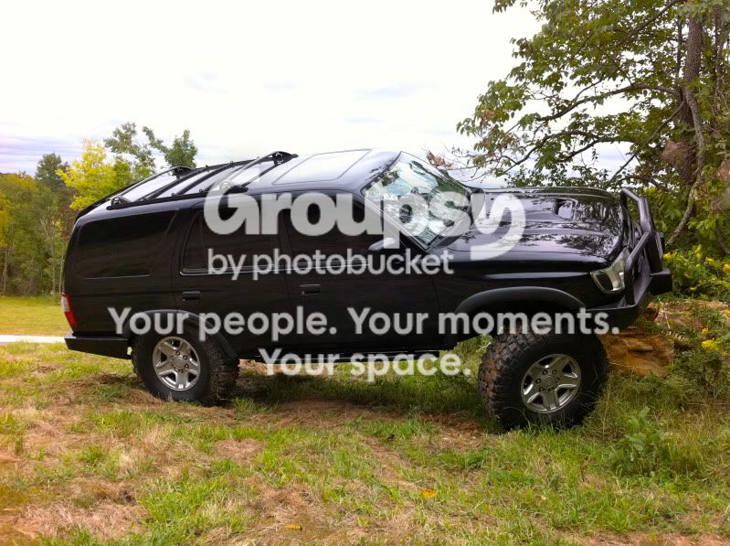

Here's some pics of the "35s" first night out on John Bull. Running with no body lift with minimal rubbing. Rolled back front fenders and pounded firewalls. No rubbing up front besides the frame at full lock.
The rear I extened the bump stops and rolled/pounded the fenders back. Just rubbing the gas tank filler.
Thanks to Brian2sun and J-Money for their write ups in their build threads. I got a lot of ideas from them. :thanks:
Also thanks to Rockdawg84 for the inspiration of fitting the 35s with no body lift. I was tempted to put one on but after seeing your 4runners with no body lift I knew it was possible. :thanks:

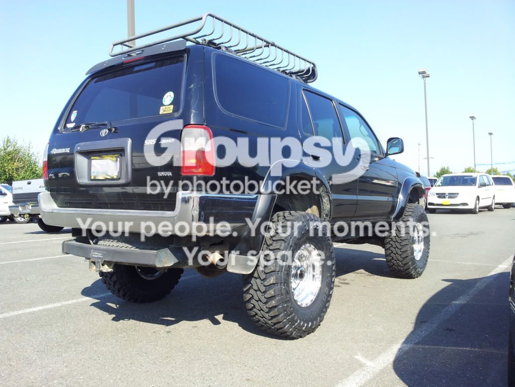

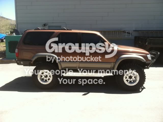

Finally in the 35s club!!
no rubing anywhere except frame at full lock.
3" toytec spacer up front
LC 7s out back
