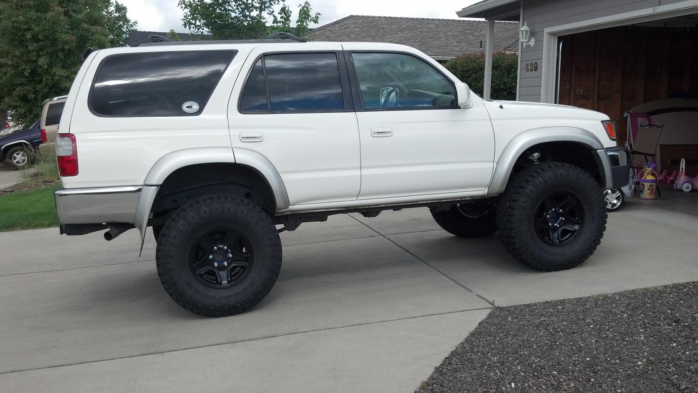

- What wheels are you running? Stock 5 stars painted black
- What is the backspacing of your wheels? Not Sure
- Do you rub the frame at full lock? Yes a little
- Do you rub the UCA at full droop? Probably, not 100% sure
- Are you running wheel spacers, if so how big are they? Spidertrax 1.25"

- What wheels are you running? 17x9 American Eagle
- What is the backspacing of your wheels? 4.5"
- Do you rub the frame at full lock? Yes on both sides
- Do you rub the UCA at full droop? No
- Are you running wheel spacers, if so how big are they? No

- What wheels are you running? 17x7 4th gen wheels
- What is the backspacing of your wheels? stock
- Do you rub the frame at full lock? Yep
- Are you running wheel spacers, if so how big are they? spidertrax 1.25"

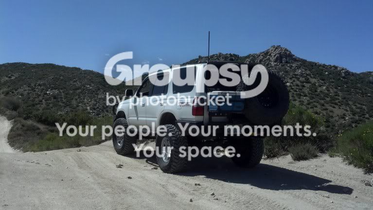

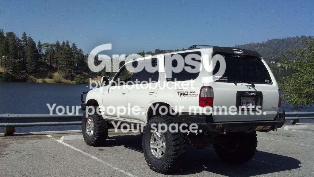

Some 315s run smaller than others. I had cooper STTs and they were an inch shorter than the MT/Rs I have now. The MT/Rs are as true of a metric 35 as you can get (34.75x12.5). The Coopers were about 33.75x12. Both are sized 315/75/16s.
Goodyear MT/Rs..
4runnergregory2.jpg~original
Cooper STTs...
