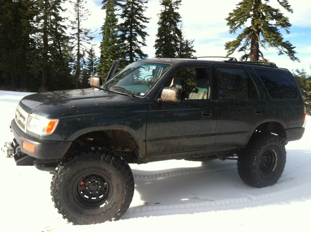

no rubing anywhere except frame at full lock.
3" toytec spacer up front
LC 7s out back
have you went off roading yet? You will rub. I even rub in the rear when I'm flexed out

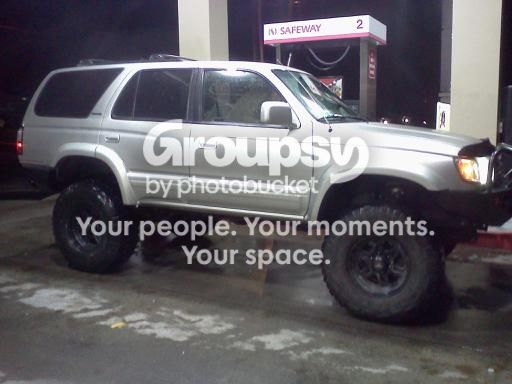

Bad cellphone picture of me going hard at the gas station, but at least on im on 315's now. Got some 40% tread original MTR's to see if 35's will help me offroad as well as they help drain my gastank.
315s1.jpg~original
- What wheels are you running? Pro Comp 98 series 17"
- What is the backspacing of your wheels? 4.5"
- Do you rub the frame at full lock? No, LT arms
- Do you rub the UCA at full droop? No
- Are you running wheel spacers, if so how big are they? Only in rear 1"
- 1" body lift
