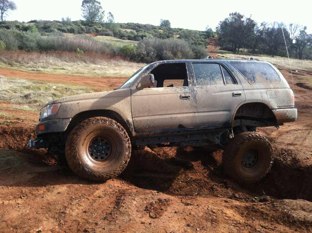

^^^ LOL nice Connor, gotta love photoshop. It's like a 4runningARKRWLRDaily hybrid with a broken CV and twisted rear axle with the custom body-not-on-frame design hahaha
