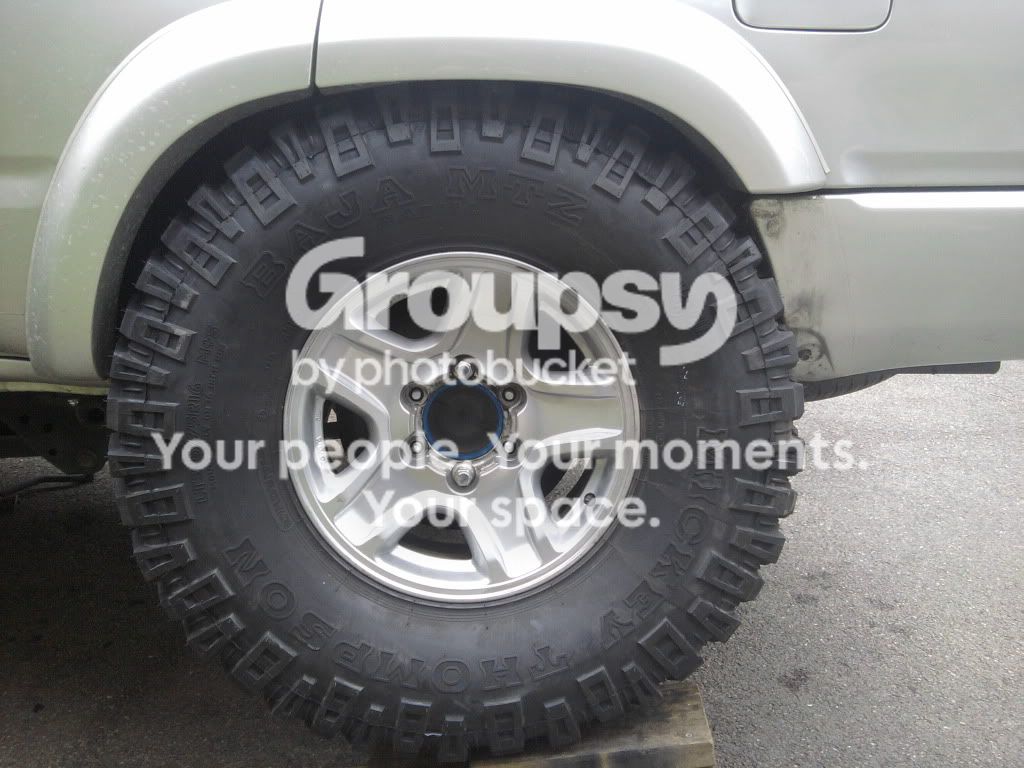

Got the rear done today and ready for them... Barely got started on the front though.
to run what i have now i have stock front with 2.5" block lift, rear is 891 OME and 3" block, and over all a 2" BL. did some cutting and pounding on the front just for good measure. it ran 33/12.5 amazing.
got the 35" and hits a little on the turn when a ways in, going to do tundra trd front and LC 9s back.
and also have 4.56 gears so a little better than stock
EDIT: oh and no rubbing on the UCA because the rims have the back spacing for the 12.5" wide tires. no spacers.
but these things are a B***H to get on the hub... they are heavy and the lugs never seem to be where the wheel is.

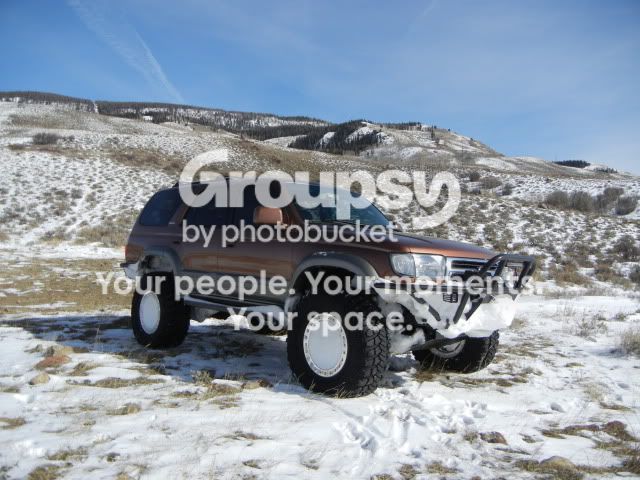

Thanks I've been fortunate to have 2 really nice runners. I love my black 98 but really miss that 99. What part of Colorado are you in. Lived in Ft Collins a while back and loved wheeling in the Rocky's
