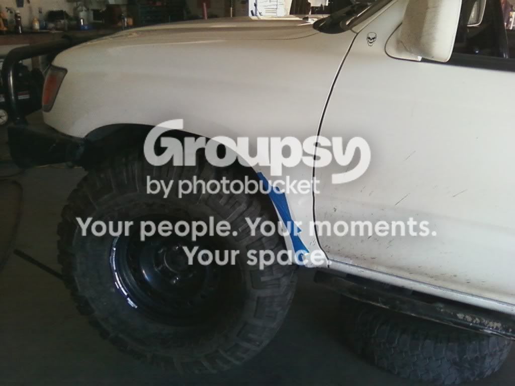

Hey Bandit..... Since yours is similar to mine in the fact that you still have your sport flares do you happen to have any pics of how you modified your fenders?? Just looking for some ideas right now. I started a few rough cuts today but still have a ways to go.
Unfotunately, I didn't take any pics while cutting/pounding. But I did pretty much the same thing that everyone else does, and several others have documented it with pics. I did end up cutting a little off the sport flares too though (just behind the front tires only). Good luck.

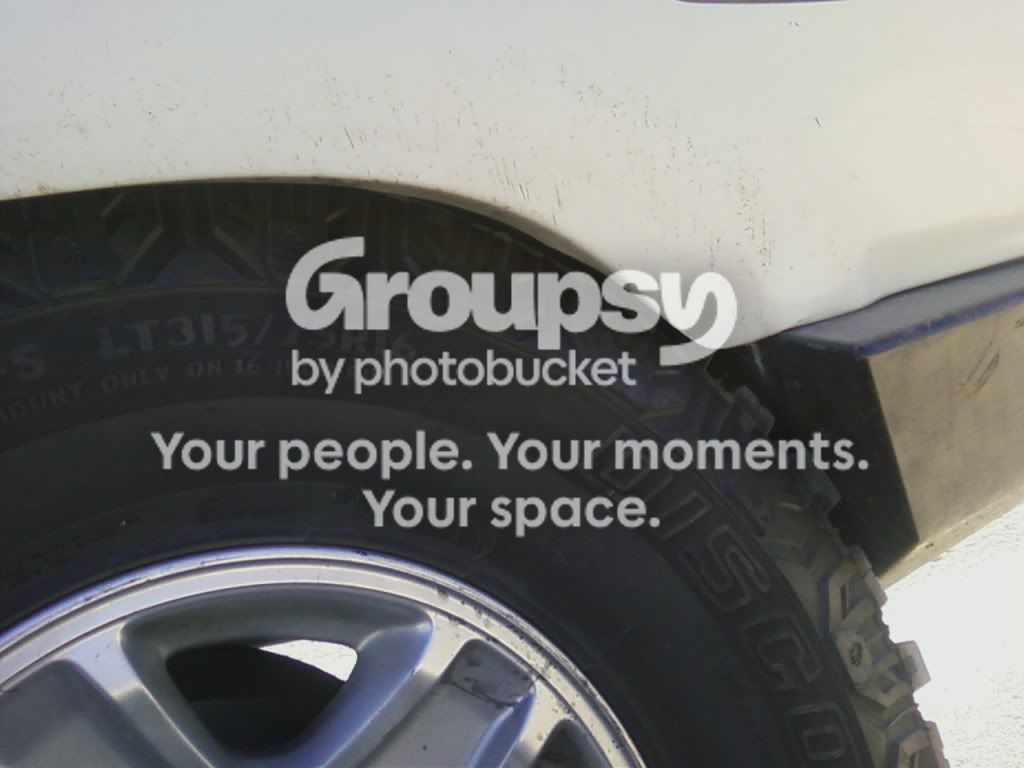

I have the 315 Cooper STTs (they run 34.5" tall and 11.75" wide at 30 psi - as J-money$$$ mentioned earlier). I also have a 1" BL, stock 5 star wheels, and 1" wheel spacers. I do rub on the frame when fully turned, but it isn't that bad. There isn't much I can do about it anyways. I also rub the UCAs when it's fully drooped and turning, but it just wipes the dirt off, no big deal either. But... that's all after I cut my fenders back ~1" and pounded the firewall back about 1.5". That's my 315 MTR spare in this pic BTW. The old MTRs run the same size as my Cooper STTs. The new MTR Kevlars (like J-money$$$ and Dirtco have) are about .5" taller and .5" wider..

After trimming about 2" off the back of the inner lip on each rear fender, the only thing I rubbed in the rear was the gas filler tube cover (in the D/S wheel well). That is until it got torn off during the last wheelin trip. No rubbing anymore. I also extended my rear bump stops 1.5". I cut a 3" rubber mallet in 1/2 and used the 2 halves as spacers..
