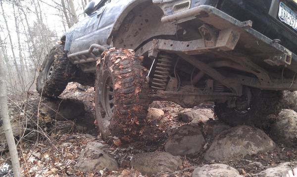

After trimming about 2" off the back of the inner lip on each rear fender, the only thing I rubbed in the rear was the gas filler tube cover (in the D/S wheel well). That is until it got torn off during the last wheelin trip. No rubbing anymore. I also extended my rear bump stops 1.5". I cut a 3" rubber mallet in 1/2 and used the 2 halves as spacers..

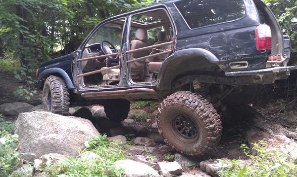

Got it all chopped now and the only place I rub now is the frame at full lock. Stupid frame! So here's a few before n afters.
Front
No where near touching, might have another inch of compression in this pic
Rear (the fun part)
The outer nobs were bending the pinch weld real bad.
I cut out about 1" then of course was left with a wide open seem at the inner fender and outer skin. Gobbed some sealant in there and riveted it all back together.
It's pretty close

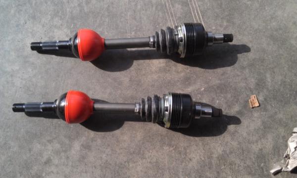

RCV didn't list these axles on their website but I called them and ordered them. I'll try and put some pics up.
The RCV axles bind and make an awful clicking sound in 4WD. Big PIA. They may claim that they are "un-breakable", but Jason at high country 4x4 is running them on his taco and he as broken one.

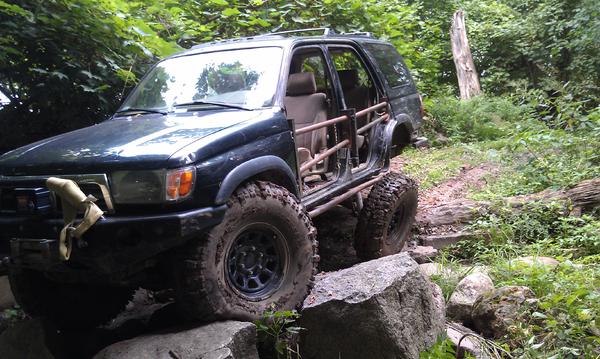

1996 4runner-38.5x11.00 boggers. Shrockworks front bumper and warn xp9.5. Bilstein struts with tundra coils in the front. Arb in the front..Toyota e-locker out back.5.29 gears.All-pro upper control arms and rock sliders. Custom rear bumper. Custom crossmembers underneath-transfer case is not below frame and is skidplated. Auto tranny is skidplated. Longer coils and 2inch spaced in the rear with 12inch stroke shocks. 2inch body-lift. 165 amp alternator and dual optimal batteries. Oasis air compressor. Triangulated 4 link in rear soon and lexan rear quarter windows I'm installing now. When I go wheeling I put my tube doors on and the hatchback comes off. I'm sure there's more. Been building it for a couple years. RCV axle shafts for the front.
