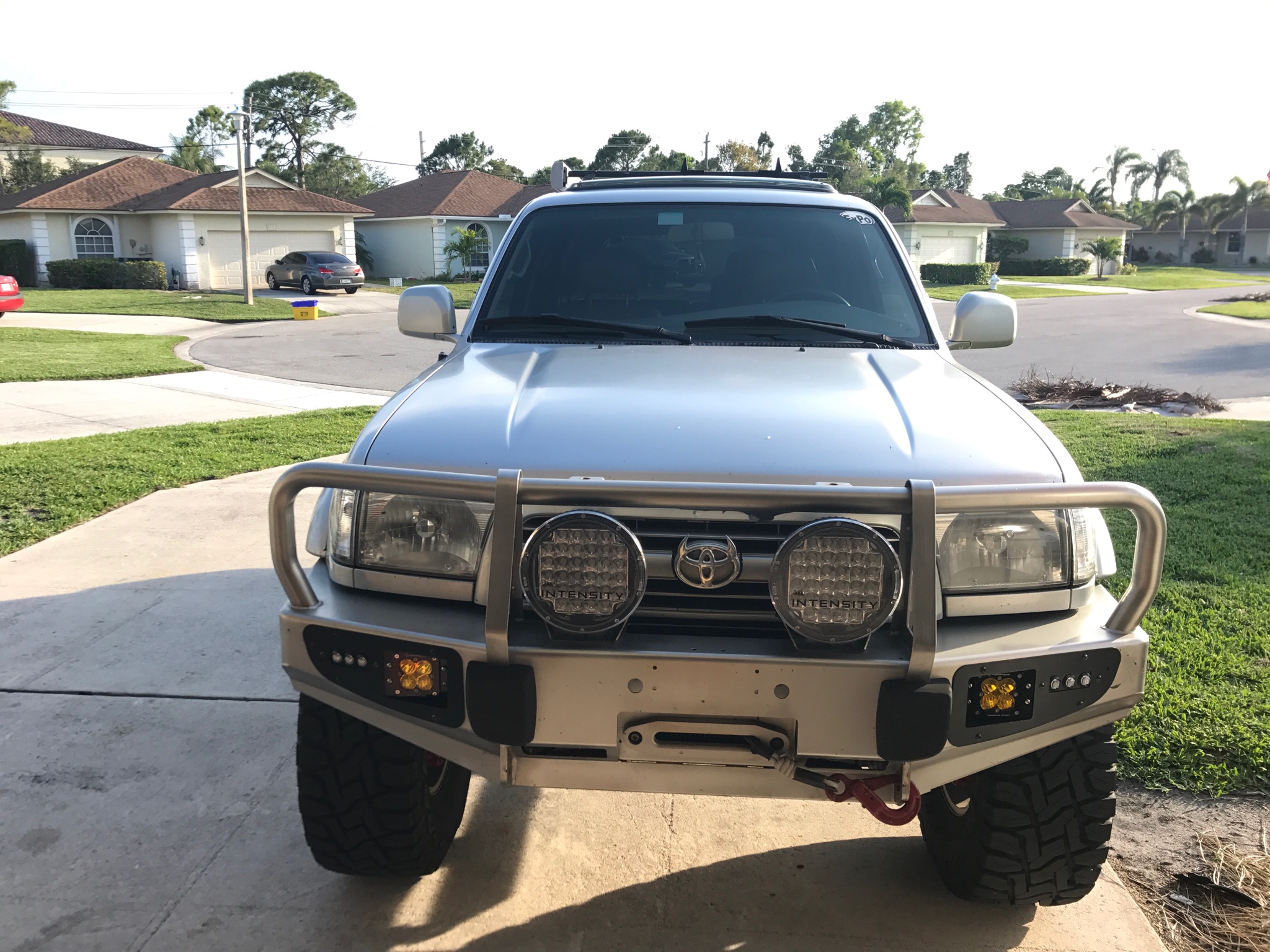

[MENTION=60147]the great him[/MENTION] are those KO2 35's, or 315/75R16's? And do you know how tall they measure?
Actually, they look more like 17's. 315/70R17?

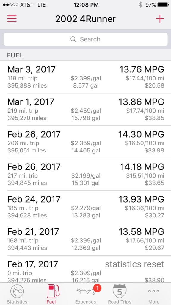

The 4.88's are a good match with the 35's. I live in Florida so it is relatively flat. If I lived in a hillier area the 5.29's would likely shine. But for the flats I imagine the revs would be too high and the speed limited. I had4.56's way back when and that just wasn't enough at all. The MPG have not been good lately but I blame it on the ethanol.
I've seen 15-16mpg with the 35's so I know it is possible. A long trip would prover better economy 16/17 maybe.
What fuel app is that
Sent from my SM-G955U using Tapatalk
