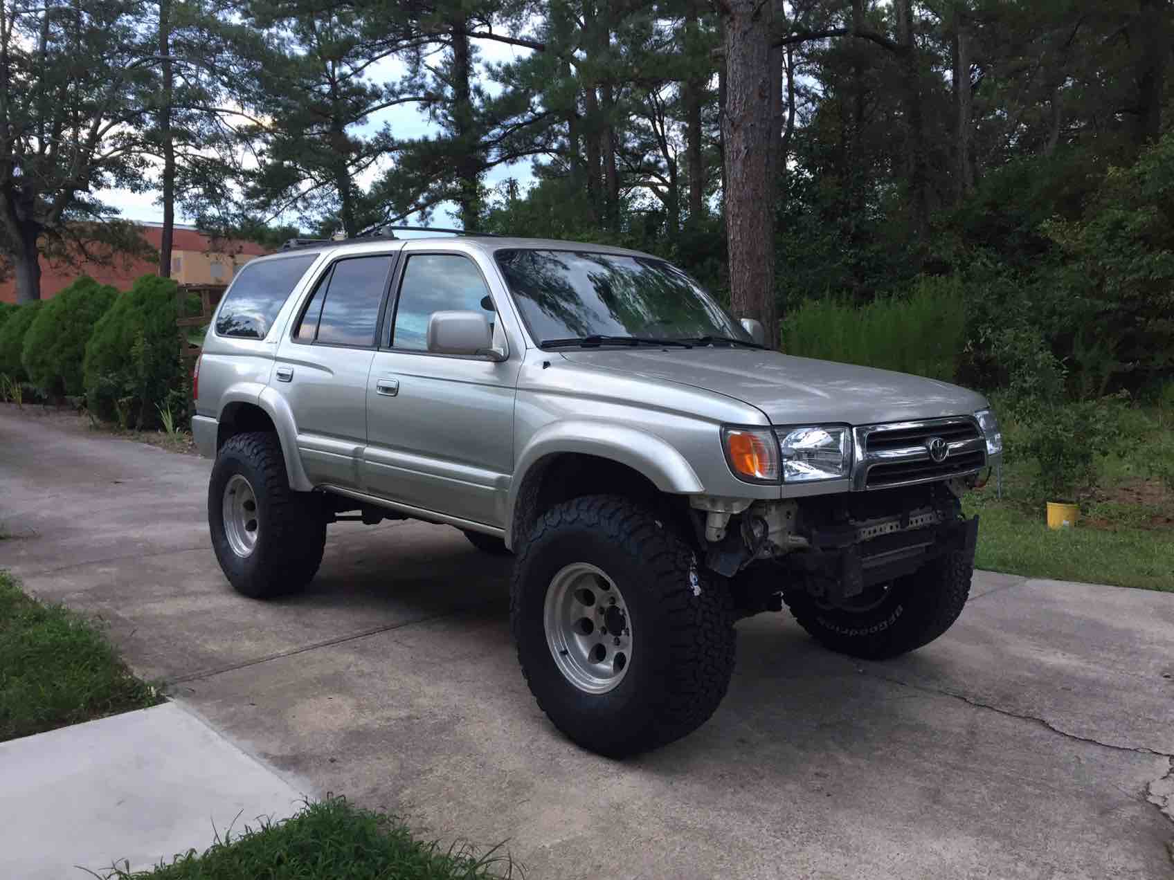

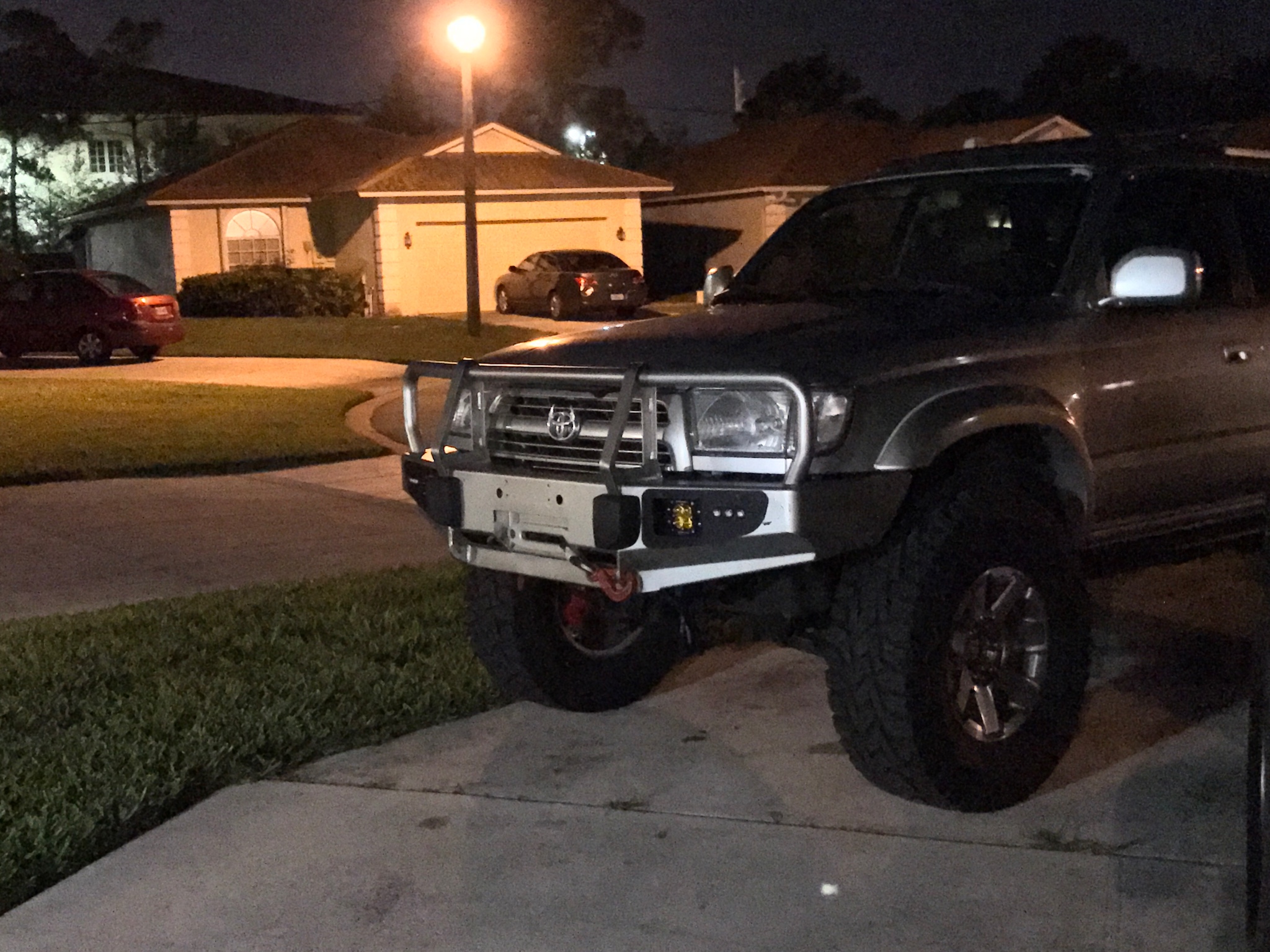

Finally joined the club! I've got a 1/2" body lift, and still have to trim the rear. To eliminate the frame rub I limited the steering a little bit. It still steers plenty tight for me.
Man, that's a nice rig there! If you don't mind me asking, what license plate holder is that from?
What rear bumber is that
Sent from my SM-G955U using Tapatalk
Hey there the bumper started out as an addicted off-road bumper. I had a local shop, Any7Offroad add the quarter panel protection, tire carrier, and frame tie in supports. It is fully welded to the frame now too.

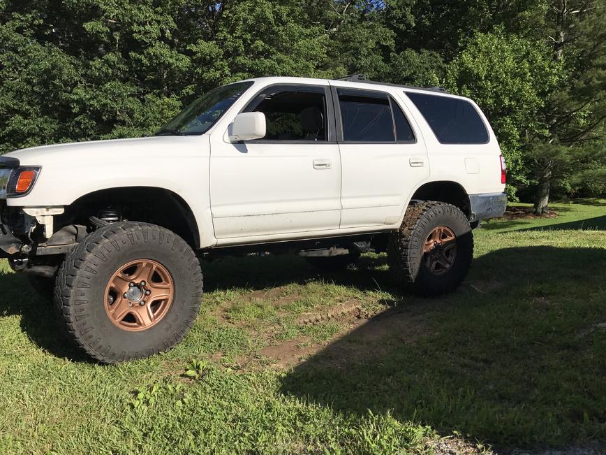

Not the best pic in the world but I am running 35s and that's about as clean as she typically gets :D

did you have to bash the fender in to keep it from rubbing, and do you rub on frame rails at full turn?

[MENTION=143169]Slo.Runner[/MENTION] Looks great! Looks like you got some trimming ahead of you before you take it offroading though. That wheel and tire setup looks awesome!

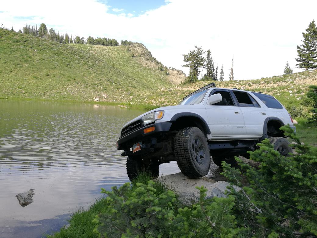

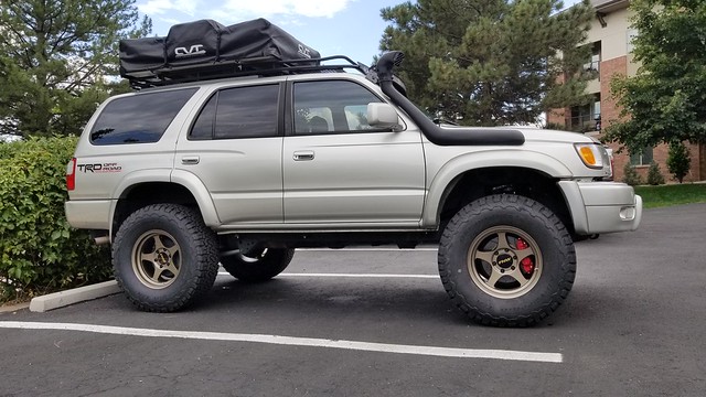

Finally made it to this forum!! 3" toyotec boss lift kit rear ome 890 and toyotec boss shocks and 315/75/16 bfgoodrich KO2!!! No body lift yet and yes it does hit my corner of the fender flare. Waiting on what type of front bumper i should get.IMG_3123.JPGATTACH]263466[/ATTACH]IMG_3125.JPGIMG_3121.JPG

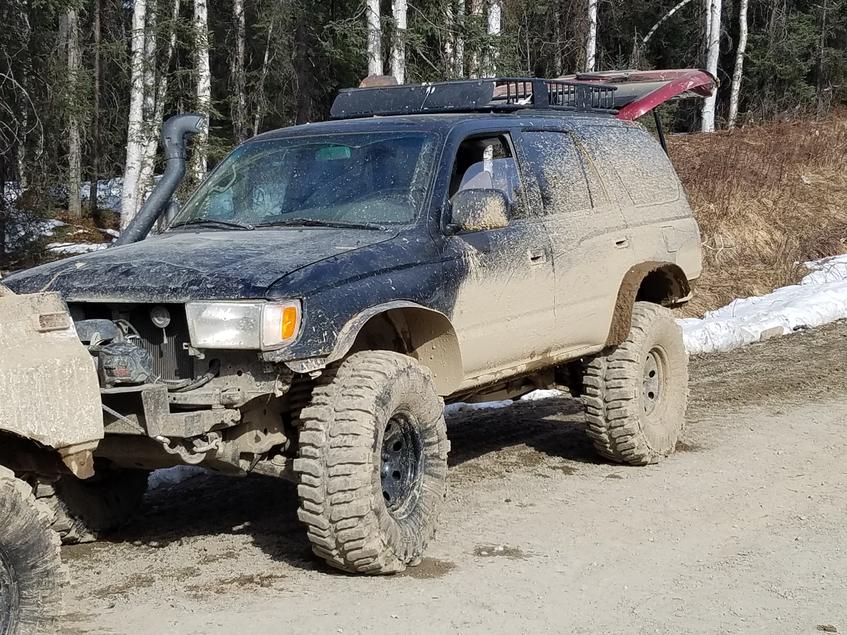

Something most people can't say running 35s is this
I DON'T rub full flex+ full steer with 35's with ZERO body trimming (As long as you don't count the front bumper)
I have ripped off my sway bar backets ~10 times and broken my front cvs roughly the same number of times until I did ~2 inch diff drop

~2inch diff drop? I haven't heard of this, can you explain? are you stacking up the 1inch spacers?
I originally started with running somewhere around 52 washers from lowes(along with the extended bolts) which was a little over the 2 inch drop, this worked great and I didn't have any issues with it even doing some serious rock crawling and decent bouncing.
I switched over to some 2 1/4 by 1 inch solid steel spacers because my neighbor is really cool and CNCed it for me for free.
The reason I had to do this was that I was chewing up front CVs like mad. Big lift + really bad angles = a different kind of breaking axles. The way axles broke for me was due to extreme upwards pressure build that the cvs couldn't correctly rotate with and then hitting the gas and they would shatter and bend the diff slightly... when they break this way it sucks super bad and you can't move your rig at all until you remove/replace it.
On 31s I could break axles of wheels that were in the air if that gives you a bit better of a perspective.
Here I am kicking myself in the arse wishing I would have taken more pictures... I finally did the diff drop when I switched to 35s because I broke my CV within 30 seconds of the first time wheeling with them (this reallllllllly pissed me off) and motivated me to finally try something to fix the angle just a little bit so it didn't do the upwards binding thing.
People also sell kits online for 1-3 inch diff drops but I don't think anything past 1 inch works with the stock skids (at least very well)
