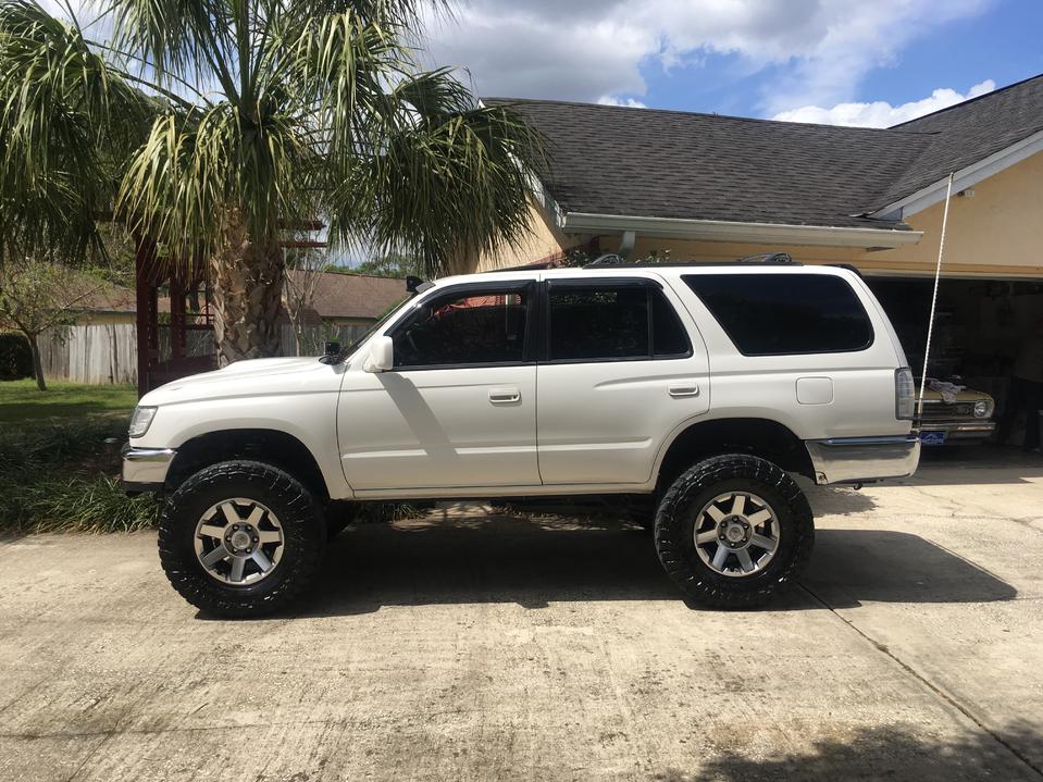

Off topic, but 1.5" or 2" body lift with 3"+ suspension lift. I have a 1" now and it rubs.
35" General Grabbers X3's on 17x9 American Eagle Alloys Series 023, l/t with ~4" of lift up front, 3.5" lift springs rear.
C1FBD6AE-B21A-468A-82E1-38B3CBB9A60C_zpsm5zrtolq.jpg~original
EBF792CE-D336-4D08-811F-593D4866BC05_zpsjszdswch.jpg~original

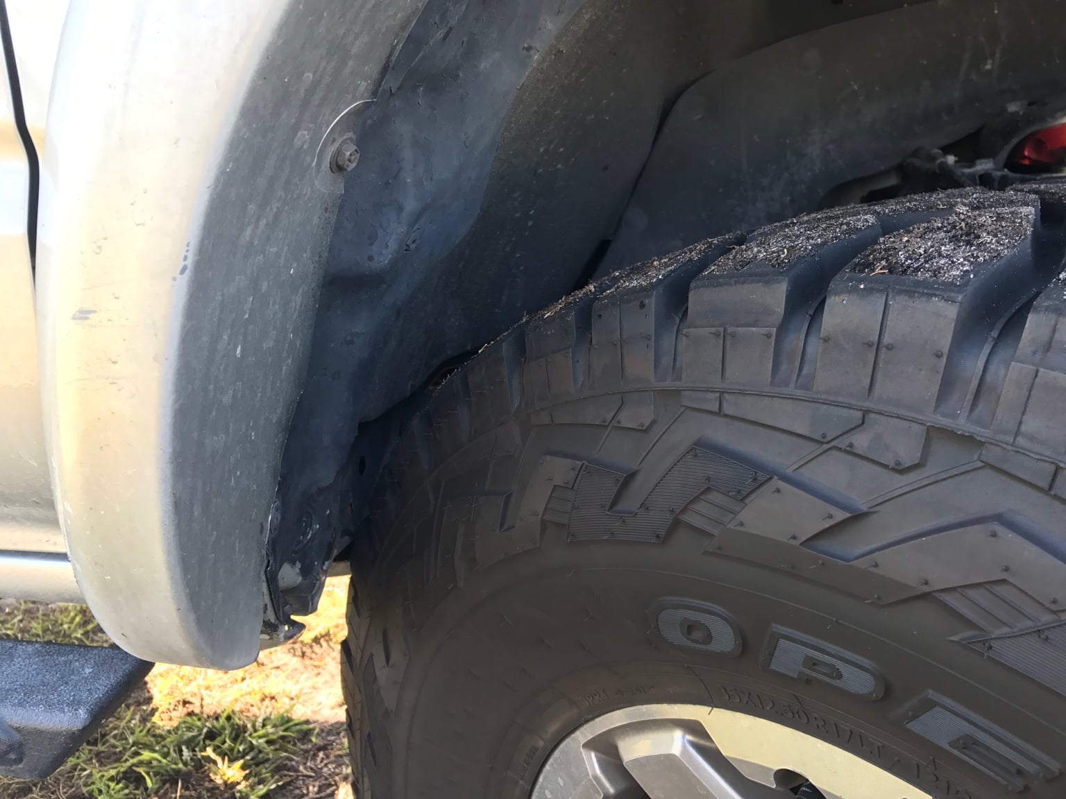

Stock UCAs? Where does it rub?
Passenger side normal driving here (see below).
I had if off-road the other day and other that that sport it really wasn't bad.
