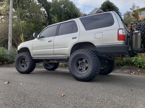

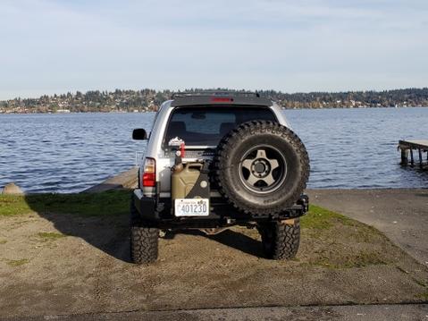

I figured I should probably include mine now,
Although I find it ironic that this list doesn't include what lift setup us on the truck?
I believe stock coils all around, bilstein 5100's on top perch up front, and 2" spring spacer in the rear
What wheels are you running? American Outlaw, I forget the model exactly. 16x8 -0
- Do you rub the frame at full lock? Yes
- What specific tire size and brand are you running? 315 75 16 Cooper Discoverer STT Pro
- Do you rub the UCA at full drop? No
- Are you running wheel spacers, if so how big are they? Yes, 1.25" front and rear
- Are you running a body lift, if so how much? Yes, 2"
- Auto or manual, and what R&P gears are you running? Auto, stock 4.10

Another Oregonian. Welcome.
Looks great! I think that the reason suspension isn't really a factor is that no matter what suspension lift you have, IFS still goes through the same travel and so tubbing and body lift make a difference, but not suspension, so for 35's to fit they have to fit on stock suspension through 4" of lift. But it makes a world of difference how it rides and drives.

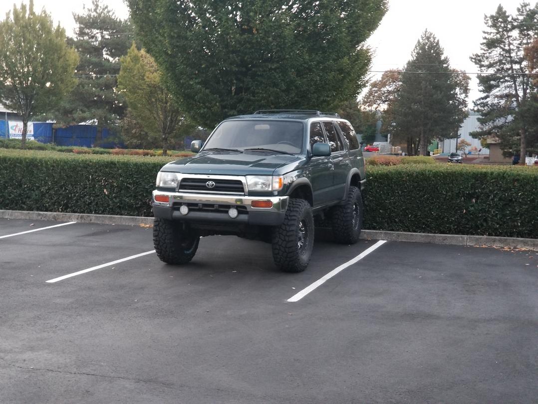

Just put these on and will update once I have more time with them.
What wheels are you running? SCS 16x8 F5's w/ 3.5 BS.
- Do you rub the frame at full lock? No.
- Are you running wheel spacers, if so how big are they? No.
- Are you running a body lift, if so how much? No.
- Auto or manual, and what R&P gears are you running? Auto, 4.88 Nitro w/rear ARB locker

Where you hiding that body lift son? Lol. Looks great!
Right?!? It has a bit more static height in the front than I want to end up with, but I am digging it for now. And at least I am not rubbing things to hell till I get it properly cleared. And thanks for the compliment.
