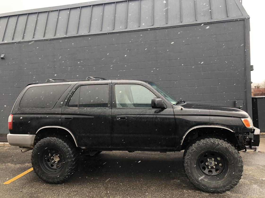

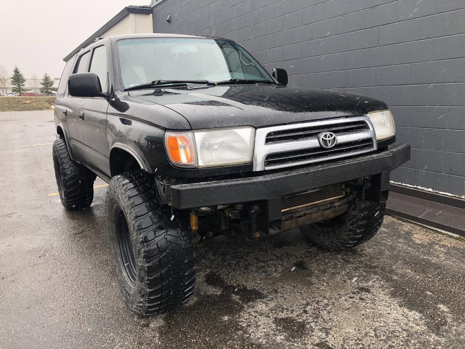

How to limit steering angle?
How do I limit steering travel?

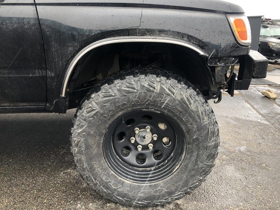

I too want to do this as I just mounted up 315/75R16s (see pic) and have done some trimming and clearanced the inner fenders but want to take some
Steering travel out?
Are the stops on the a-Arms or was it a mod to
The steering rack itself?

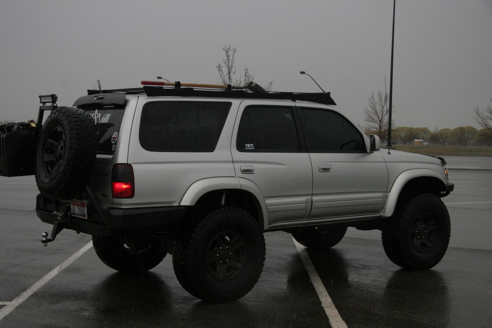

Here’s mine, just got them on!
Old Man Emu 3” lift
882/n91s Front and 890/n86 Rear
35x12.5x17 Goodyear Wrangler MT/R Kevlar
17x9 4.25” backspace Pro Comp Series 97
No body lift (2inch toytect going on very soon)
No spacers
Rubs frame at full lock
Had to trim fenders behind front tires where they meet side skirt
Rear tires do not tuck and also rub bumper a little when flexed.
Need to make rear steel bumper.
Well see how things are after body lift, but might check out some pucks for springs to clear the frame up front and allow little more travel in rear since they don’t tuck.
Gears stock 4.30. Will install 5.29 thirds soon.
Not practical for gnar off-road yet but as is great on roads and light off-road.
Not daily driver.

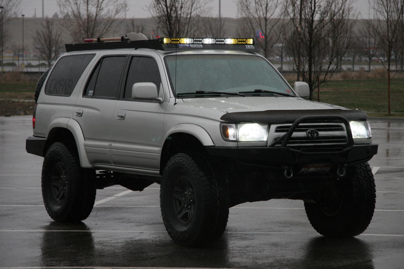

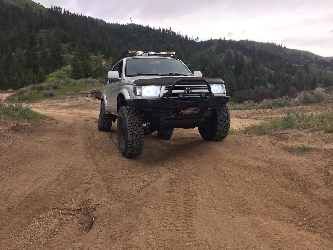

I have SCS F5's 16x8 w/ 3.5" BS, SPC UCA's (already set to 'G' for firewall clearance), no BL (prefer not to run one), and SS rear extended bump stops. I also have an AOR front plate bumper 4X Innovations rear bumper, and Stubbs sliders. I don't have any fender flares.
I see that some, not all, end up having to cut their front fender to widen up the wheel well for up-travel. I understand that there is a high likelihood that I would need to tub for clearing suspension cycle and relocate the washer fluid bottle, but how much body cutting is necessary. I also see people talking about doing the same, or rolling, the rear wheel well lip to keep the 35's from grabbing the body.
I keep reading that 3.5" BS is 'ideal' for fitting 35's, but it would seem to me that they might be MORE likely to contact the body. Am I missing something?:peep:
From what I see, none of my armor seems to be in direct conflict. I have not heard of anyone having issues with their AOR front bumper, 4X Innovations swing out, or Stubbs sliders getting in the way.
How much work am I looking at for no BL? I get the tubbing and water bottle relocation, but how much body modification might be needed with 3.5" of BS?

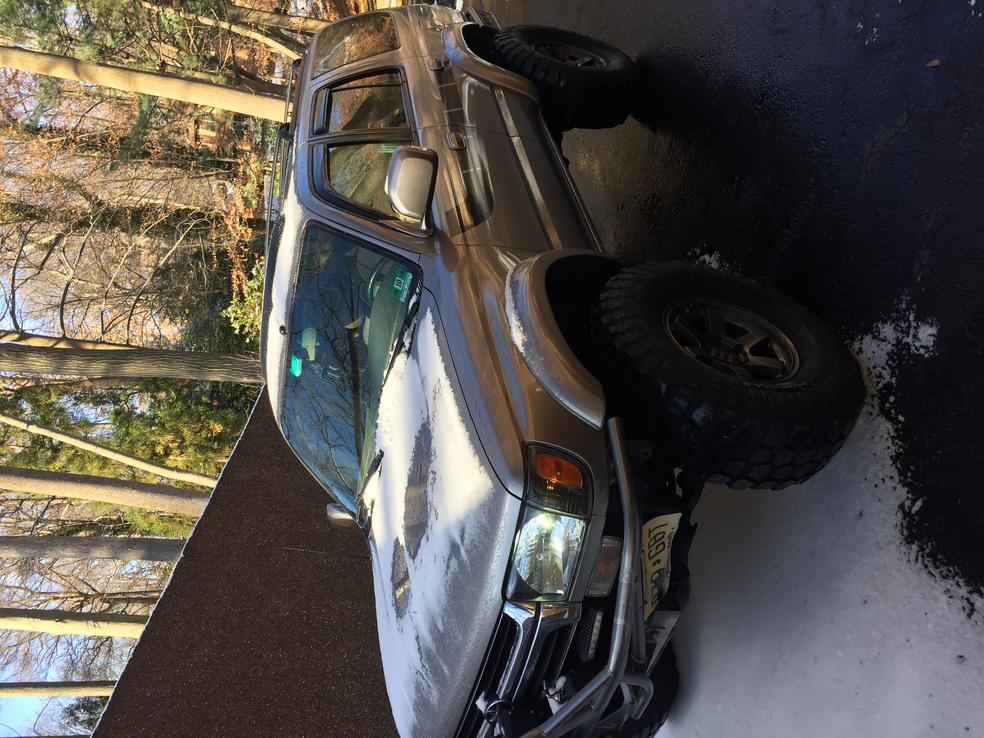

I added a 2” Body Lift and still rub the firewall at full tuck. I will have to investigate a bit further and see if a firewall cut and weld will be necessary.
I see a tub job in your future. What upper control arm are you running?
