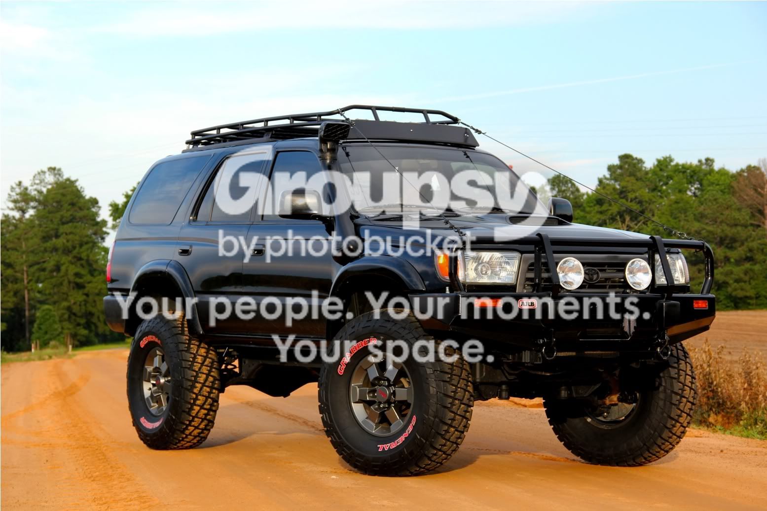

Throwing this up for the guy that owns it now
