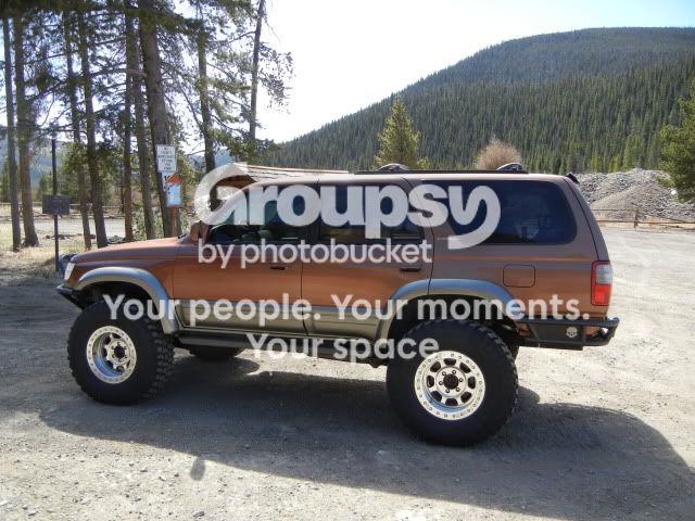

Never heard of someone running anything bigger than 35's with IFS on a 4runner, except for Flexinc when he had the drop bracket lift. Thats nuts. Can you post pictures of the 38's? the pictures on the previous page just look like 35's to me... :shrug:
I put a couple pics in my photo album. They are 38/11.00/16. Tires have mabye 30% tread left and suspension is about three years old. Doesn't sit as high as it used to. Frame measures 22 inches high in the center with 20 psi in the tires. I'm gonna be at rausch creek may 12 if anybody wants to go.
