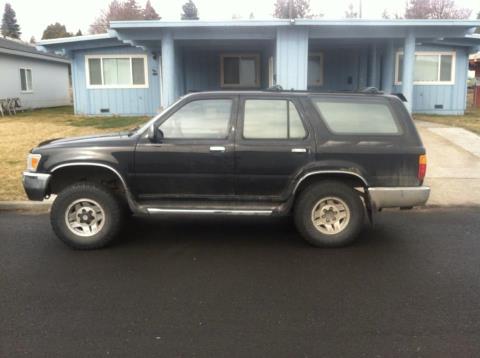

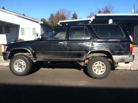

Here is my "rig"
91 SR5
3.0/auto
factory 4.10 gears
open diffs
factory ride height
32x11.5 Swamper SSR on factory 15" wheels
new CVs
Warn manual hubs
Hopeful for exhaust and bumpers soon

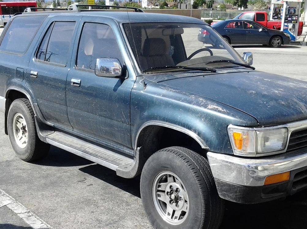

1994 four runner with tons of rear sag. Bout time to fix this and have researched a fair amount about possible solutions. Being on a college student budget I am thinking of Moog C255 replacement springs. Eventually I may want to add coil spacers on top of those down the road. With the new Moog springs in the rear will I be able to fit 33X10.50's on it with little to no rubbing? Anyone have any pictures of this upgrade? Also, by no means am I a master mechanic, but feel confident enough to tackle this by myself. Anyone have a link or any tips to help with the installation process?

You can fit 33s with some hammering/pounding. If you plan to lift it in the future (such as spacers), do it right the first time. Search around for fj80 landcruiser coil swaps for 2nd gen 4runners.
I'm running them on mine and I am around 3.5" of lift now that they are settled, and they flex like a mofo.
I'm buying a set of fj80 coils in a few days. With all that lift in the back what did you do to the front of the 4runner?
Ball joint spacers, diff drop, and slight torsion bar crank (not enough to really feel though)

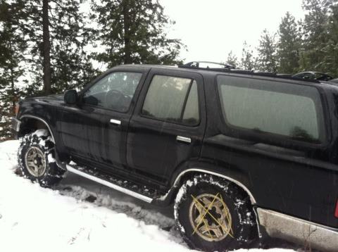

This is it sitting on 31s

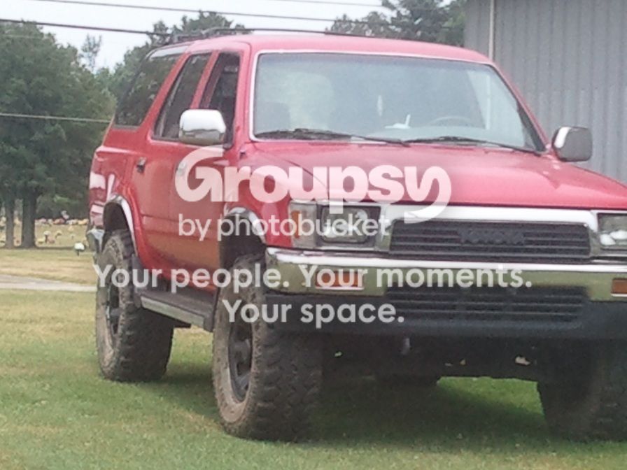

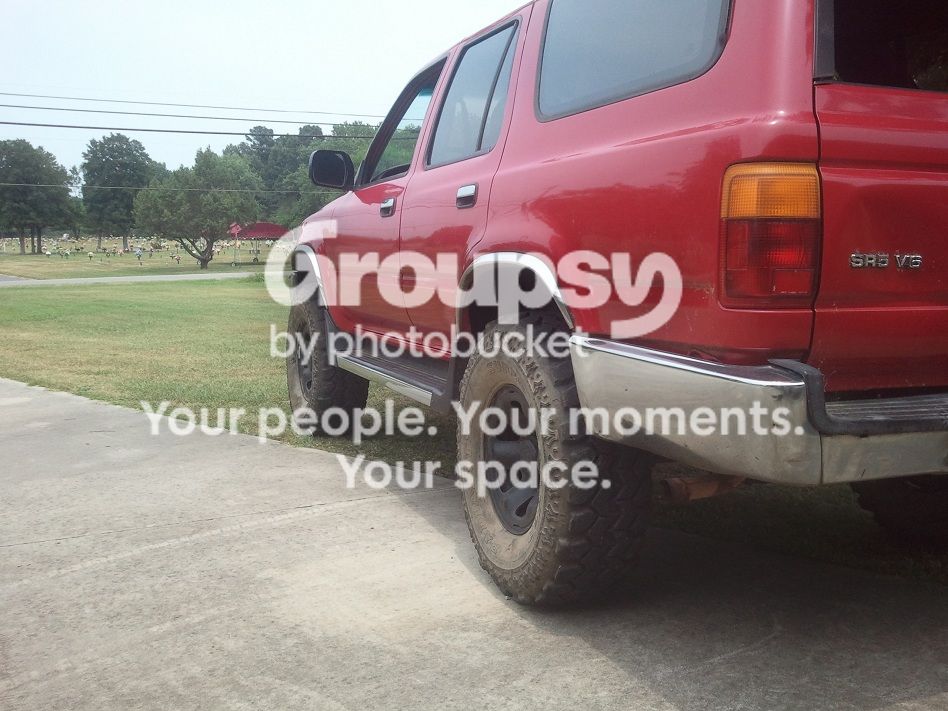

Got my fj80 springs in and it lifted the back end just shy of 5". It looks much better. Have not done the shocks yet and am assuming my Rancho 251D shocks are maxed out and therefore not being utilized? Any suggestions on a reasonablly priced shock that will make the ride a lot smooth because right now it is very rough. Below are some pics...Thanks for all the help yall.
