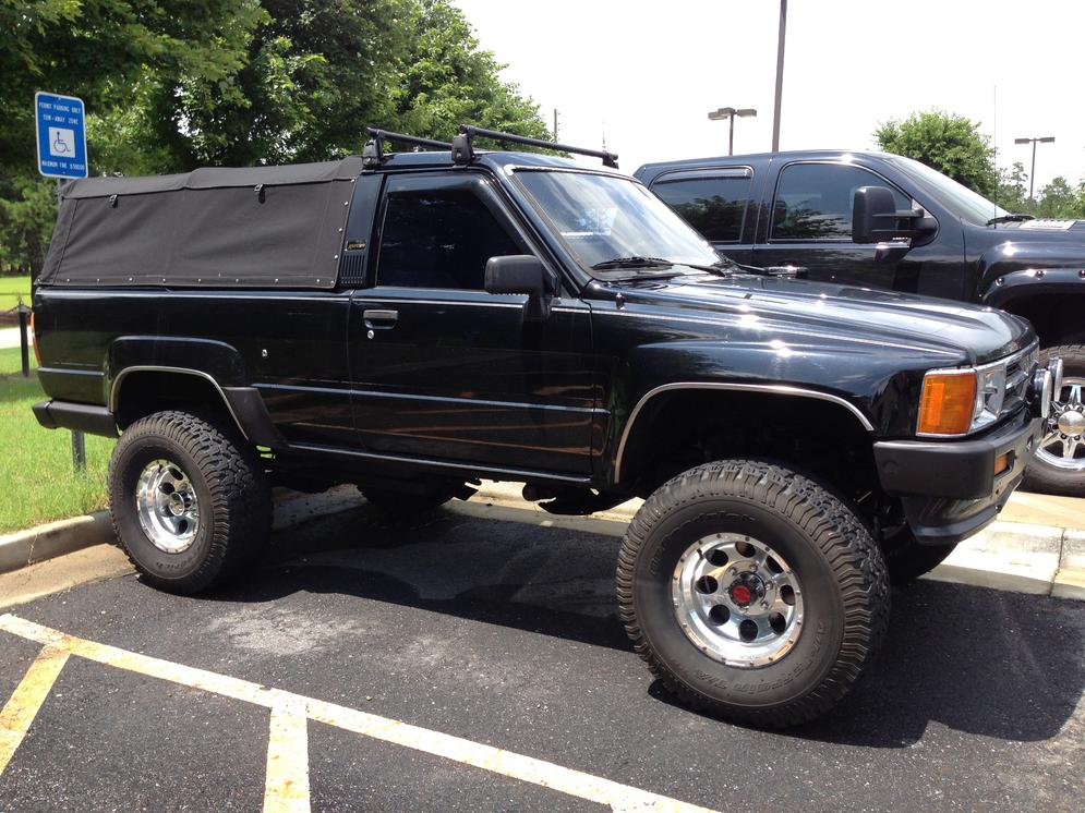

1986 4Runner
32" Geolander yokohama's torsion bars cranked and rear shackles 2" over stock.

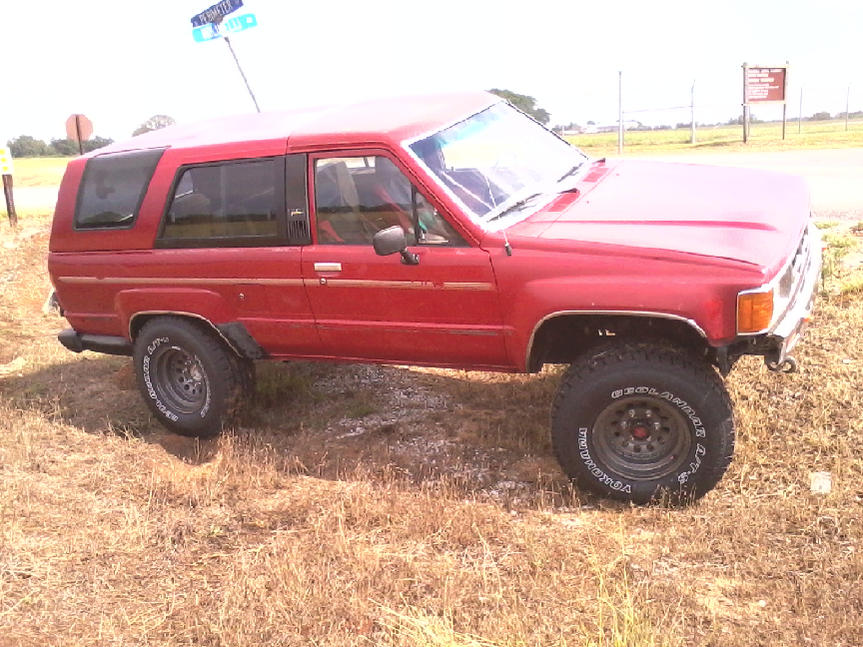

Little Red's replacement
1998 4Runner 2.5 lift 32" Geolander Yokohama's. Hey I like the tire. It works well off road and last on road.

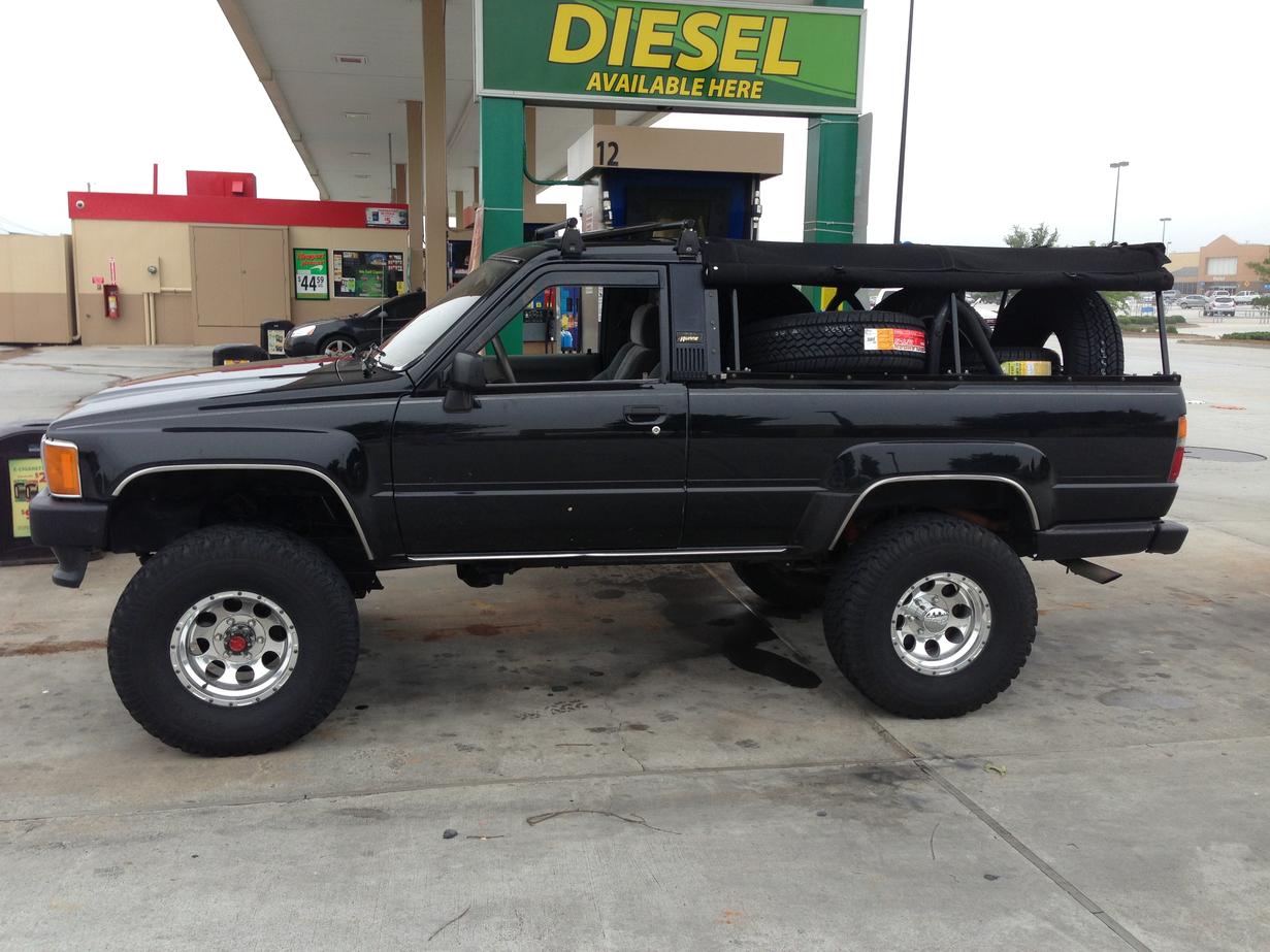

What I run
Gonna let one of the second gen guys handle this, Brad - I don't know for sure.
OME 890's give 3" lift to the rear if you carry gear it will level out to 2.5. You can run coil spacers in the front 2.5 and be just fine. I wouldn't go more because of the CV angle would be to great.
