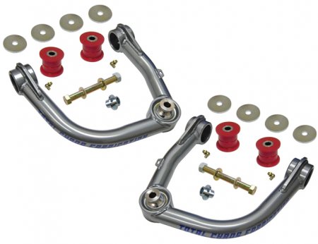

Awesome, if it can handle a canadian winter then I think it can handle my joke of a winter compared to yours. I guess once I have some time, I will install the following unofficial SPC product update:
Anyone want to buy some lightly used LR UCAs? Might have some available once I remove them, LOL!
Yup, for me taking the LR UCAs out was the best product update. I'm sure they're fine for a lot of people but when you have two failures (ball joints and bushings) so close together in one product you kind of lose all faith in it.
Mine went in the garbage. Could not sell them to someone in good conscience.

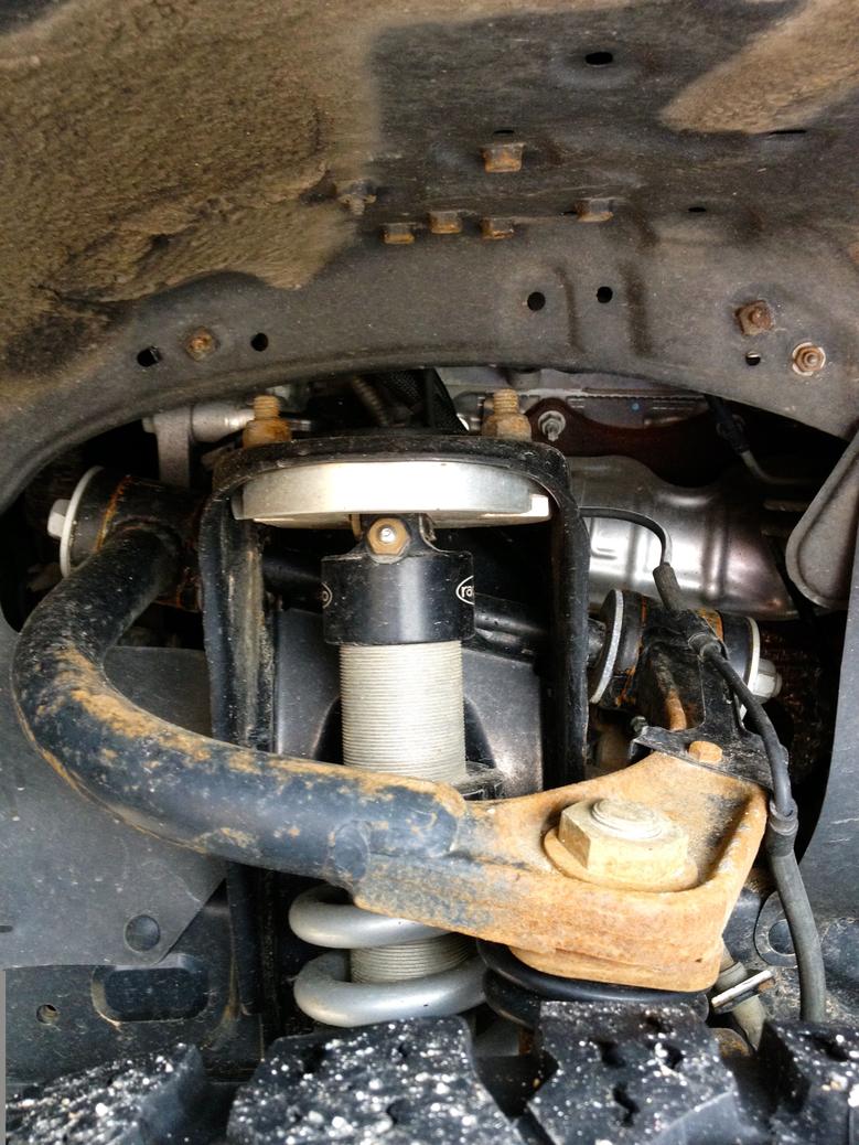

[MENTION=99235]Scott@Hightech[/MENTION] and others. Please excuse the rust. They need some cleaning. So It appears I have version #2. I had replaced the rubber bushings last year with the Poly's. Seeing this doesn't make me feel good. If it's such a safety hazard, SPC should supply us with the new kit at no cost. Similar to recalls. It would be nice. Take a look and see if mine is the version 2 set up, in which case I'll need the new kit. This will be the second time around having to "rebuild" these UCA's. I think I need to go in a new direction.
Yes, you need the update kit. It is free, and they did send out notices, however they sent the notices out to their vendors, which may or may not have records of what each customer purchased
Oh great! So I can just call them up and they'll ship it? Good customer service. Actually they replaced my bushings free of charge as well.
