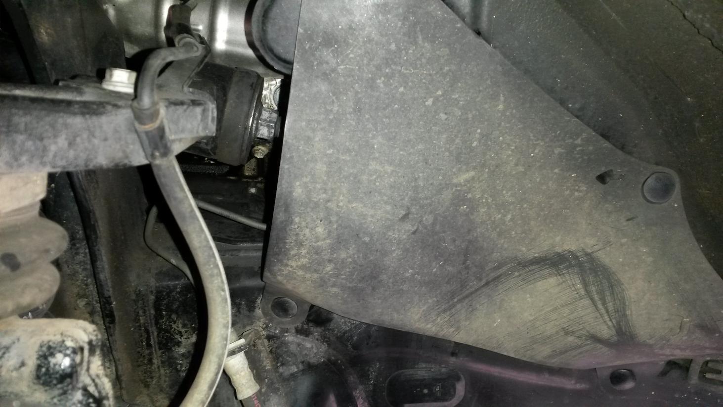

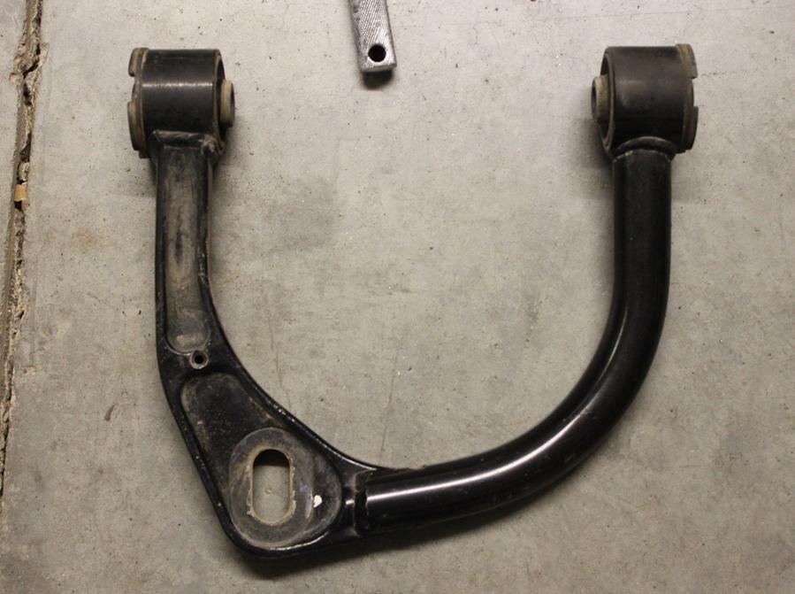

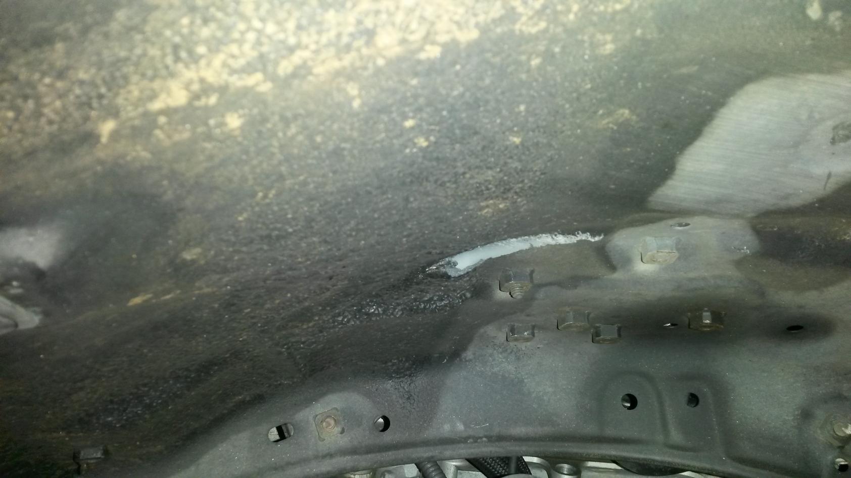

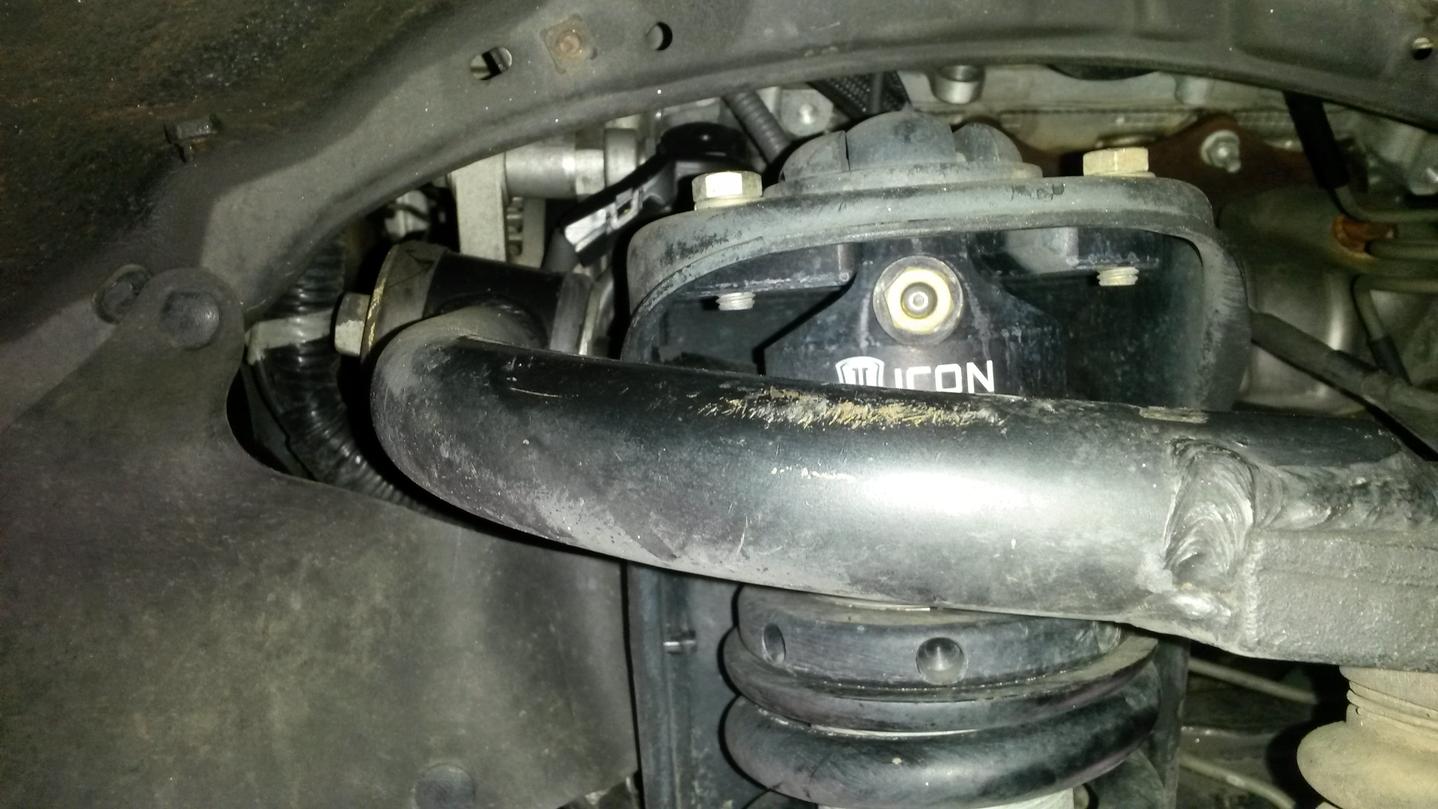

Can you verify from these pics what spc version i have? I installed these in spring of 12 sometime.
I have experience the driver side nut loosen to finger movable once. It had been making noises for awhile before i discovered the loose nut.
These pictures were taken last July after about a 1,500 mile round trip to silver lake sand dunes. Front suspension bottomed out unexpectdly once when i went too fast through dunes. You can see in the pics that the UCA hit the upper fender and also see where the tire rubbed. The scRatches on UCA where it looks like brass is exposed is where it hit the fender.

I'm not exactly sure what version, but I can tell you it is an old version. You should call SPC up and get the newest bushing hardware. The version you have consists of the large washers sandwiching the bushing. This caused issues because it did not allow enough bushing movement, which caused the welds to fail.
Do yourself a favor and inspect the welds on your UCA's at the pivot points. A friend of mine had one of the welds break completely due to these washers. Luckily the UCA stayed in place by gravity but it could have been bad.

Ouch, must've been a hard hit. I've hit the fender well a couple times when I was running some worn out 5100's. You may want to look into some Wheeler's Superbumps to help with that.

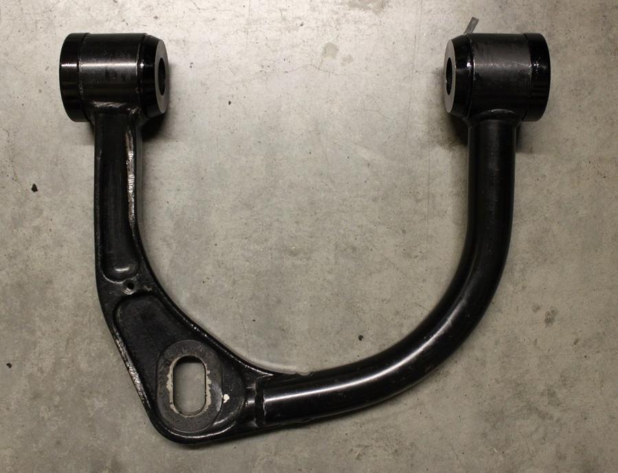

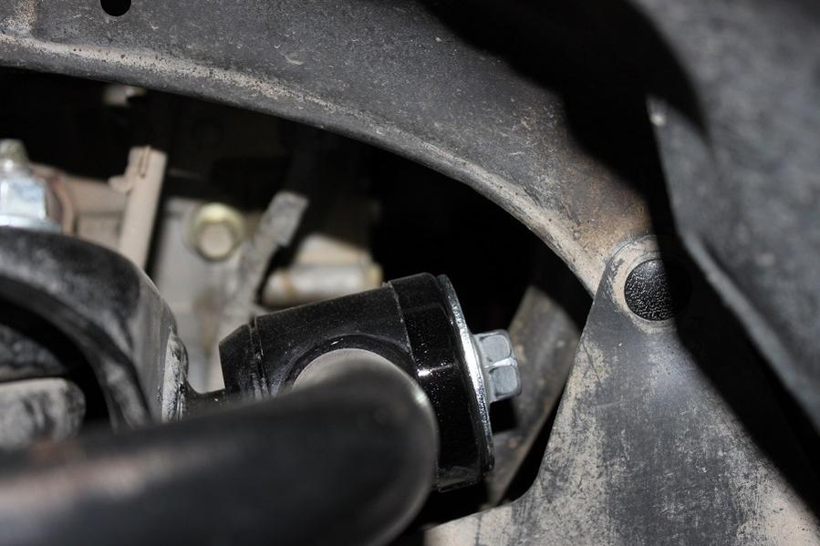

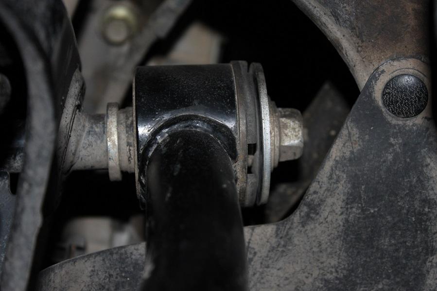

Just thought I would drop a couple pics here.
I just replaced the SPC bushings on my UCA's with the SpecRide bushings.
I had the original 1st version.
Pic 1,2...original rubber bushing.
Pic 3,4...SpecRide bushings.

So, are the light racing ones different from the ones SPC has now? I have some SPC UCA on my 4R, but mine are more of a flat design than the ones in these pics.
