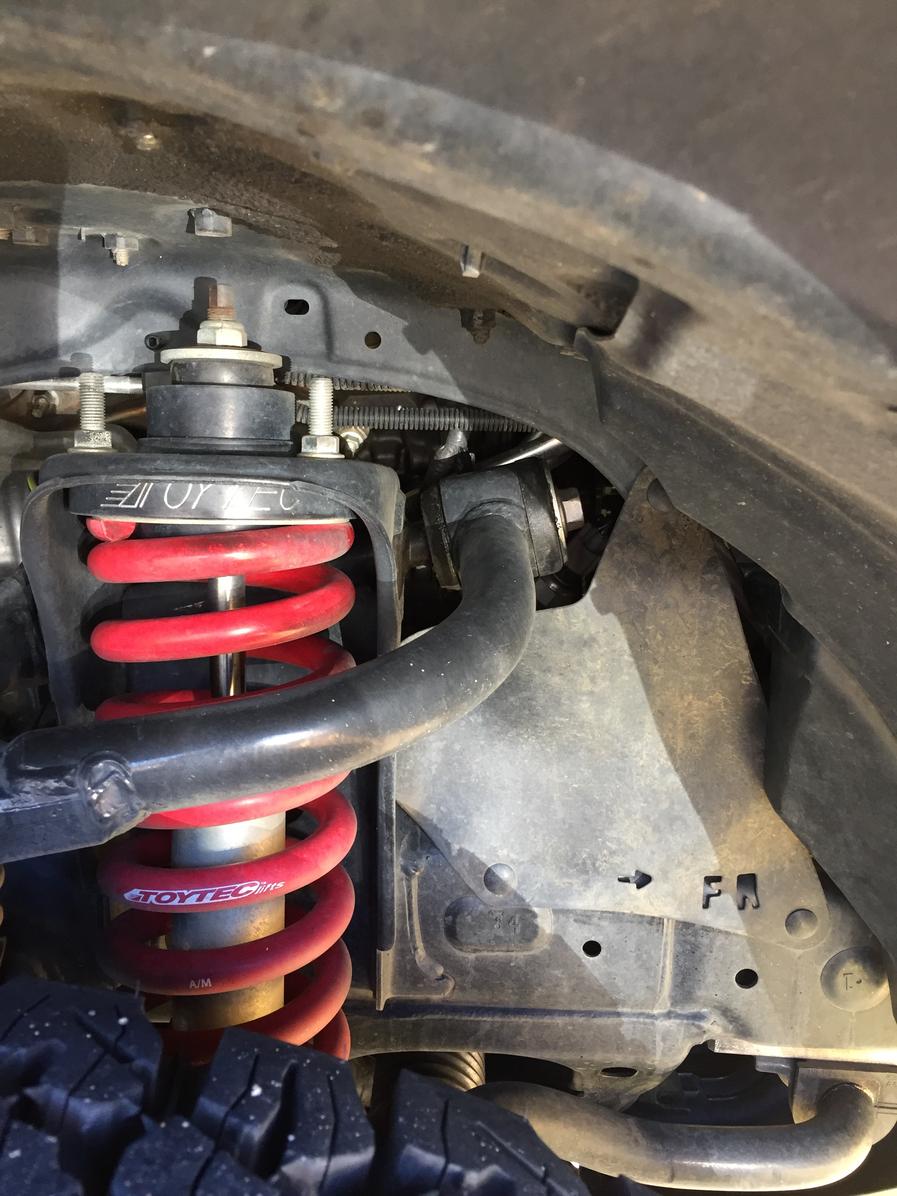

So which version do I have? Still confused after reading this whole post. Haha. I've got some form of sweaking going on that sounds like it from the front end. I found this thread in my searching.
THAT looks like the newest version. make sure the bushings are well lubed as well as the ball joint, make sure there is no play anywhere too.
Looking at your picture id say your good to go. You have the newest bushings, the style with the angled end toward the center. And it looks like grease is on them too. Just recheck the torque on them after a few hundred miles then enjoy.
As far as you squeaking goes. Make sure they are torqued down right to the proper specs. Also check your lower control arm bolts. Mine were making a noise after the alignment and weren't torqued properly. Tightened them up and it stopped.
