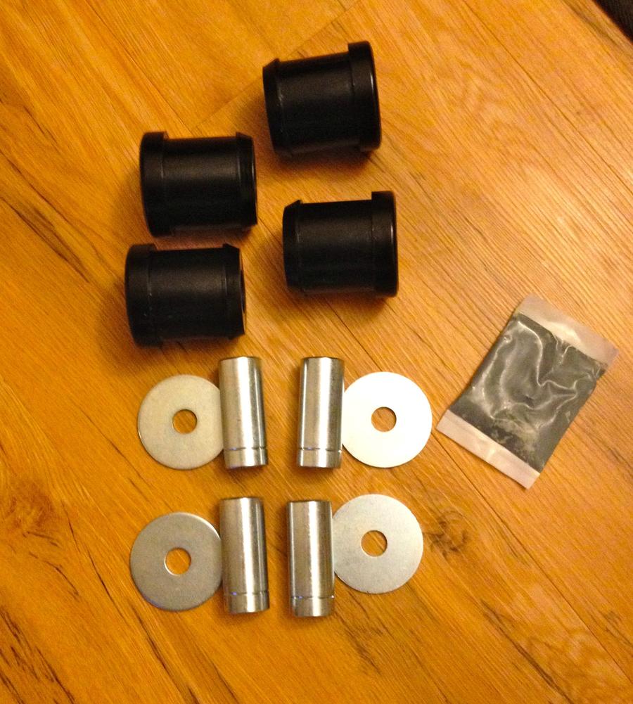

Guys and [MENTION=99235]Scott@Hightech[/MENTION]. Just received my rebuild kit. It looks exactly like what I received before the winter when I replaced the old bushings with the new bushings. I'm wondering if I am ok. I know I read that we are only to use one washer on each side now with the new kit but could I just remove the washer with what I have on there already? Probably not? I'll probably just replace it all again.

That is the correct kit. the update came out last summer, so you should have recieved the update kit then. but those 4 washers only go on the outside, you will not reuse any parts from the old bushings aside from the bolt and nut. the sleeves are longer to take up the room on the inside.
I did get the correct upgrade kit months back then. I'm now thinking the shop that replaced them still used the extra washers to total four on both sides.

Just looked and mine only came with two washers per side and my sleeve don't have the ring around them like the ones above. I did have the spec ride bushings that have the diamond shaped nubs on the interior of the bushings though.
Don't worry about the little ring grooves in the sleeves, just make sure that the sleeve is long enough to stick out past the inner face of the bushing when it's all torqued down. The sleeve should stick out past the bushing surface by about the thickness of one washer.
