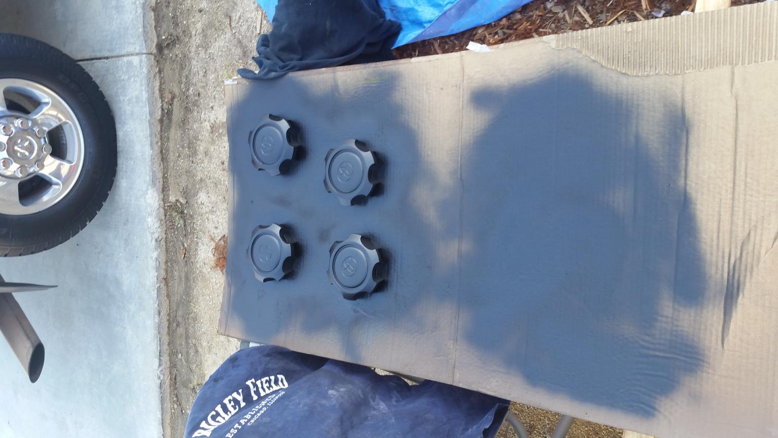

Dont use acetone on plastic. It for cleaning metal I put those same caps in the dishwasher & they came out clean. Then 2 light coats of plastic primer.

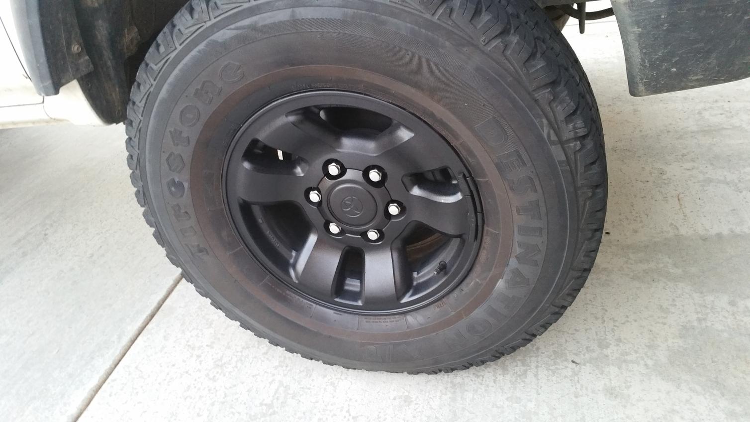

So not painted, they are powdercoated, but i was pretty proud of them, and thought it was worth posting them up. I used eastwood flat black. The whole process wasn't too bad other than trying to find someone that had a sand blaster to prep them with.

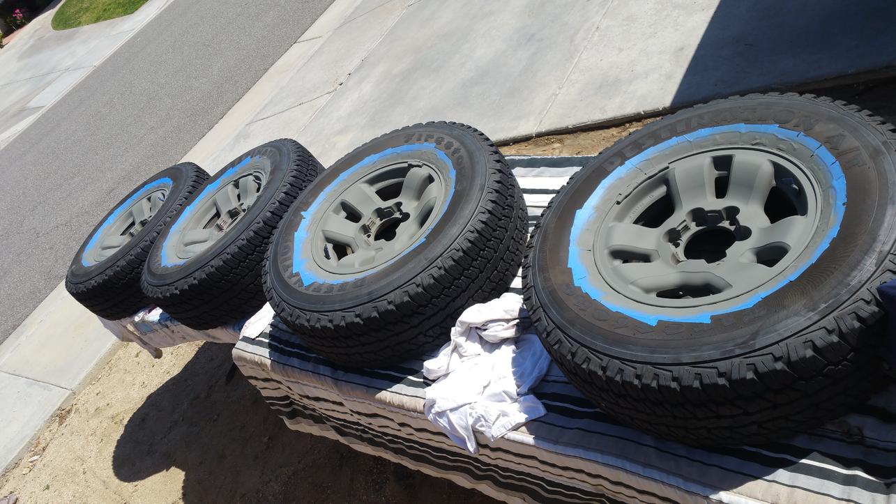

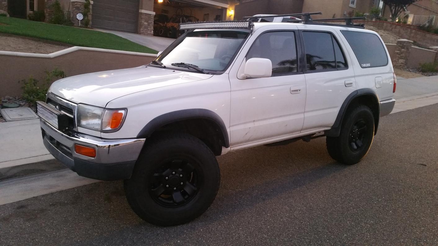

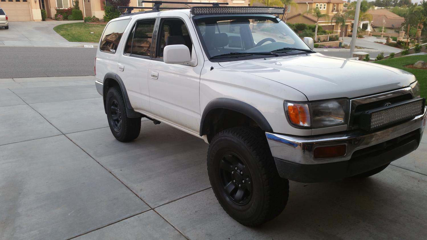

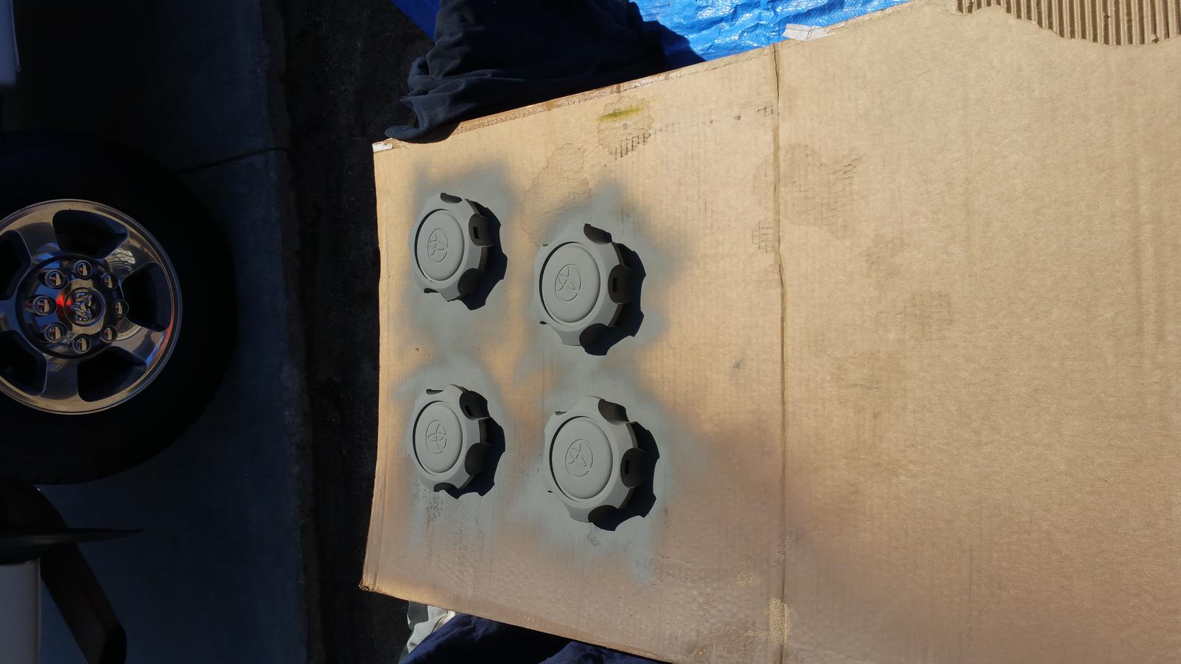

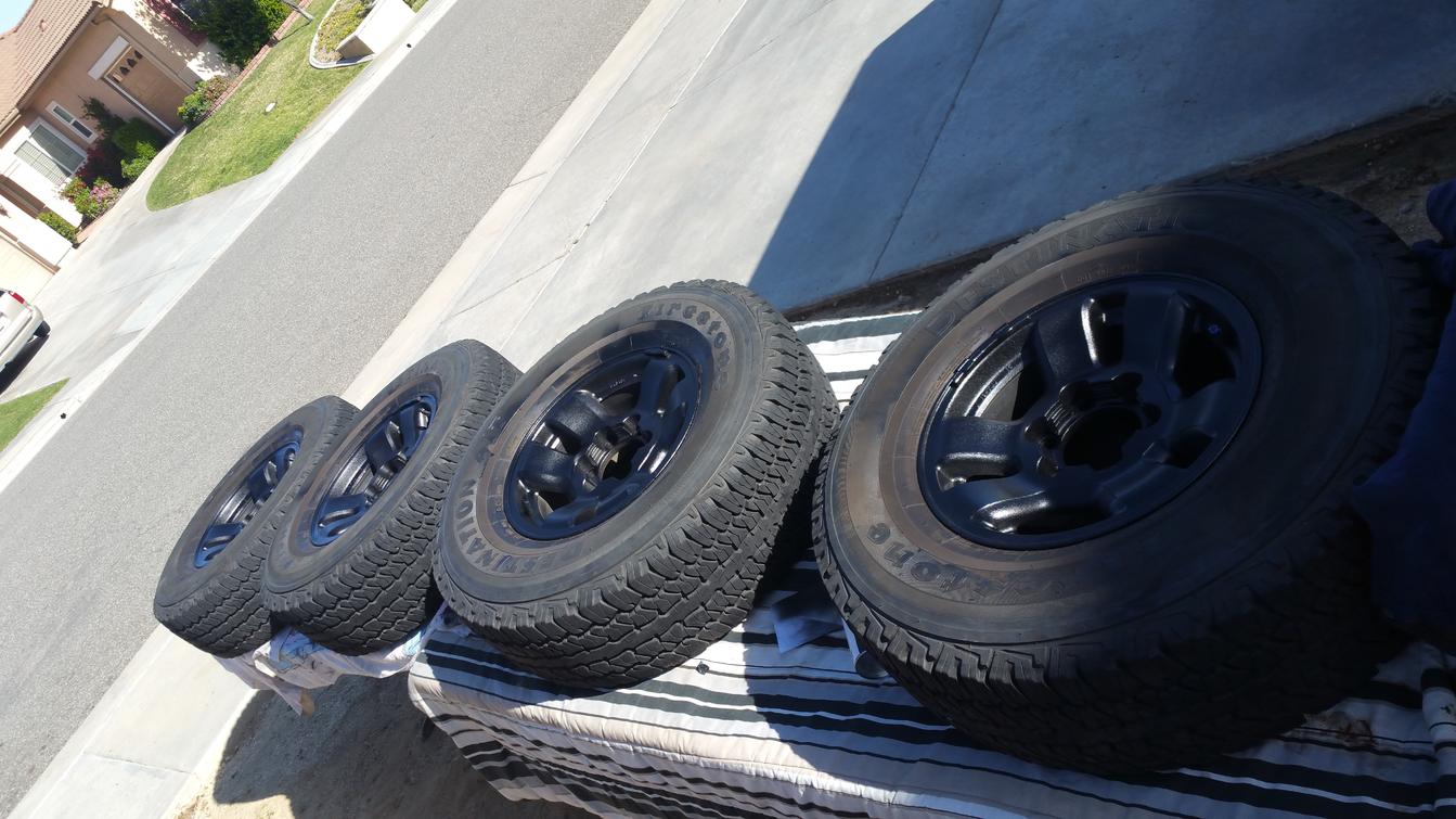

Rustoleum truck bed coating

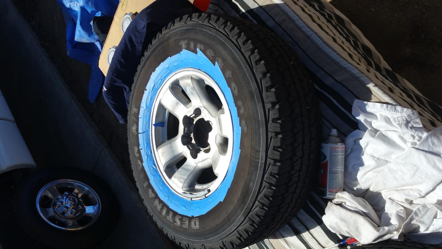

I Used Rustoleum self etching primer and Rustoleum Truck Bed Coatin turned out pretty damn good. Going to do the fender flares and bumpers when I have more time off from work. Totally changed the look of my 4runner with just the rims being painted

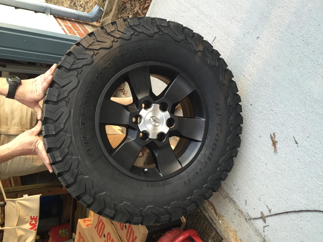

These are the wheels I did on my 05 Tacoma Sport

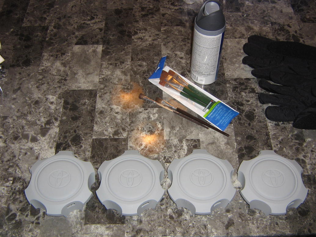

I've never used it. One can of plastic primer is $4 in Lowes or Home Depot.
I assume you have adhesion promoter laying around.
It was recommended by another member when I repainted my center caps, so yeah, I've got a half a can burning a hole on a shelf LOL
LOL I do the same thing with spray paint. I use what laying around on a new project. Otherwise I'd have 50 half cans on the shelves.
