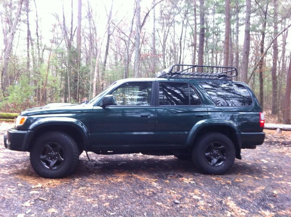

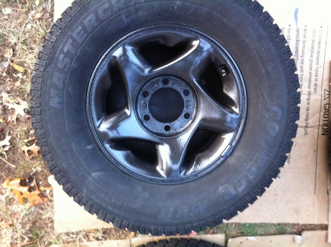

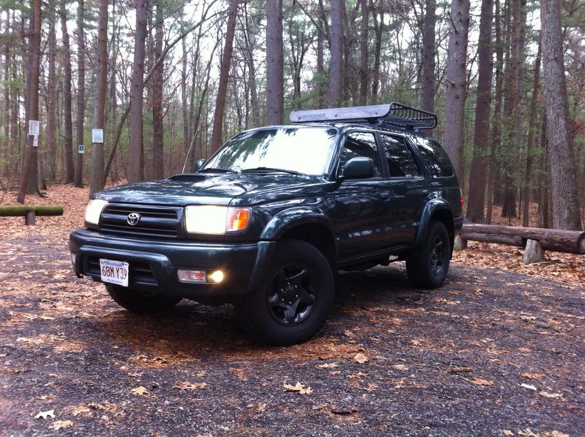

Here are the 2002 Tacoma rims with Rustoleum Hammered Metal...
on 2000 4runner Imperial Jade Mica:
The money shot:

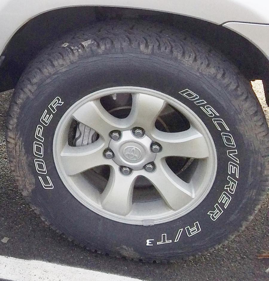

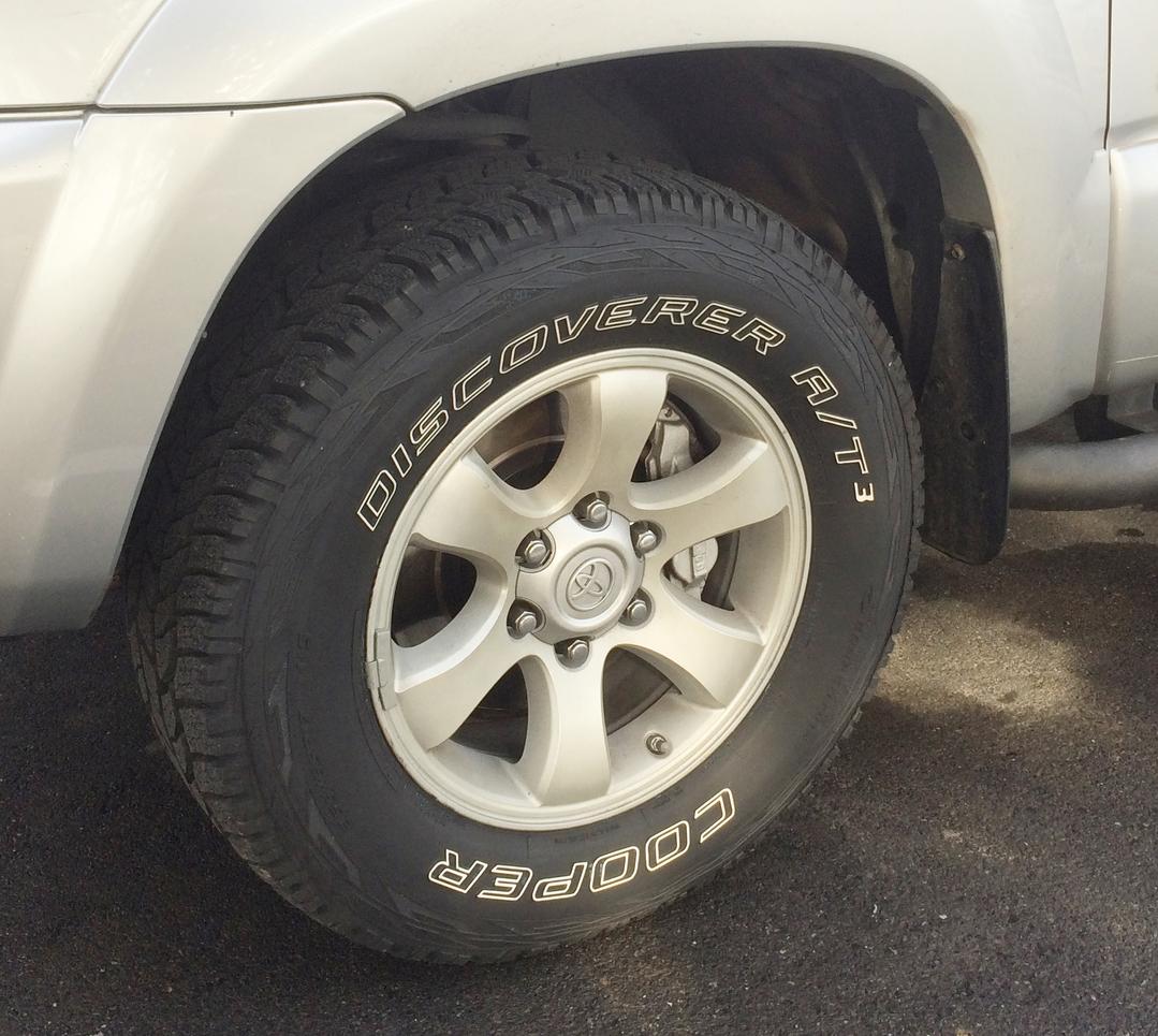

I'm just curious what technique people are using to highlight the Toyota emblem on their center caps? I see lots of black and red.
Im planning on painting my factory TE wheels soon and was wondering if there is any lessons learned from any of you that have been running painted wheels for a while now?

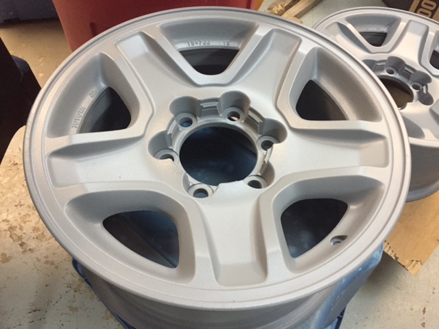

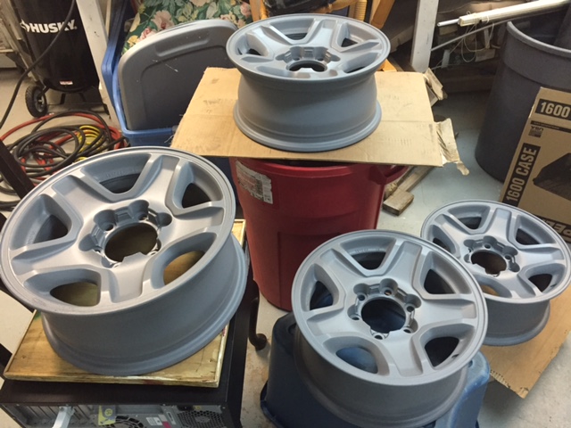

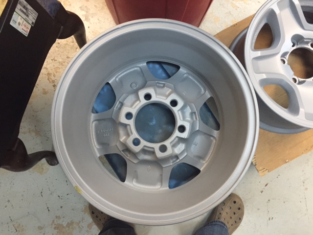

So the hammered metal has held up very well but in the mean time I attempted to sand down my stockers. They were pretty far gone (esp from the PO). Anyhow, found a sandblast service who blasted and primed for $30 a wheel. Couldn't beat it and they did a fantastic job tho Im not sure if I really wanted them to prime the outside diameter. I'll wait til temps hit 70 here in NE and hit them with rattle can.
Teaser pics...

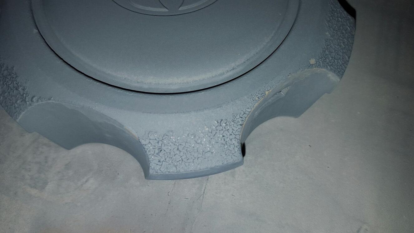

Guys, I'm having issues with the paint on my hub caps. I have cleaned the caps with soap and water. I wet sanded after that. Then I cleaned the caps with acetone. The primer keeps cracking on the caps. Any ideas on what I'm doing wrong? I'm using krylon max primer. Could it be the primer? I took this cap and sanded down the cap again and repeated the steps above with the same results. I will try and attach a pic.:shrug:
