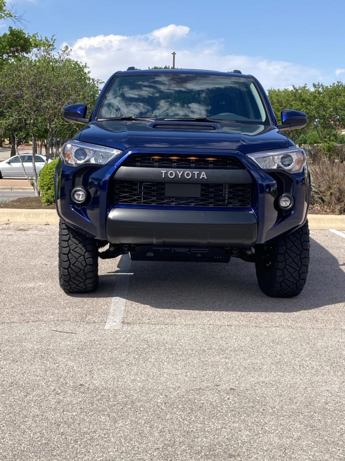

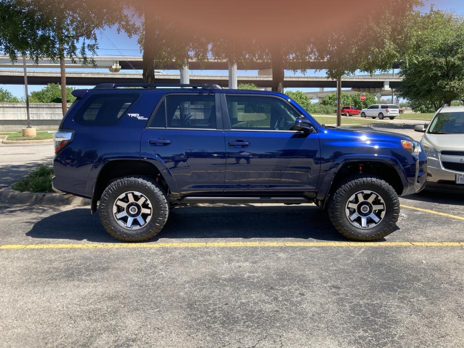

Pictured is a TRD Off Road with Toytec suspension , Nitto Ridge Grappler tires and added the TRD Pro grill. If you plan on changing out significant components of the TRD Pro save your upgrade cost and invest it in the aftermarket upgrades. Purely my opinion.
