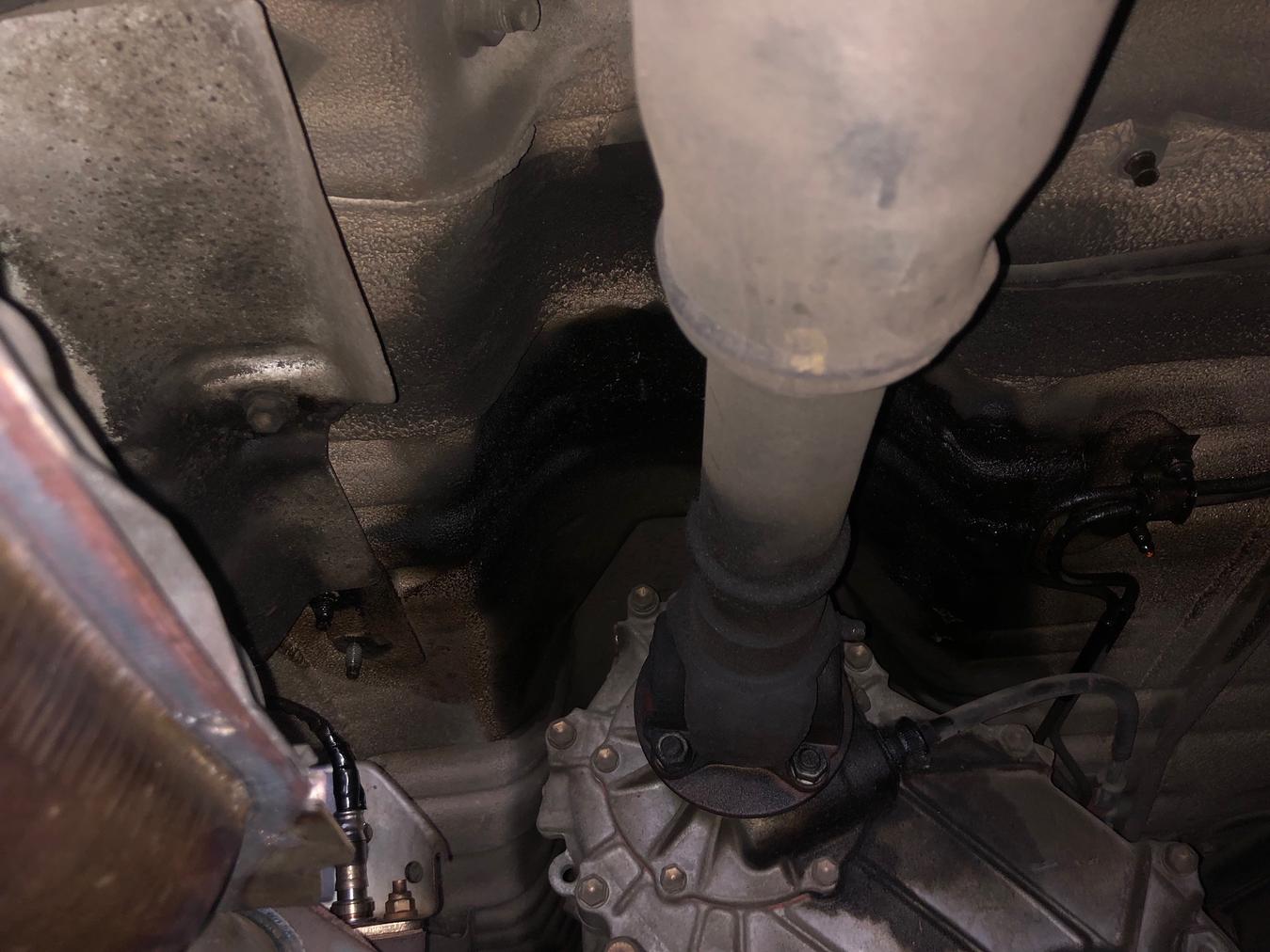

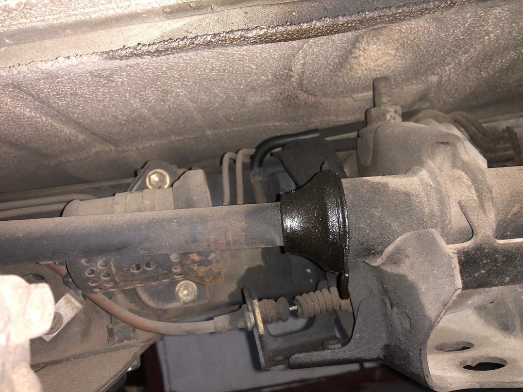

Hi everyone,
Just noticed this oil underneath the truck. Can't really determine where it is coming from. There is oil on the torsion bar too. You can see where it is dripping off the bolts. The driver side is dripping onto the exhaust. Any ideas?

From the looks of where the oil is spreading;
1) Most likely +1 to all of the above, OR
2) Just excess grease oozing out of the U-joint and drive shaft telescoping thingy (This was the case on mine when I bought the truck).
O.P.,
It would be good practice, before taking things apart to:
1) Check your gear oil level, and
2) Inspect and clean the around the output shaft/seal and observe it for a couple of weeks.
