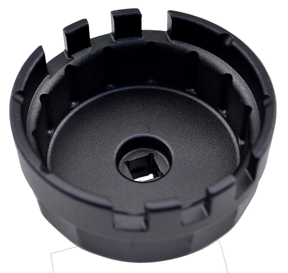

You have to get a filter wrench that looks like the attached photo. The standard old style wrenches are almost useless.
From an engineering standpoint, filter elements are a superior solution. They offer much higher oil flow and more surface area to filter with.
Hope this helps you in your next oil change.
