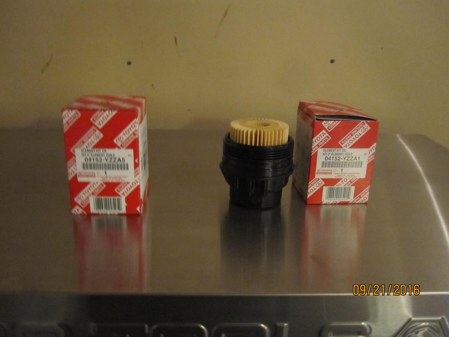

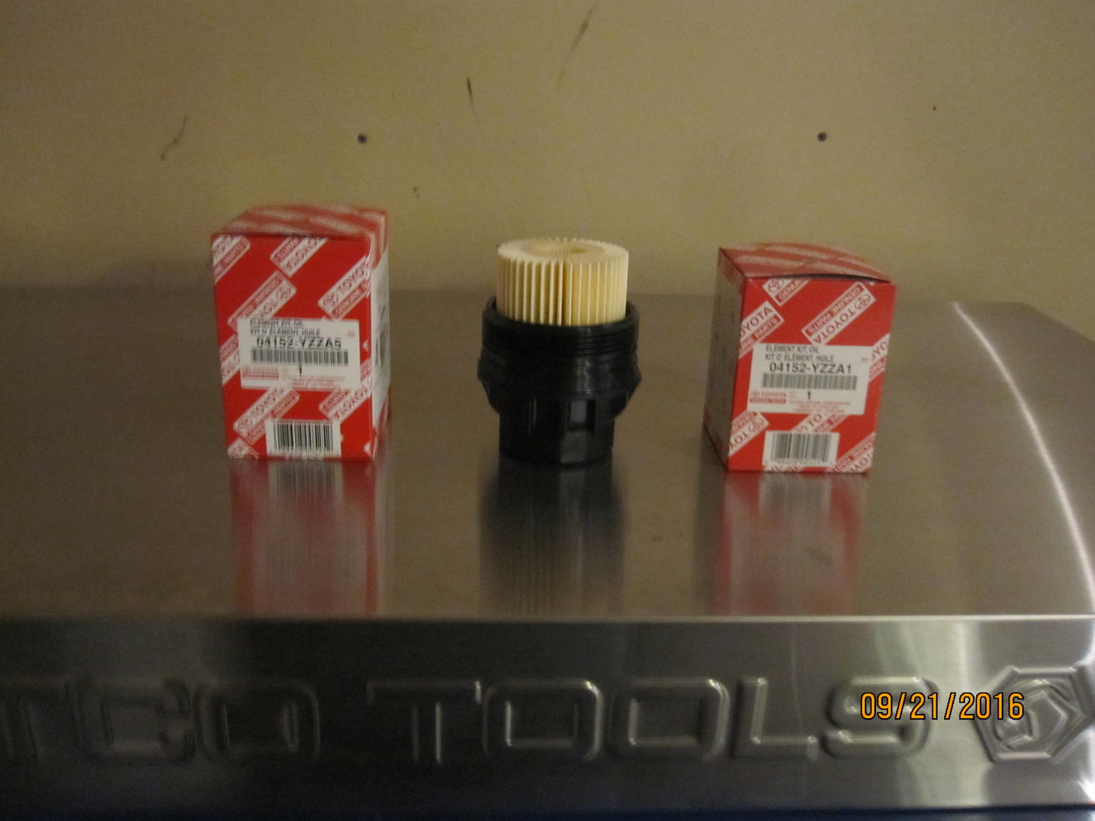

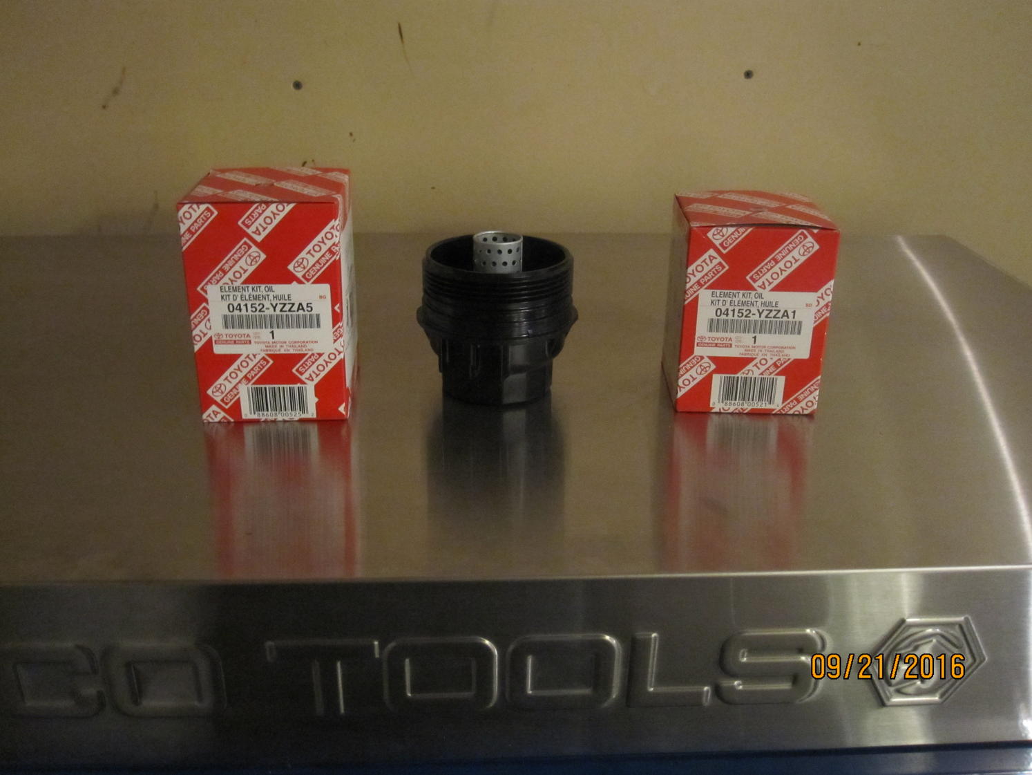

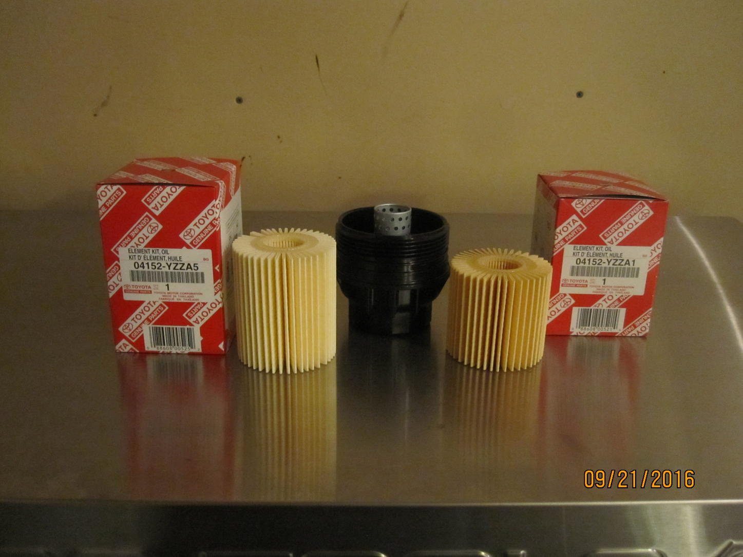

There is a huge difference between oil filter housing for 3.5L (same as filter housing for 2.5L I-4) and 4.0L Toyota V-6 engines. 3.5L/2.5L filter is substantially shorter compared to 4.0L filter. I would not mess with getting a 3.5L housing for the sake of having a metal housing. Too much or little oil pressure is not good and may impact the longevity for that particular engine. I am not going to pretend that I know more than the Toyota engineers who purposely selected different filter housing for 4.0L engines. It is much cheaper for Toyota to go with one-size filter housing instead of having different housings for various engine sizes.

The plastic cap, while well designed for what it is, will not have the service life length of the aluminum unit. Even with careful and proper removal, heat and pressure will eventually take their toll, and the piece will begin to fail.
The cap material will not cause any issues with oil pressure. Swap the the tube with bypass and all works as intended.

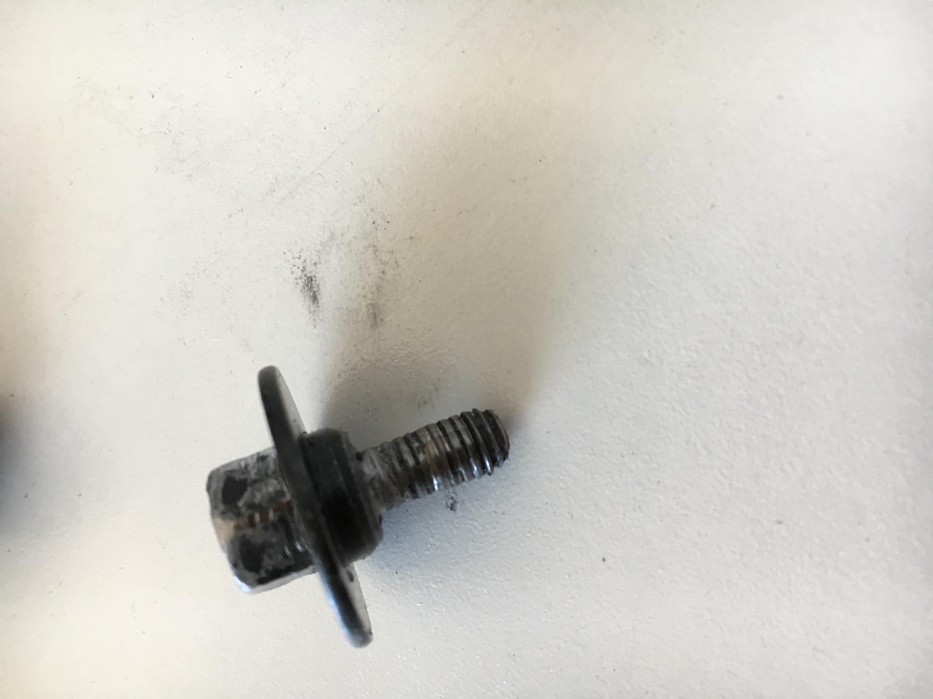

I changed my oil again yesterday and ended up with a stripped bolt; one that fastens the plastic cover to the swing down skid plate. Luckily it was the screw and not the nut.
I bought a few replacements for both skid plates a few years ago, when the dealer lost one and stripped another for me.
Anyway, it is a good reminder to chase the threads on both the nuts and the screws on these as they can take a lot of abuse during r&r. Anti seize can actually make it easier to strip one when installing, (even if you think you are being careful:)). Threads are 6mm.
