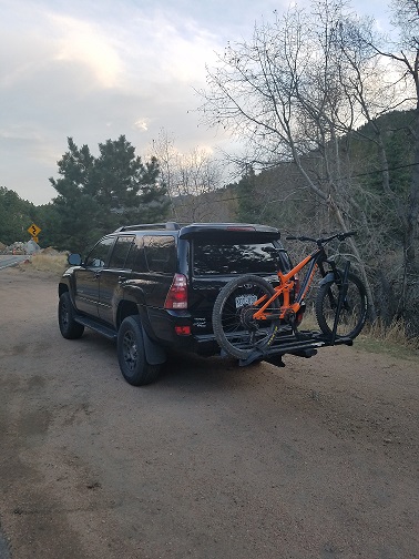

This is my 05 V8 with the 884/895e setup and "trim packer" thing.
I went with 90021 shocks in front and 60004s in the rear.
I replaced all the sway bar links with Moog. Did the gen2 sway bar links in the rear and relocated the front as it was just a little close.
Interested to see how it settles.
Loving it so far.

I'm on 885's with 5100s (on "0" setting) and stock UCAs, I'm good but probably right below the cutoff for keeping stock UCAs. And as always every truck is a little different. After the coils settled I'm probably around 2.5-2.75 inches of lift
I have this same setup and that's sounds about identical to mine.
Haven't changed a thing since install. Put on 5-7500 miles since.
Have done a couple trips to Moab and and beyond to go mountain biking. Definitely glad I went with the softer valved OME shocks as ride quality is good. Definitley firmer than stock but not "stiff."
Currently still running stock Dunlops 265/75/17 (I believe). Will be putting on new rubber this winter but will not be doing anything too aggresive (99% of my driving is on road and the other 1% is dirt roads to access trailheads). Thinking about getting Michelin LTX AT's but not sure. Rubs the mud flaps at almost full lock but the rubbing is minor. I'll probably stick with stock tire size.
