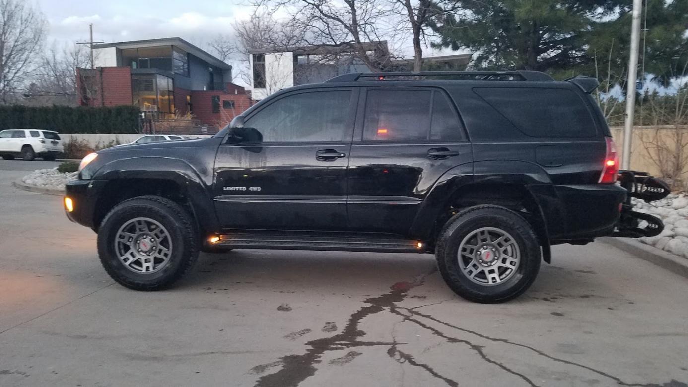

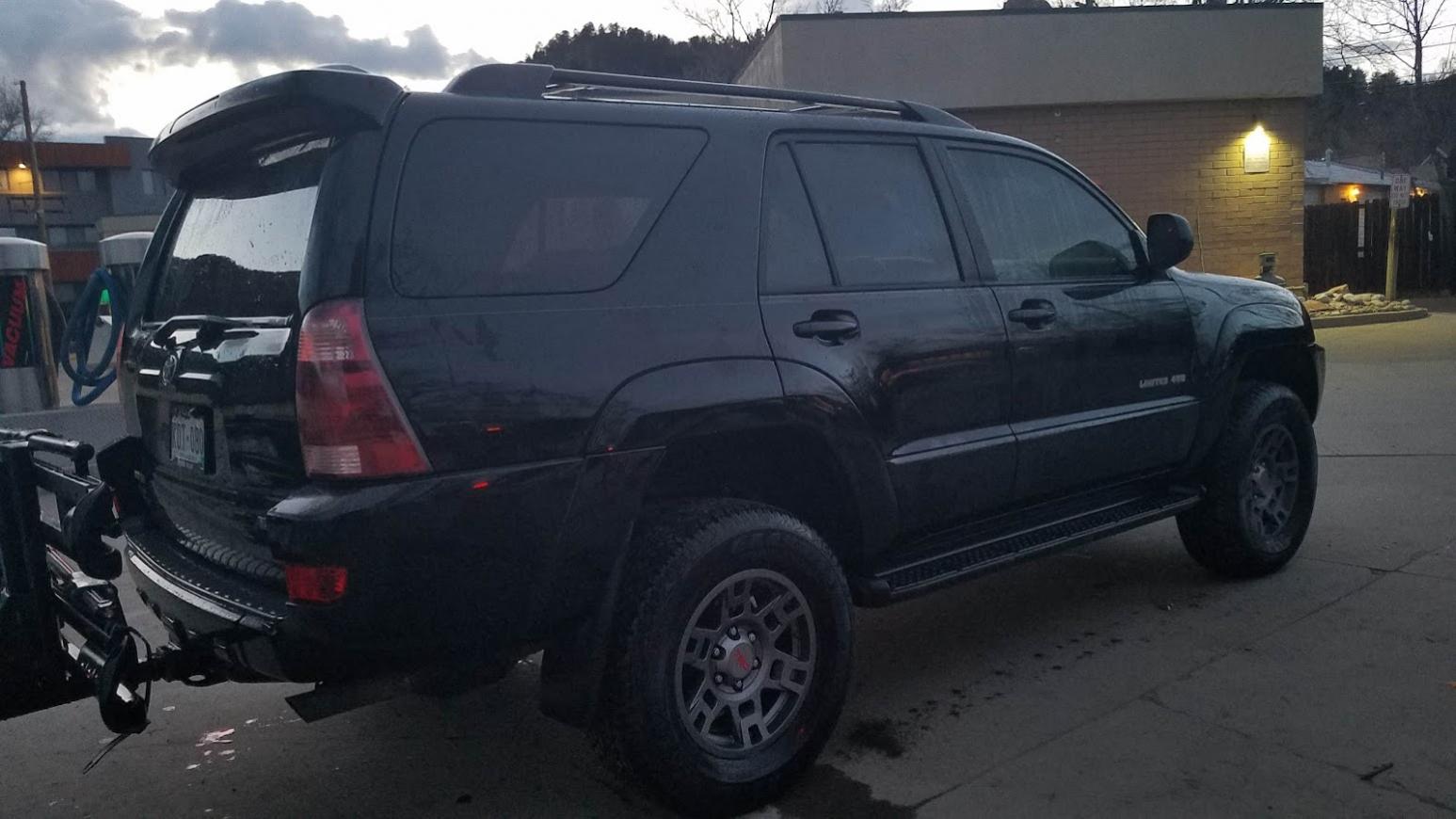

Go with the 895E. The 895 will keep the rear in the stink bug stance.
This photo is with the 895E in the rear and the FJC bilstein and toytec 2.5” spacer lift in front.

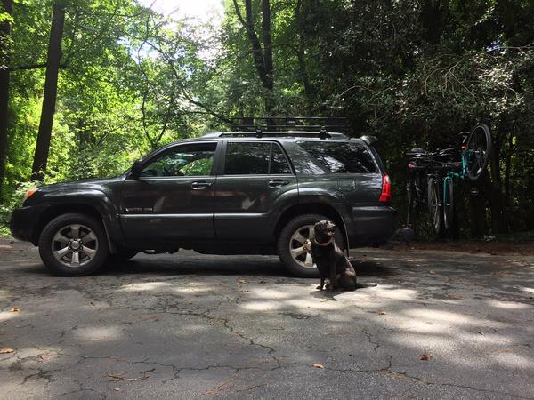

Hey guys,
Just wanted to give an update after getting the lift installed and everything put together.
So I went 885/895 with the midstiff front coils becuase I have a v8 and plan to get a bumper in the fututre, and normal / medium load rear coils. And pics are still with stock sized 273 sized tires.
The lift took care of the front rake, but due to the stiffer front coils, the front is just slightly higher. This extends to the ride quality as it's great overall, but you can feel the front is slightly stiffer and takes bumps better. In the future I plan to swap the rear coils out for the stiffer 895e coils. But overall very happy.
One piece of advice I'd offer is just to match the stiffness front to back unless you like having the rear a little stiffer, which can help for on road driving.
Note: I did add a 1 inch spacer on top of the OME lift because even though it's rated as a 3/2 inch lift, after install it evens out to about 2.5/1.5.
Stock:
After:

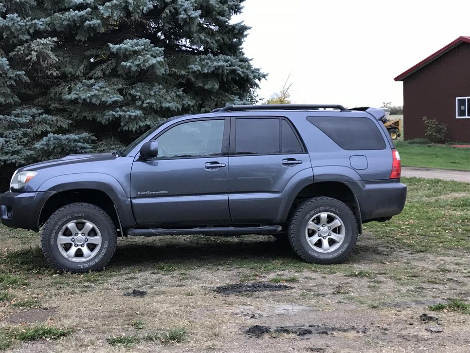

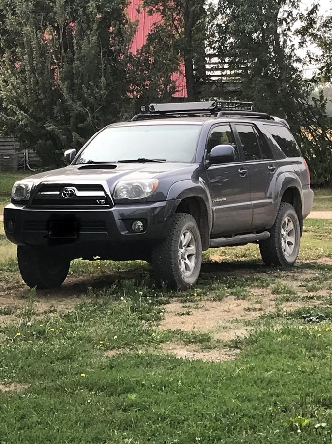

2006/sport V8 w/884/895e
Here is my 2006 Sport V8. It has OME 884/895e with OME nitrocharger shocks all around. I also added the 1/2 in top plate spacer for the front because I didn’t want it to sag from the weight of the V8. This setup has 10,000 miles on it and is completely settled. The tires are 265/70/17.
Side view, 06 sport V8. Front OME 884 with 1/2 in top plate spacer, rear has 895e. OME nitrocharger shocks all around. 10,000 miles on setup, fully settled.
The ride is very good after it settles.

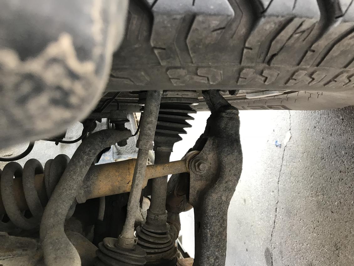

Those CV’s look great, thanks !
GA-V8, by chance do you have any pics of your CV angles, you look a bit higher with the 885’s, which is awesome but I’m concerned about those darn CV’s.
Why'd you go with the 884 on the V8? I'm in the process of doing mine and thought the 885s were recommend for V8? I like the way the 884 looks on yours.

When I was researching, everyone said 885/895. I bought through Toytec, and two of their sales reps told me to go with the 884/895e. I was really surprised to hear that since everyone does the 885/895. Anyhow, I did he math with the sales man and if I added the top 1/2 in top plate spacer to the front 884, there would be essentially no rake at all, perfectly even. Since the v8 is heavy I assumed a little sag after some miles, and I was right, leaving me with 1/2 in lower, or positive rake up front.
Maybe I’ll go higher one day, but that means I’ll have to start looking into after market UCA and other stuff. With this setup I had no issues with alignment and it’s a good look I think.
