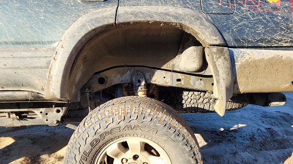

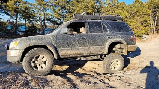

So I run this setup except I'm using the 95 bravada bumpstops with 95 swaybar endlinks. Still with center cones. I flexed the living **** out of my rear and they held in place. I'm pretty sure I was lifting a wheel as I could not drive forward anymore. The LC shocks don't even come close to compressing fully. I estimate another 2.5-3 inches but I doubt our trucks could make use of that, especially with the extended bumpstops. I am having an issue with the DS hitting the gas tank skid though but I don't have any panhard correction installed. However to answer your question my springs stay in place even while full flexing while on the move.
Pictures of full flex for me(at least with swaybars and bumpstops) below. I have 265/75s

BTW that is one CLEAN undercarriage!
