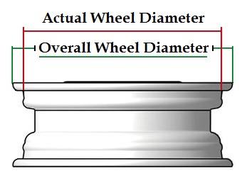

To the tire comment. HUB to fender excludes the tire there brochacho. I can only give people top of rim to fender due to the "dish" of my wheels I cant locate center really well (just add 1/2 wheel dimension).
Sure you can. Measure your overall rim diameter, lip to lip. Then measure from the bottom lip closest to the ground up to your fender edge, and remove half of your specific rim diameter, and you have a perfect hub to center measurement, excluding wheel and tire size.
It's easier for people to do this and get a more exactly hub to fender measurement, since almost everyone's aftermarket wheels and tires are dished inwards and the center of the hub isn't easy to find.
Plus, people get picky and fussy so easily over 1/4" of lean, so who is to say it was measured equally to start with?
