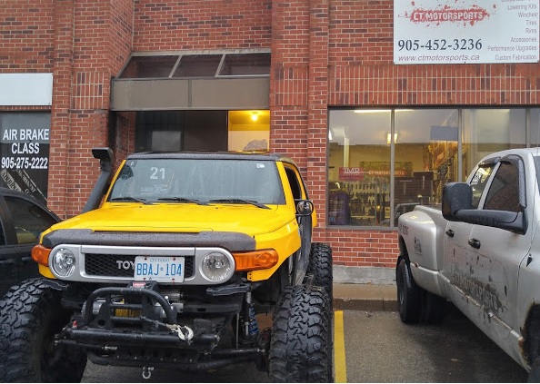

Good to hear there's a local shop familiar with the problem. Would you be able to share their name/number, as my 2017 has the same problem. Dealer already replaced the front needle bearing once, but it only lasted a year before the noise came back.
Well its going to get warm out soon so it should go away! :roll::roll:
Sounds like you might want to consider the same option then. CT Motorsports, across from the Airport at 7050 Bramalea Rd. Typically best to drop by when you're in the area and speak to 'Ski', owner, I typically see him very busy & getting to the phone is a challenge ! Cheers...

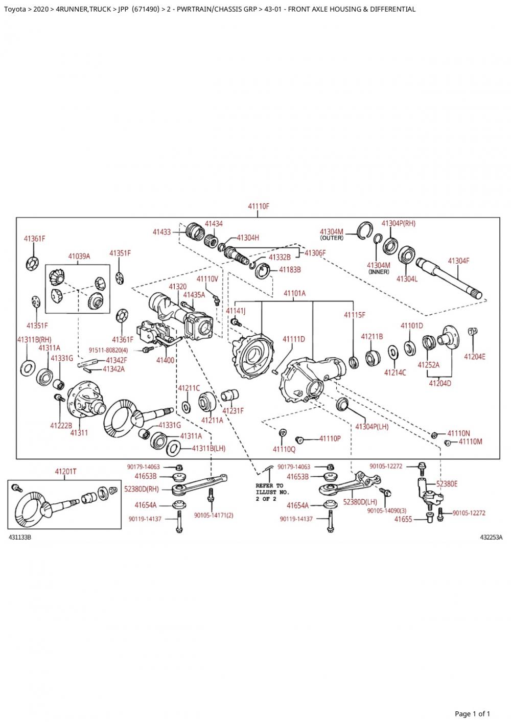

This diagram from the parts department shows a needle bearing on each CV (passenger and drive), but I was under the impression only the drivers side had a needle bearing. The needle bearings are call-out 41331G. If this diagram is right, then each side has one?

As far as the bearings being on both sides - yes, they are on each side of the carrier, however on the passenger side, the CV doesn't go into the carrier. There is an intermediate shaft (41304F) that runs from the carrier through the tube (part 41320) and that shaft is supported on the other side by another bearing (part 41304L), so it is near enough to perfectly straight with no side loading of any kind.
