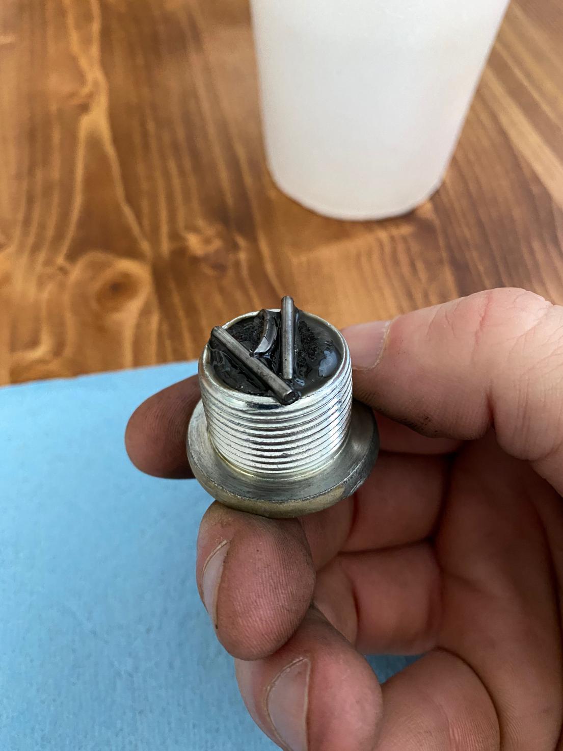

I bought a new 2020 4Runner last year, and as soon as we drove it off the lot it started making a groaning drive line noise which ended up being the infamous front diff needle bearing. The entire front diff and CV axle was replaced.
Well the symptoms started showing up again. I removed the front diff magnetic drain plug and found pieces of that needle bearing stuck to it. Jeez....
The vehicle is scheduled to go in this Friday. I installed a 1.5" lift on it, so I'm hoping they don't deny warranty because of that. Tires are stock size. I want them to replace the drivers side CV and front diff again. If they do then I will be on my third front differential. Seems excessive for a 2020.
I have the ECGS bushing, but I'm hesitant to install under factory warranty.

Yikes I had a new diff put in last February and it’s gone bad again as well on my 17. I’m doing the ECGS bushing this weekend because I see no point in replacing the diff again. But I am concerned with the pieces in there. My 4runner has been driving kind of funny and feels loose, I wonder if yours did this too?
The shop that did the previous replacement looks to have screwed up the install pretty badly. I hope all of the loose bits made it down to the magnet without making their way through any spinning bits.
As far as I know, Toyota has not yet actually fixed the issue, and probably won't. Once the shop fixes their mistakes, install the ECGS bushing to permanently fix the problem

Supposedly, that area of the front differential was redesigned to solve the problem in the 2020 models, and older vehicles were supposed to get a new differential with the redesign, not just replace the bearing and seals.
If you have pieces of the old bearing on your magnetic plug, obviously you did not get a brand new differential, which means the replacement shop did not follow the TSB instructions.

If you search for front diff grinding and any model Toyota with the 8" clamshell front diff, you'll find reports of the noise. It usually isn't noticeable until you change the angle of the axle by changing ride height (lifting).
It really isn't a failure as it generally only manifests with modification from stock, and it's not like it's going to stop working or cause damage, it's just noisey.
If you search youtube for ECGS bushing, there is a technical explanation from ECGS on exactly what the problem is, why, and how their bushing corrects it.
Just put in the ECGS bushing; you don't / didn't need a whole new front diff. Hell, you already got the bushing so what are you doing effing around with the factory part again and again?
It's not an uncommon issue; I have had 2 (of 4) 4Runners that we've owned do it since 2015. In fact, I just had the ECGS bushing installed in my 2019 ORP a week ago due to an onset of the cyclical groaning noise / vibes a few months and few thousand miles ago.
I wouldn't even worry about the piece of bearing on the drain plug. Looks like everything did its job and caught that little bastard. I can't imagine there's diff damage.

They've known about it for coming up on 20 years. For the vast majority of buyers, it is not an issue, for the few that it is, they can throw down a few hundred for a new diff housing and bearing.
Usually the problem only manifests after adding a lift, at which point the dealers usually tell you to bugger off because it is caused by the lift. Not really true, but it usually isn't a problem at stock ride height.
You are now in an unfortunate situation where the dealer trying trying to fix the issue has possibly damaged your front diff. I would get them to fix it, then install the bushing and be done with it.
